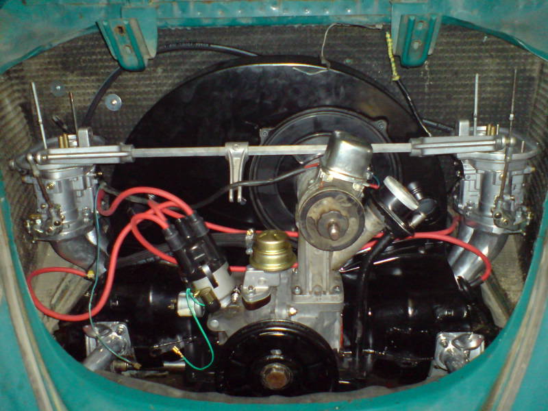

That's mine, half-completed.

Hehe, simply - no, that won't work :)
The fan housing blows air down over the cylinders at quite a strong rate, and the shroud covers help duct the air where it should go. I've got extra ones on the bottom of the cylinders as well, to add that extra bit of air time when it's blowing through.
Without the fan housing you'd be in trouble quite quick.
Those with special needs go for the Porsche style cooler, which blows even more air:
As for you theory of removing the shrouds, that's not really wise as you'd then be reducing the time the airflow goes through the fins.
Without the fan or shrouds, the simple passive cooling of surface/air would not be sufficient for more than a few minutes of running.
