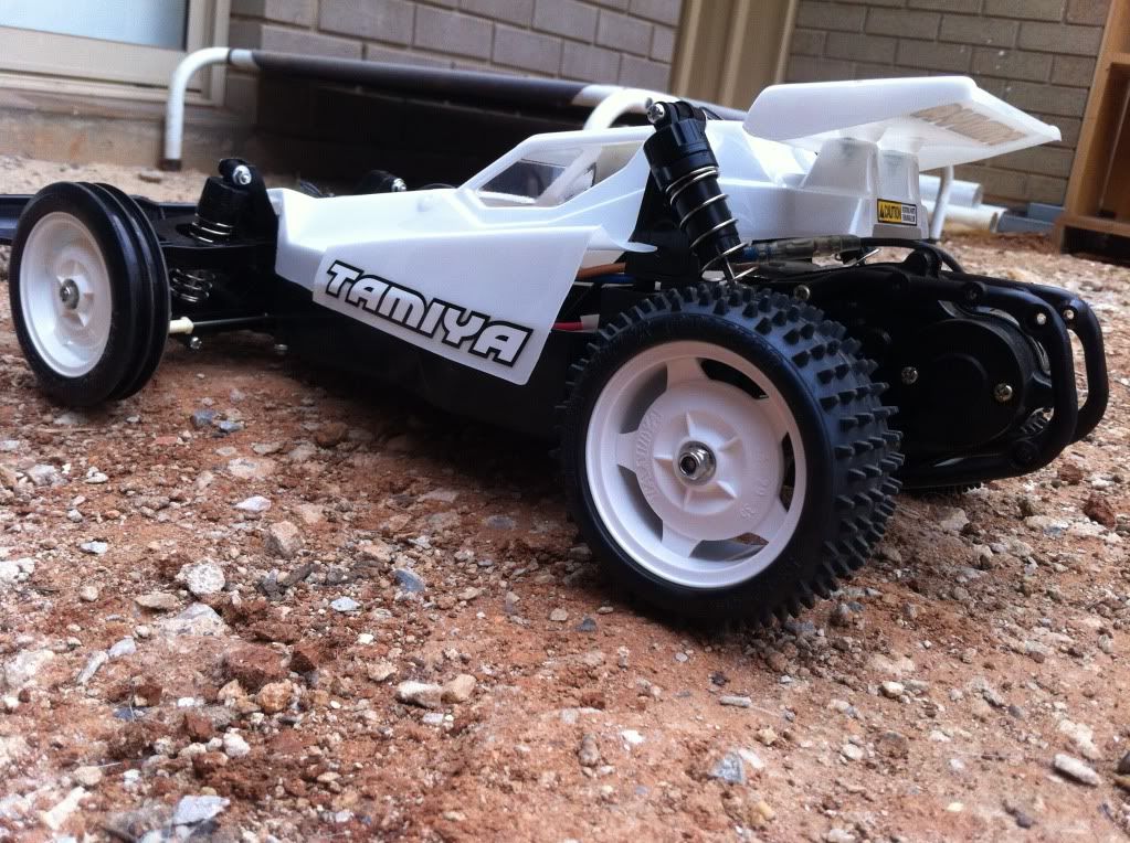

This thread needs pictures :)
Like this :)
I have always liked the Falcon and it took me 20 odd years to get one as it was one kit I wanted as a kid.
