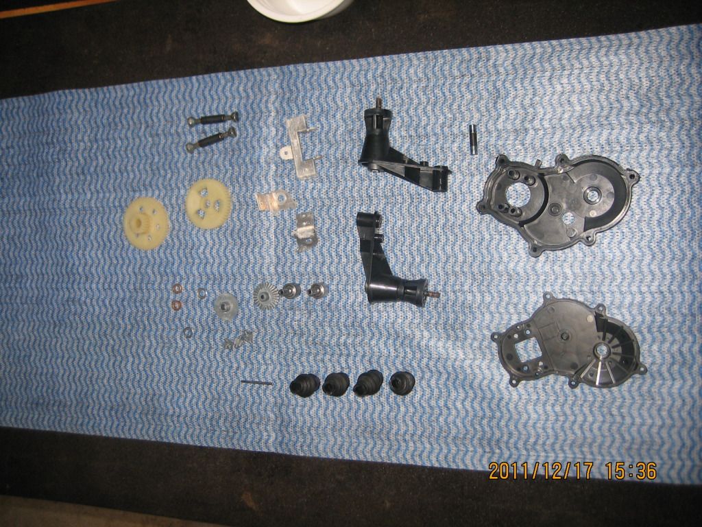

Have started on my Wild One project, and early on I seem to have hit a stumbling block and am hoping someone can help. I've stripped and cleaned the gearcase (luckily it appears an alloy pinion hasn't been used much, gears are in very good condition), and whilst cleaning/decreasing all the parts, I appear to have lost the differential spacer (page 7 of the manual). Can anyone tell me exactly what this part is, and is there anything I can use in its place?

Thanks both matman and Capt Splatt, great info, rebuilt the gearbox with the 850 bush in there and it fits together very well, here's some progress:

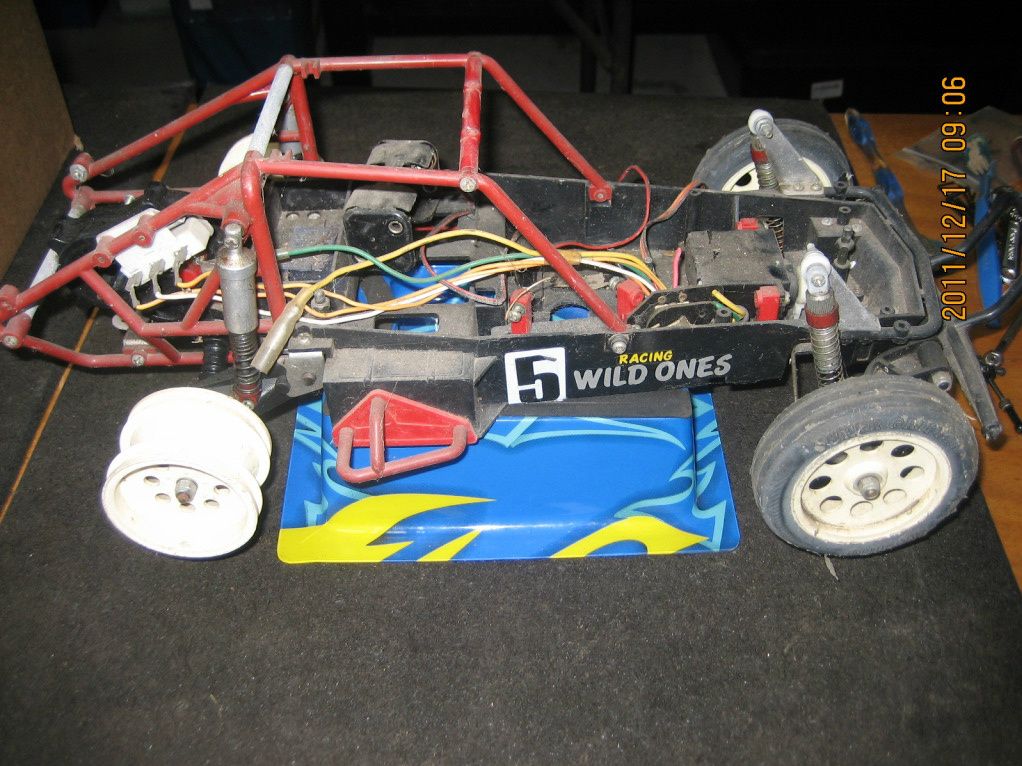

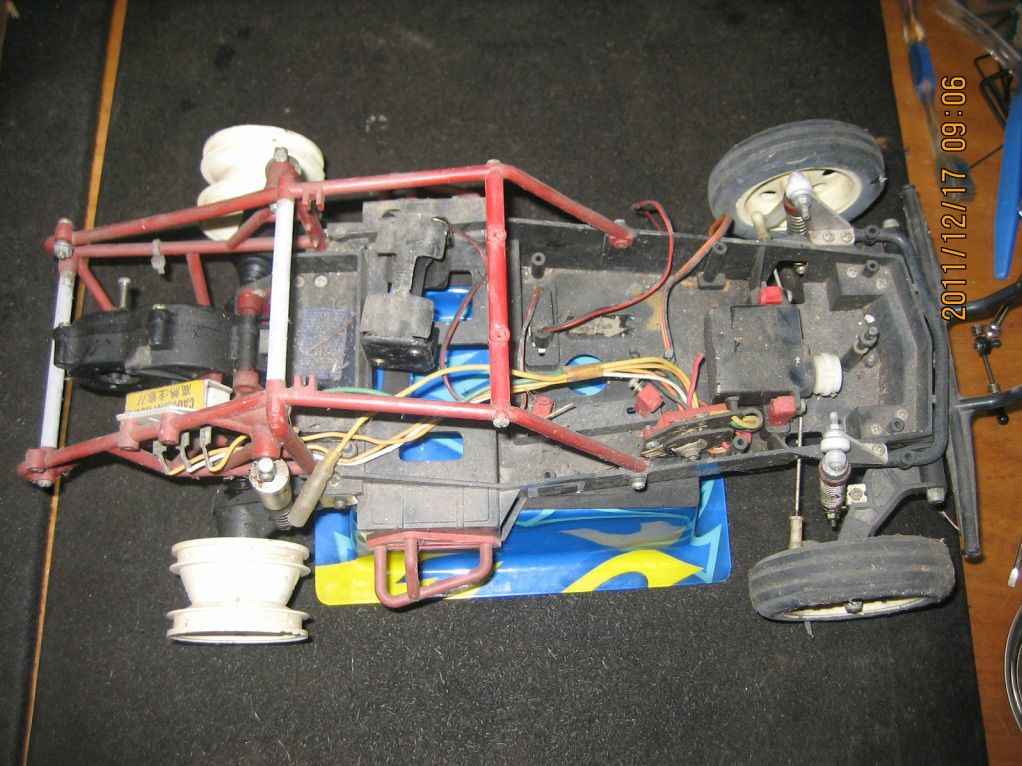

As it came to me:

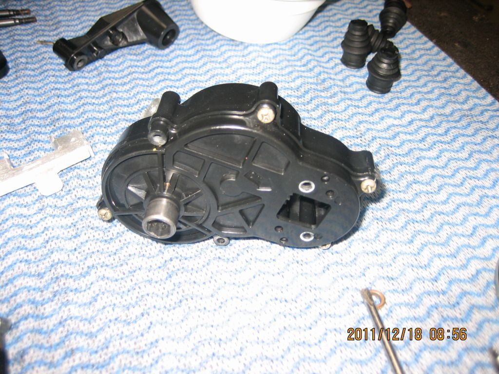

gearbox apart and rebuilt:

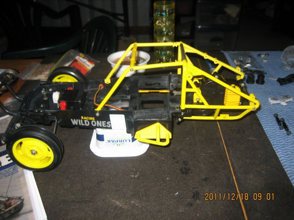

As it sits now:

:D Love the yellow , looks great . Paint or did you die it ?.

It's paint, one good crash and it'll probably all scratch up. I'll see how the shocks come up, otherwise I might order some aftermarket ones
