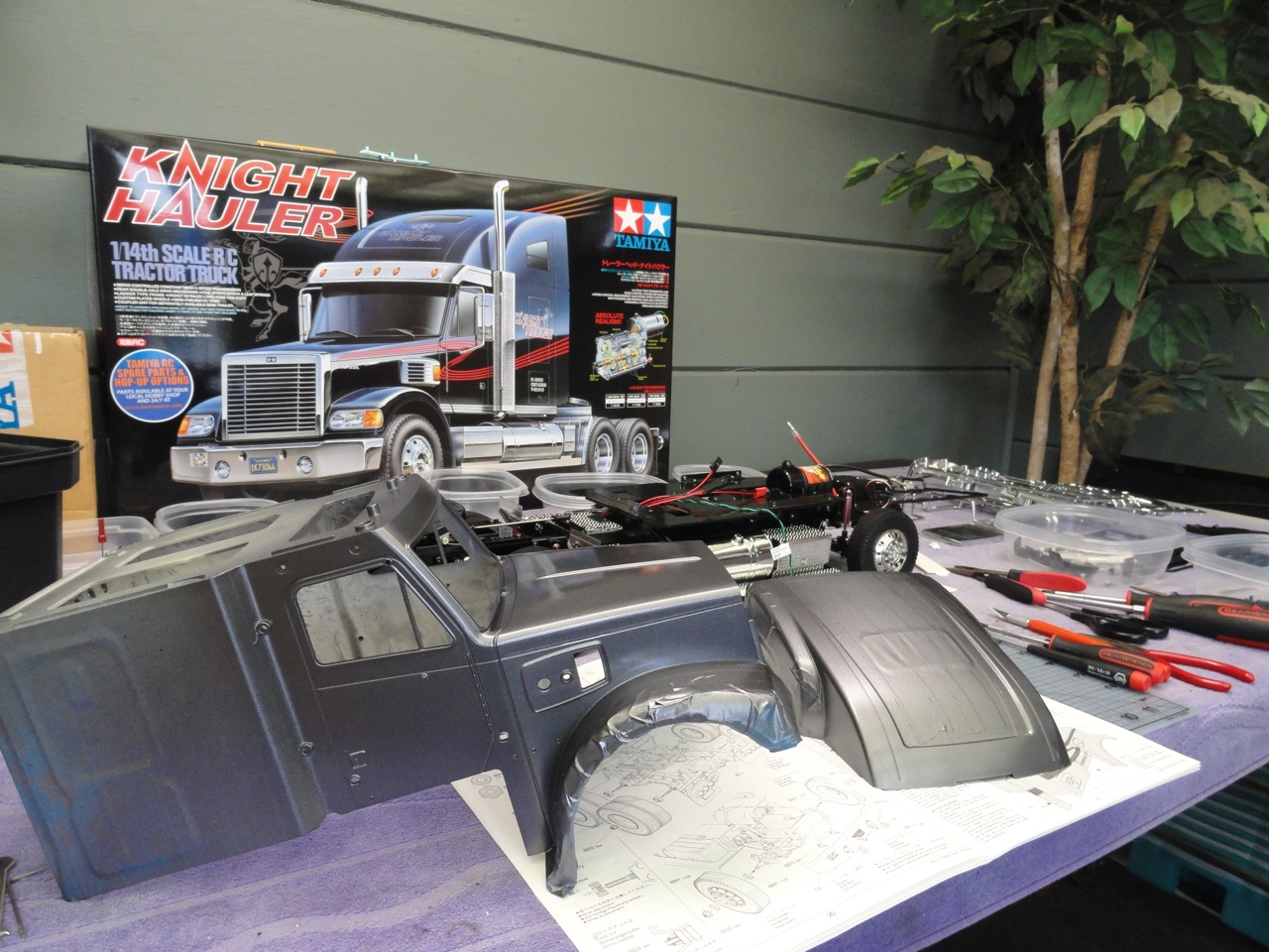

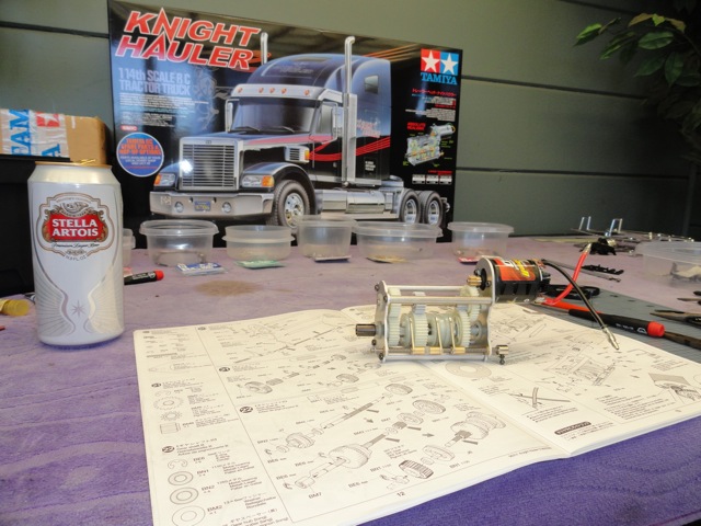

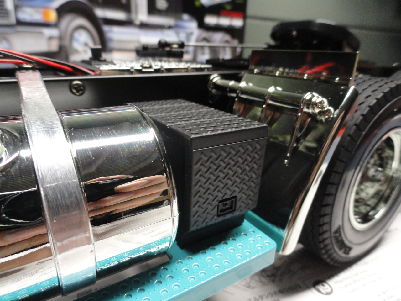

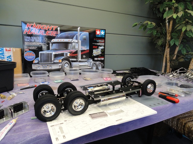

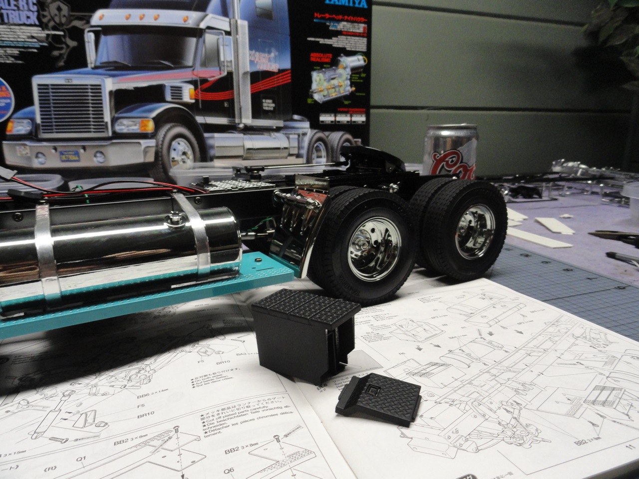

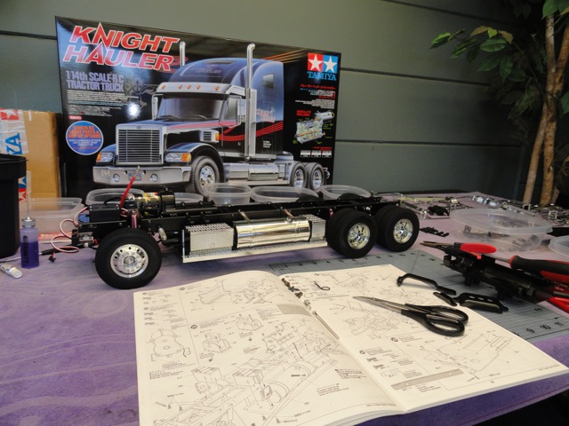

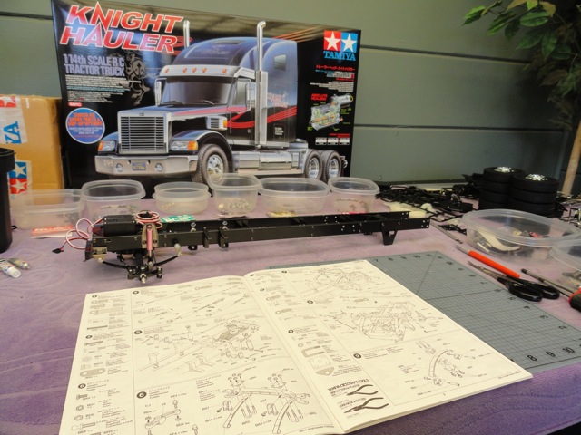

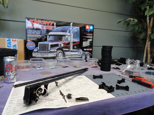

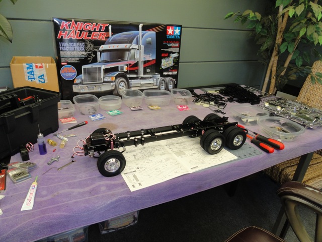

This is just going to document the build of my Knight Hauler I got for xmas...
What a great build so far... something totally different for me. Taking my time, cutting all excess plastic from the parts after cutting from sprue. Also ALL metal/metal nuts/bolts/rails have been locktite set.

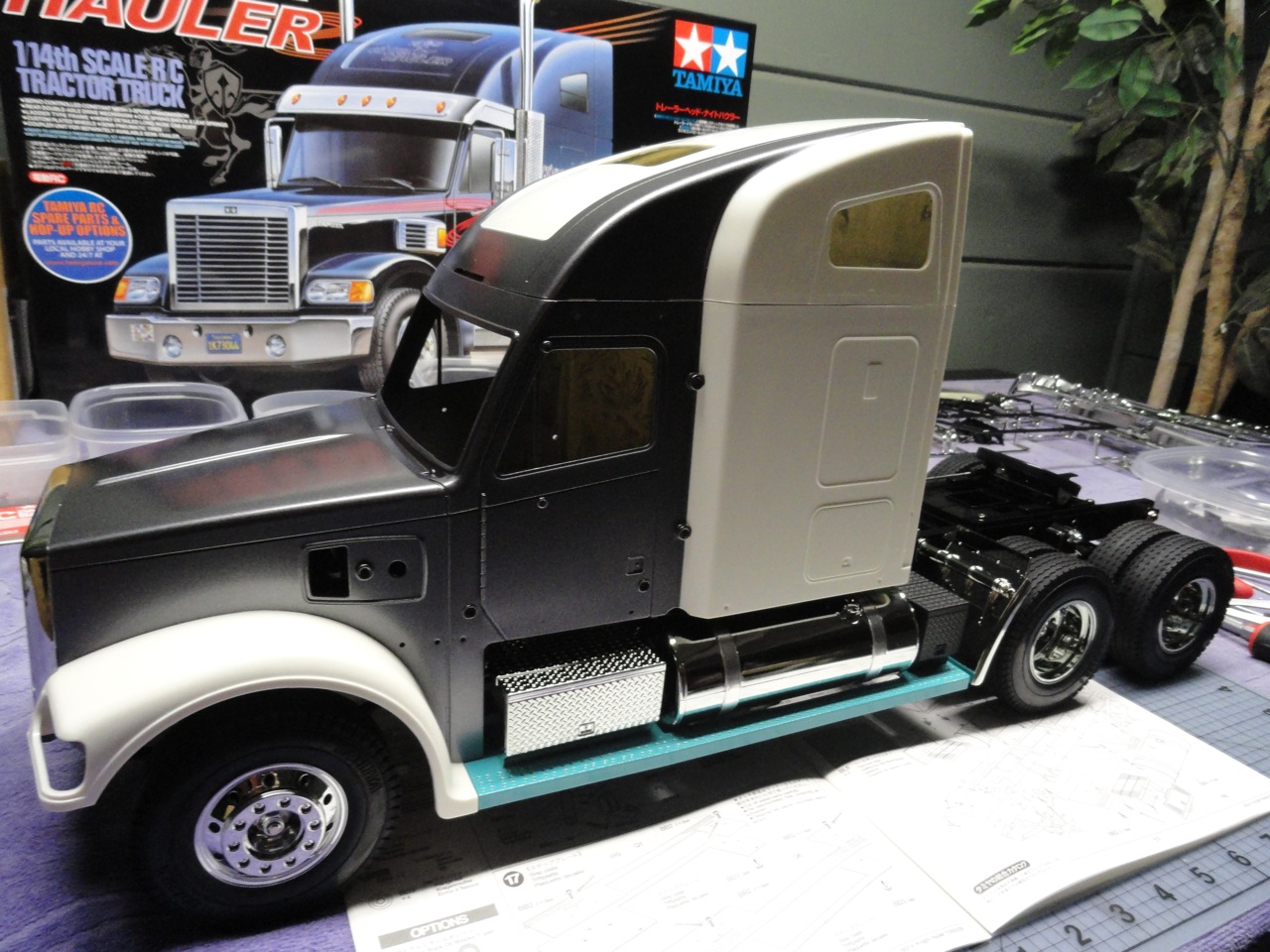

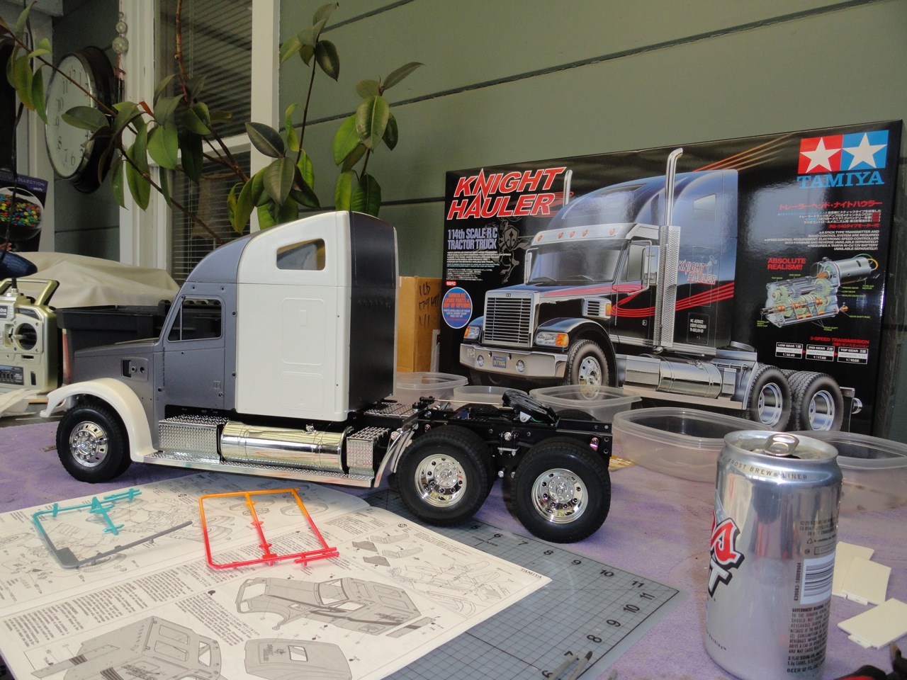

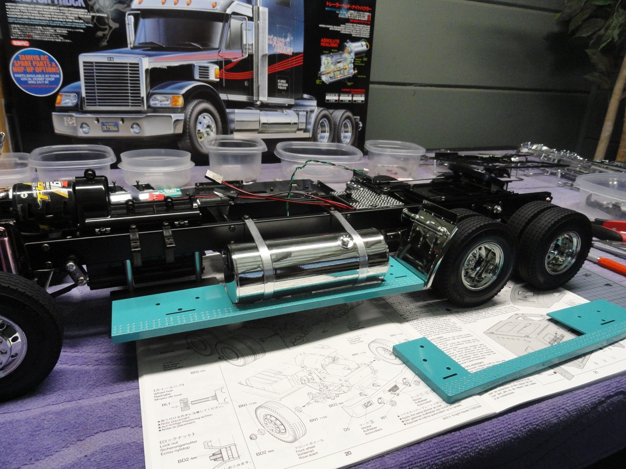

Has been a smooth build so far, but I will for sure be doing some painting. I find all the chrome to be boring, and the same.
Cheers,
Skottoman

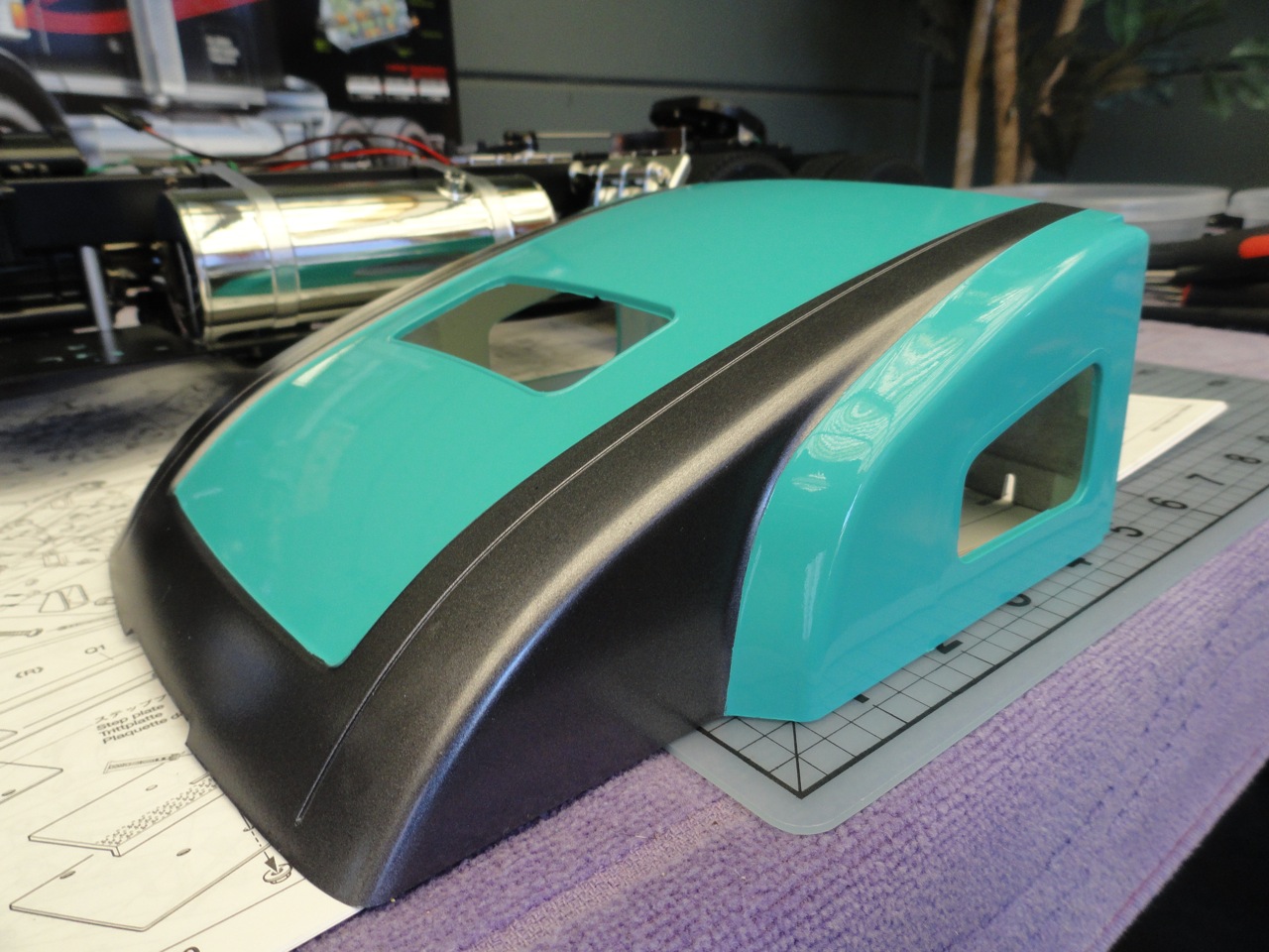

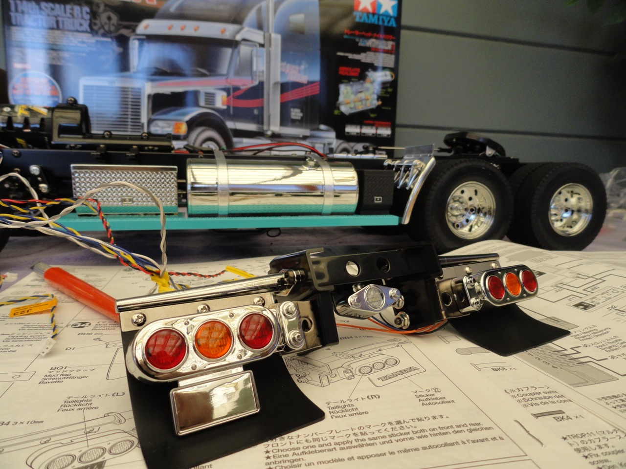

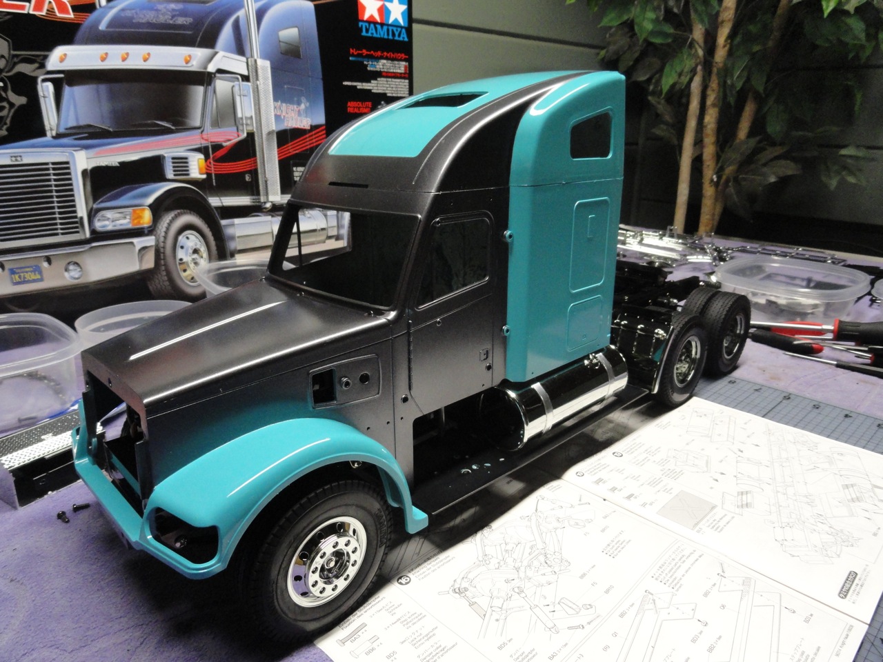

Neutral gunmetal painted! Now after a week of curing, I can add the accent color. It's the coral blue on the test sprue... Can't wait!

Nice job, I do like the trucks.
Bought the Merc a couple of year ago, wanted one since the king hauler first came out,
Now it just sits in the wardrobe with a few battle scars on it, think its time for a break down, rebuild and a fresh coat of paint.
Nice colour choice, I wasnt too keen at first but definatley growing on me and the list for customisation is ENDLESS.

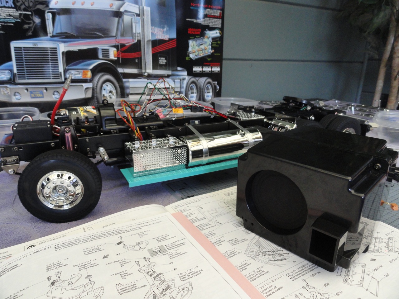

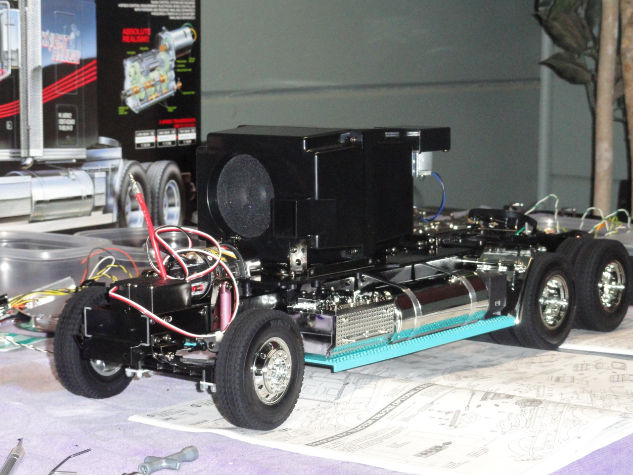

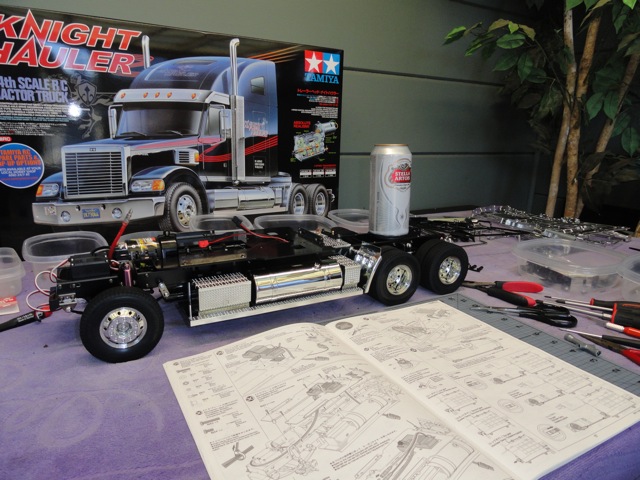

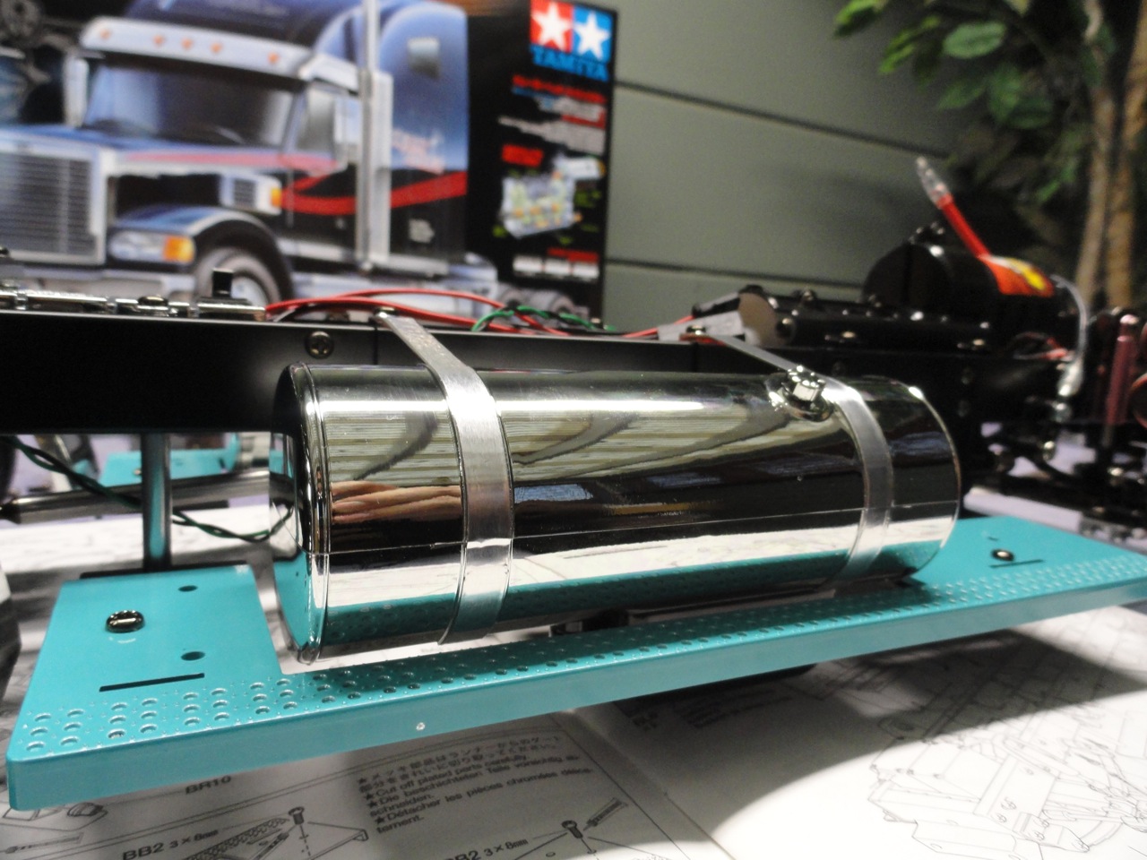

Now that the speaker box is installed, I can see a major mod I need to do.
I really want an interior (you can see the box takes up ALL the room), so I'm going to put the speaker in the top cab pointing down, seal it off except for a port into the main cab, and turn that part into a speaker box.
A little smaller volume, but I think it should work well. Basically a speaker enclosure on top of the cab. nice.
But for now I'll build it up stock... keep on building... keep on building...

I don't actually have a trailer yet, but I think the over the cab speaker box will do the trick.
For now I'll leave it stock but really want an interior!
I've read other places that some people have actually put more of a subwoofer IN the box trailer!

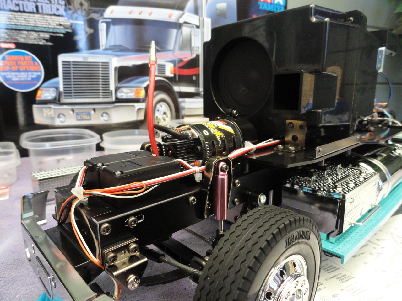

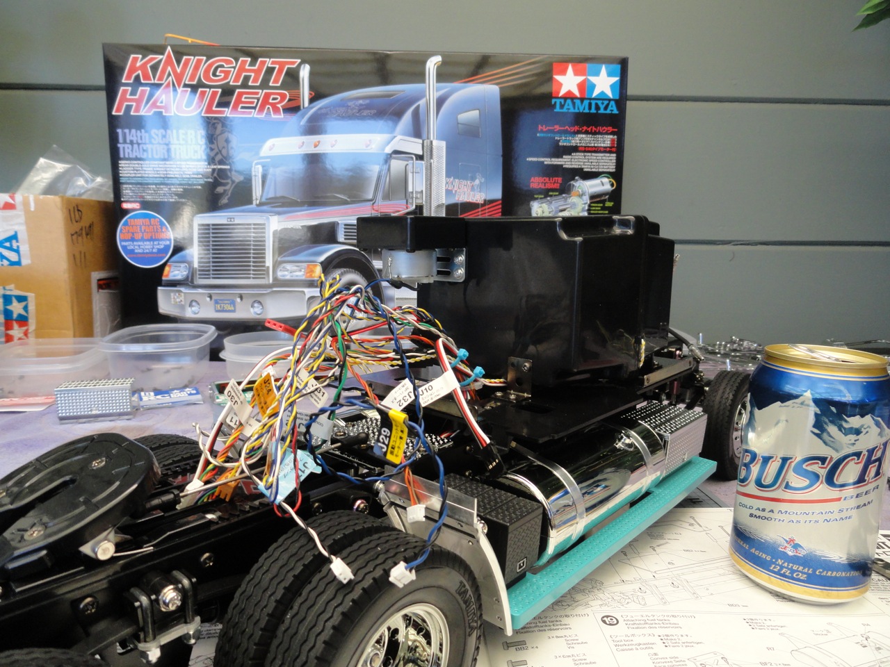

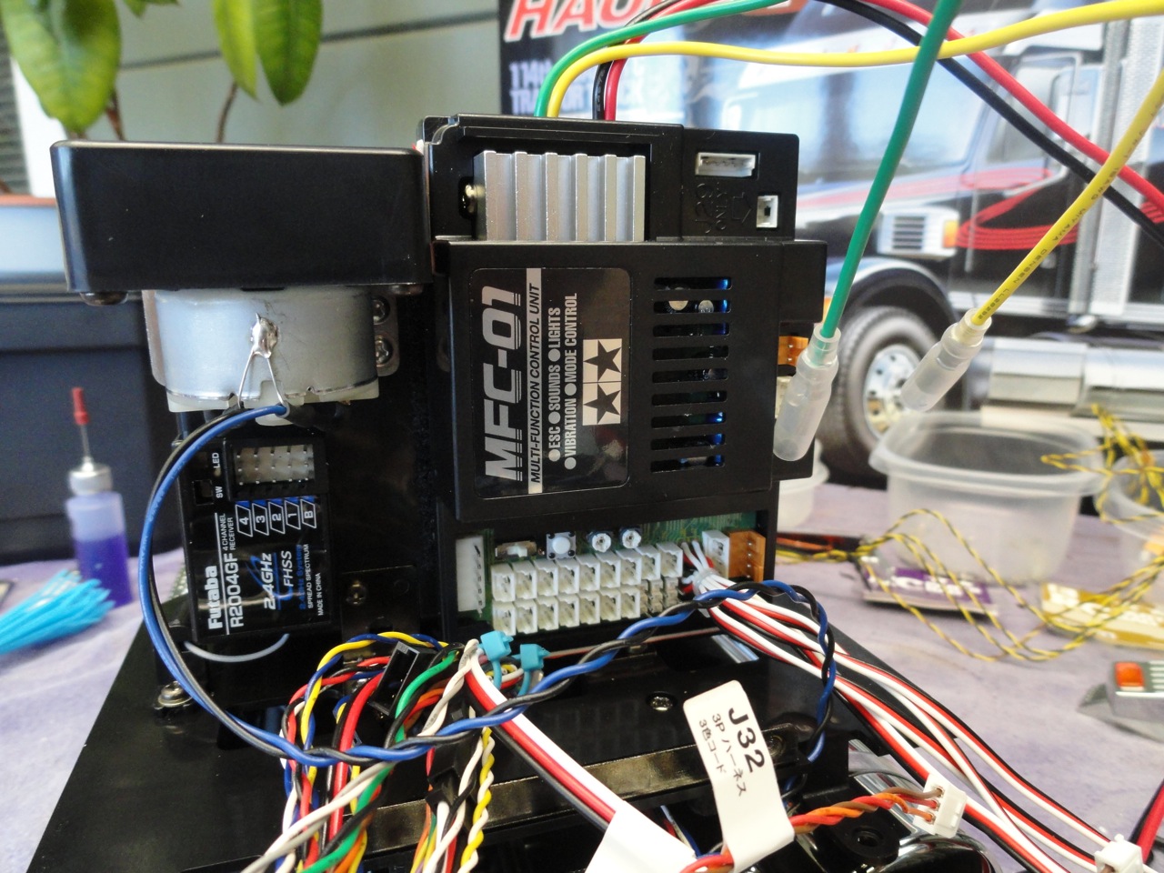

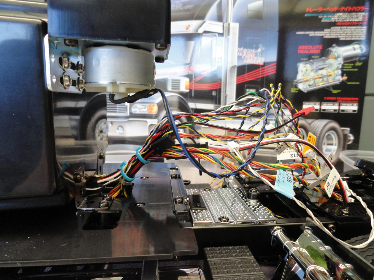

ARG! Spent the whole day trying to get the basic electrics with the MFU working... No lights yet, but it seems the radio I have doesn't work.
For some reason it appears the 2.4 messes up the MFU. It's never consistent, I can't calibrate it, sometimes it works, sometimes it doesn't...
Here's someone else describing one of the problems I'm having. He went to FM and it works now...
http://tamiya3speed.com/forum/showthread.p...s-over-and-over
Guess I have to get another radio! ARG!
Well, regardless of the radio issue, I'm very pleased with my wire routing/management, and the body is still curing. What a great kit though! Just wish the 2.4 systems worked with the MFU!!!
Hi Skottoman, which 2.4 r u using? Guessing its Futaba, looking @ ur rx.....
I duno abt futaba...but i have guys over here who r using Spektrum DX6 & DX8 and they dun have any issue
Perhaps u could search up on it...
Btw....nice truck.....
Some guys here also run the MFU with Futaba 2,4 gHz.. The problems lies in the digital trim of the TX´s as the (lousy) MFU is designed to work with the ratchet-type trimmers.. Very annoying..
I think some of the Spektrum 2,4´s come with ratchet-trims, don´t they?
Anyway, a Futaba F-14 or 16 are also great TX´s, and usually works flawlessly without interference, at least, that´s my experience..

HAha... well servonaut may be in the next truck... I really wanted to see what Tamiya had to offer with this one.
My Transmitter is the Futaba 4YF, and it does have the ratchet type trim levers. I'm probably going to just have to get a new FM radio for this one, and use the 2.4 for one of my Trail trucks.

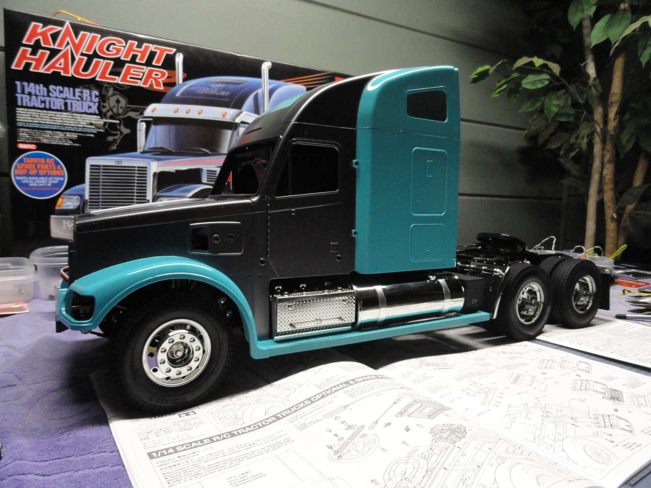

The colors? Well yes, I would have normally gone with a yellow/orange/red to go with the gunmetal. But this time I wanted to do something different. I also look at it and think, "Interesting...", and it's growing on me because it really is so different. Should look really great with some decals and all the chrome work on it!

Well, if you DO have the ratchet-type levers, it should only be a matter of setup on your MFU, which also can prove a bit annoying sometimes. :( Lots of guys here have experienced troubles with their MFU´s and quite often, it turns out that a simple re-calibration is the trick :) Sometimes, also the selector-switch on the MFU control-panel is in a wrong position, either from handling the car, or simply having pushed the switch by accident..
Also, you cannot always trust the channel-description in the manual, (using the stickers for the cables), but have to make you own setup to match the radio you use. B)
About the colours, i really think that turqoise-thing goes well with the gunmetal, but i would have chosen another design, as the entire sleeper in that colour makes the sleper look very "boxy" along with the rest of the shell, which isn´t exactly the way you would describe the Knight from the beginning, being very aerodynamic.. Sorry. ;)
I think the "normal" scheme where the sticker-stripes had been replaced with the turqoise would have looked smashing!! Especially along with the roof and fender-details in the same colour. B)

After reading up a bit on the Futaba 4YF 2.4ghz, it appears the trims are indeed digital even if they have the ratchet type settings. Oh, well, will just order up an FM system.

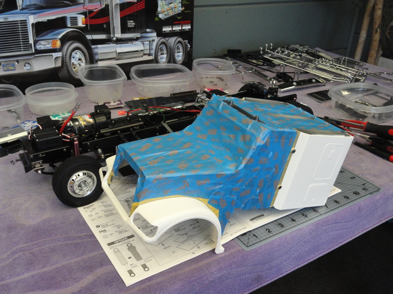

As far as the cab paint design, I just followed some of the body lines, and I think it turned out ok. I can picture what you are describing, and that would have looked really nice as well.
Will have to see how it looks once all "Chromed" up, and with some extra details...
Now to do some body prep for a clearcoat while I have to wait for a new radio to arrive.
