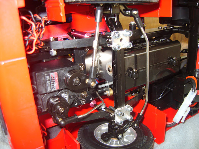

I used low profile servos and the two parts numbered 1 of the G sprue that comes with the MFU kit to get them set up the USA truck way also wedged them in and used hotmelt to hold them in place, the mounts are resting on the lower flange of the frame rails and the servos are lower than the top of the frame rails to give extra clearance to the motor
I have done this to the two tamiya trucks I have built and the third which I am building at the moment
Hi that looks cool, I am running on a budget so unable to get some small servos. I used all parts from the kit to do my version of this mod.
I screwed the servos to the front cross member and used the gear shift servo mount to hold the rear end of the servos in place, I had to use two spacers from the kit "C" parts sprue.
The spacers give just the right amount of clearance ,betwean the bottom of the servos and the motor.
I also put the left upright on the right and vise-versa and bent the drag link (it is just about long enough). I have used the standard servo savers, but have ordered two low profile servo savers.
On my first test I found I had more lock on one side than the other.I got round this problem by off-setting the steering servo saver and lengthen the steer rod from the servo saver to the upright.
All done and dusted,
P.S sorry about the untidy wiring :-)

Thanks, what servos have you put in your truck...?????
I used two low profile servos that i got off ebay, they have metal gears and are branded bluebird
this picture shows the height difference between a standard servo and the low profile one
this shows the underside of my Mercedes tractor unit, with the servos name showing
Love them servos, looks like I will be moding a set of them servos in come pay day. "Hitting ebay as I speak" (doh I mean type).
I see the smaller servos allow you to run the steering arm betwean the chassis and the leaf spring, keeping the steering arm vertical
I had to bend the steering arm slightly to gat the rod end to clear the leaf spring on the suspension
