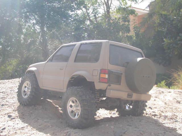

Hi,
From your post it sounds like you want to use specific wheels which you already have, if not, you can do like I have and use the Topcad wheels with adjustable offset.
