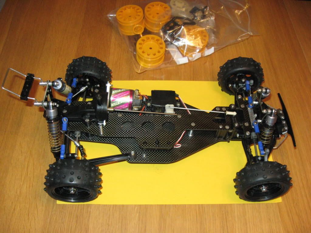

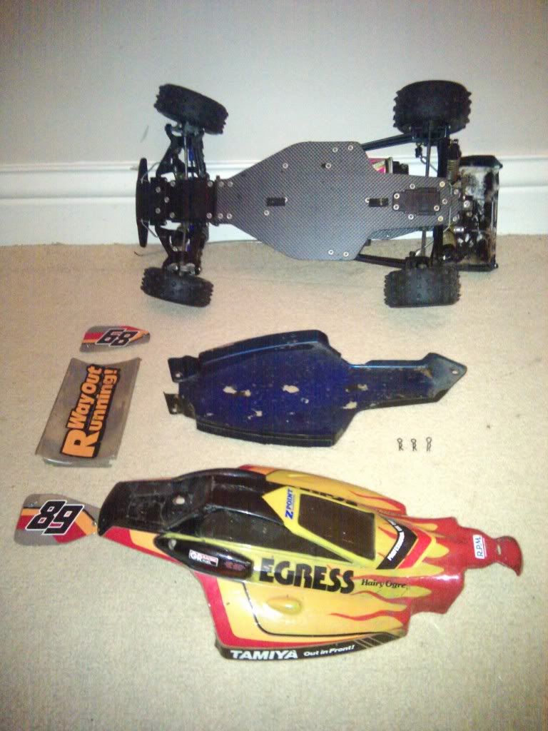

So the start point (pictures from Hambo's original post)..
I'd intended leaving this a few weeks to clear the workbench of other projects, but whilst waiting on some parts I thought it would be rude not to have a look and probe at my latest purchase.
So body first..

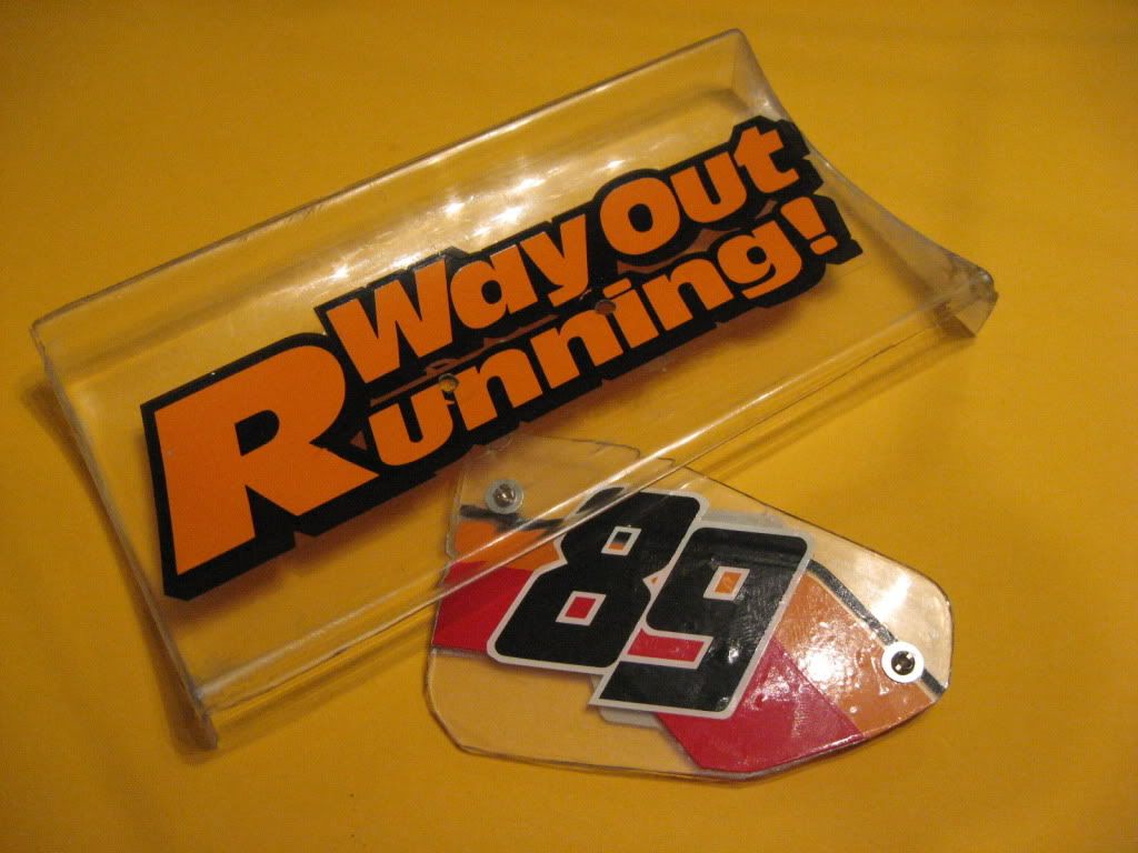

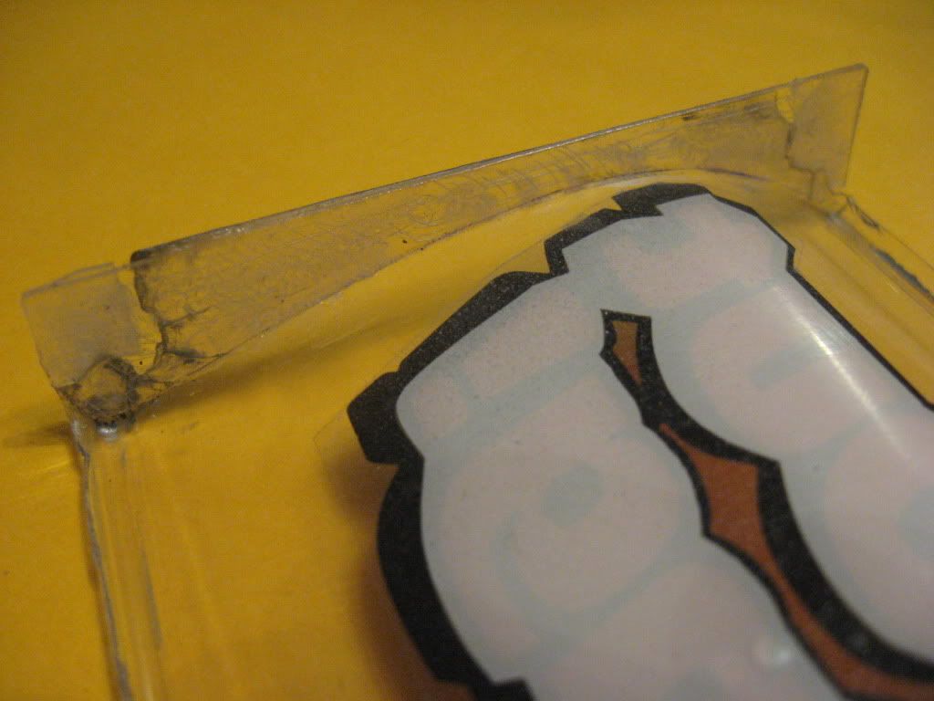

the original rear wing has suffered around the bolts holes for the wing end plates..
.. perhaps i can add a second layer of fresh lexan on the inside, bonded with CA glue, to strengthen the area and reattach the plates - any suggestions ??
The undercowl has some flaking paint, so that will be removed and repainted - perhaps smoke, perhaps gunmetal, perhaps boxart silver, perhaps chrome ?

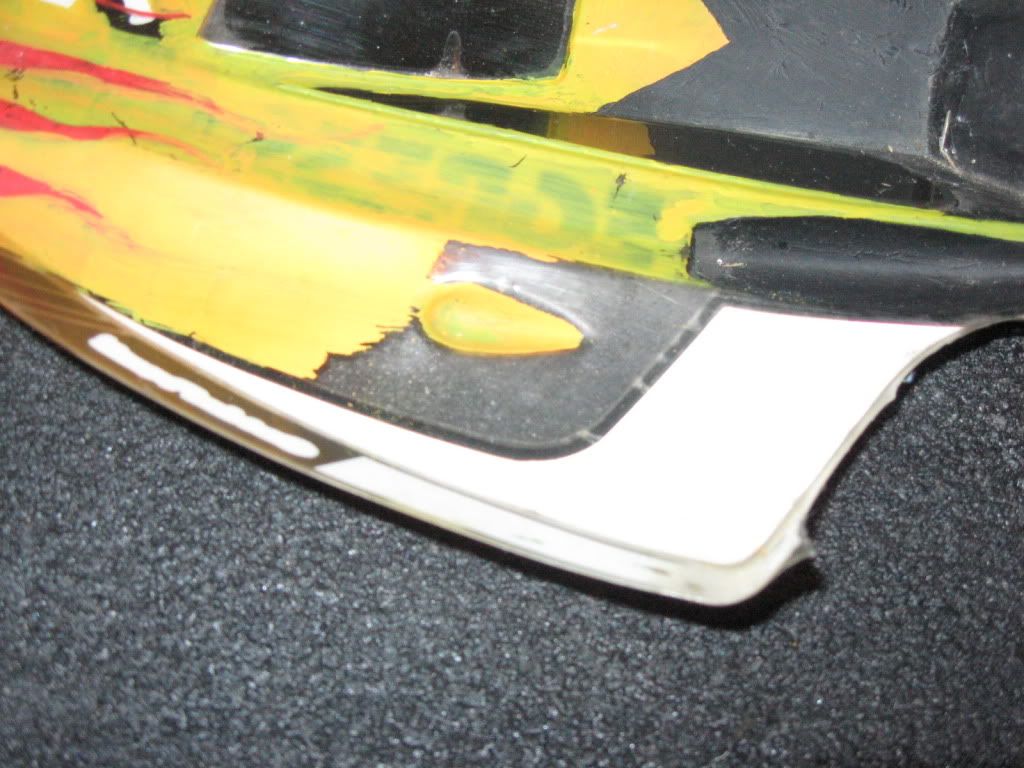

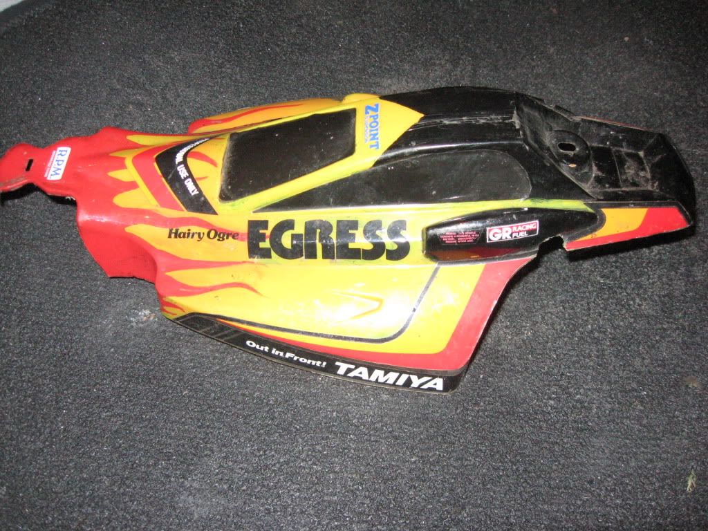

The body itself has no splits or tears - it will clean up nicely with some car polish on the outside - i'd prefer to repaint it for a better finish, but its OK for now and with cold weather at the moment its no time to be spraying paint. I may get a ***** body in time. A new set of original decals should arrive in the morning; thought i'd grab those while they are still fairly reasonable prices ! ;)

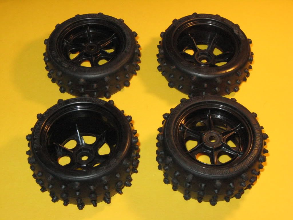

wheels off and cleaned. Schumacher blue foams have been added inside the tyres to give the original tyres a bit of help to prolong their lifetime..

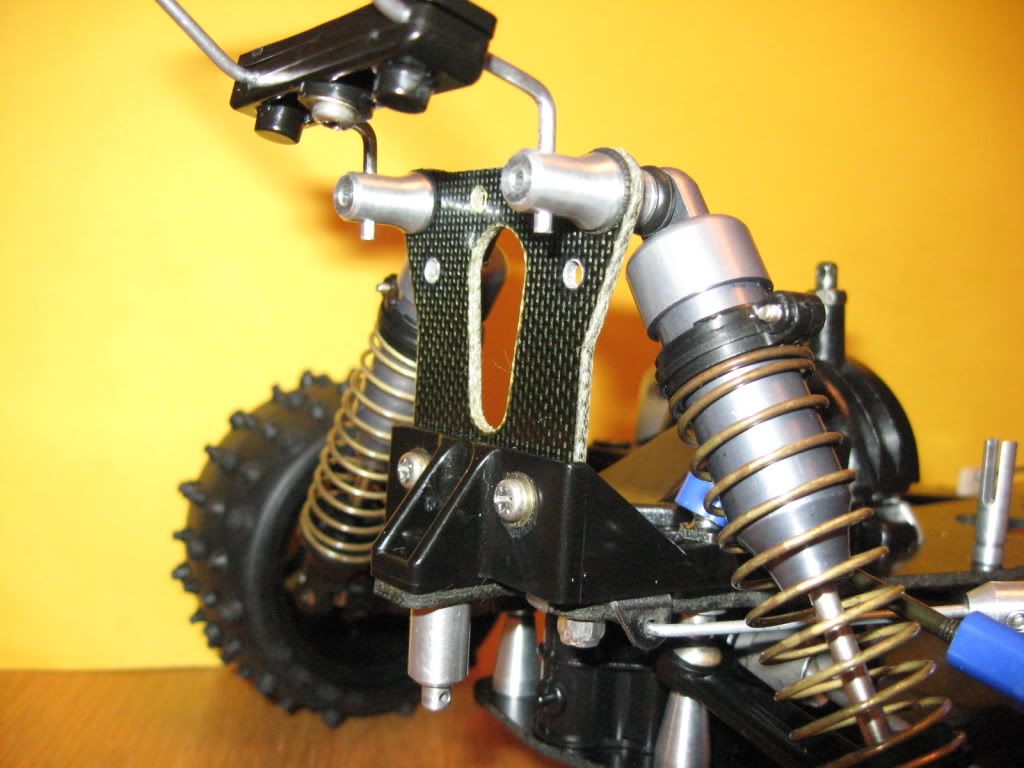

Now onto the rear suspension area..

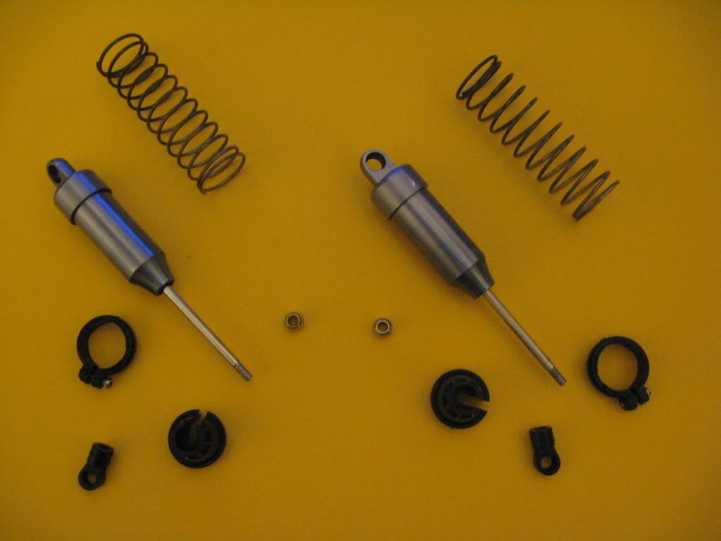

Rear Hi-caps removed, drained of their (superclean) damper oil, cleaned and now ready for rebuild - not sure what weight oil to use, but most of my cars run 35wt silicon oil - any suggestions ??

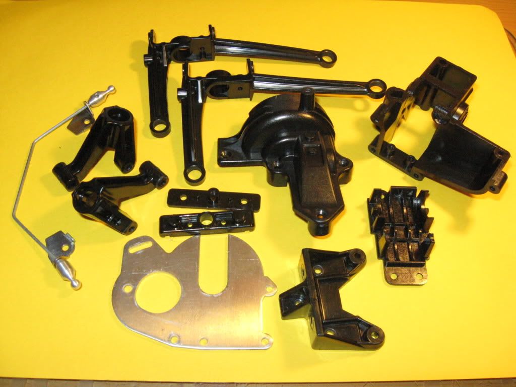

The rest of the rear end was then removed from the car. All plastic parts cleaned up...
Rear wing stay, pressure plates, chassis plate spacers all cleaned to remove dirt - no agressive cleaning required !

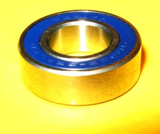

It quickly became apparent that the car had seen very little use, as Hambo had said all along. Wheel bearings were like new once a little surface grime was removed with a dry cloth..

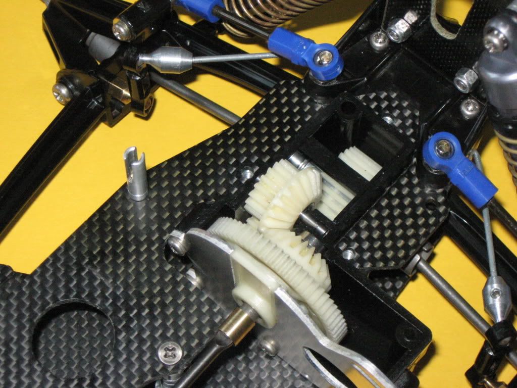

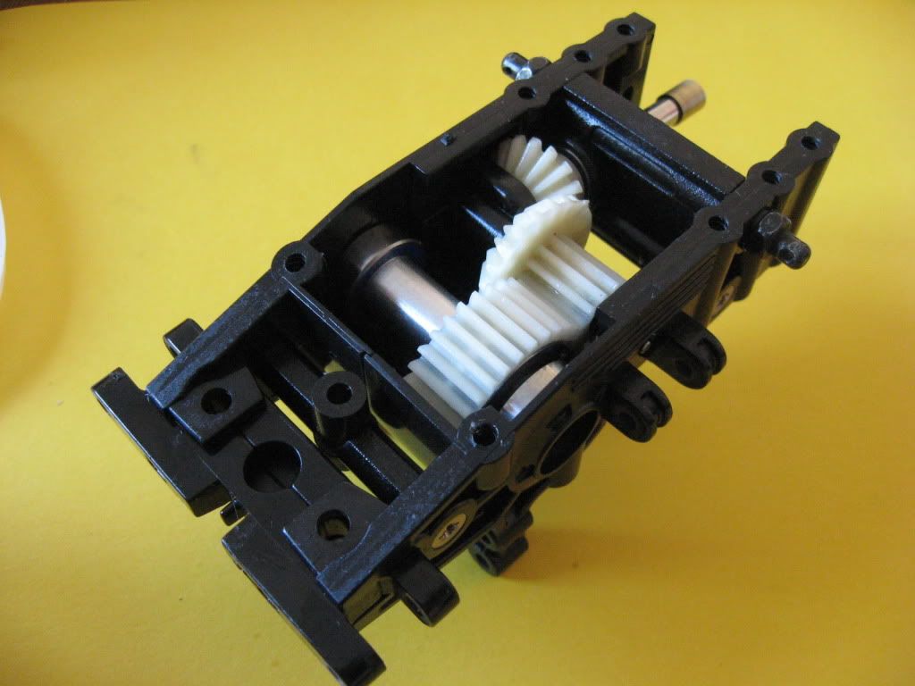

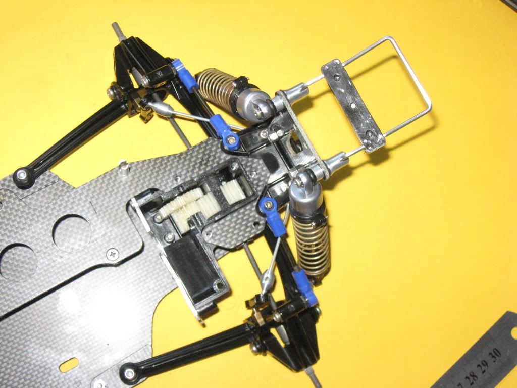

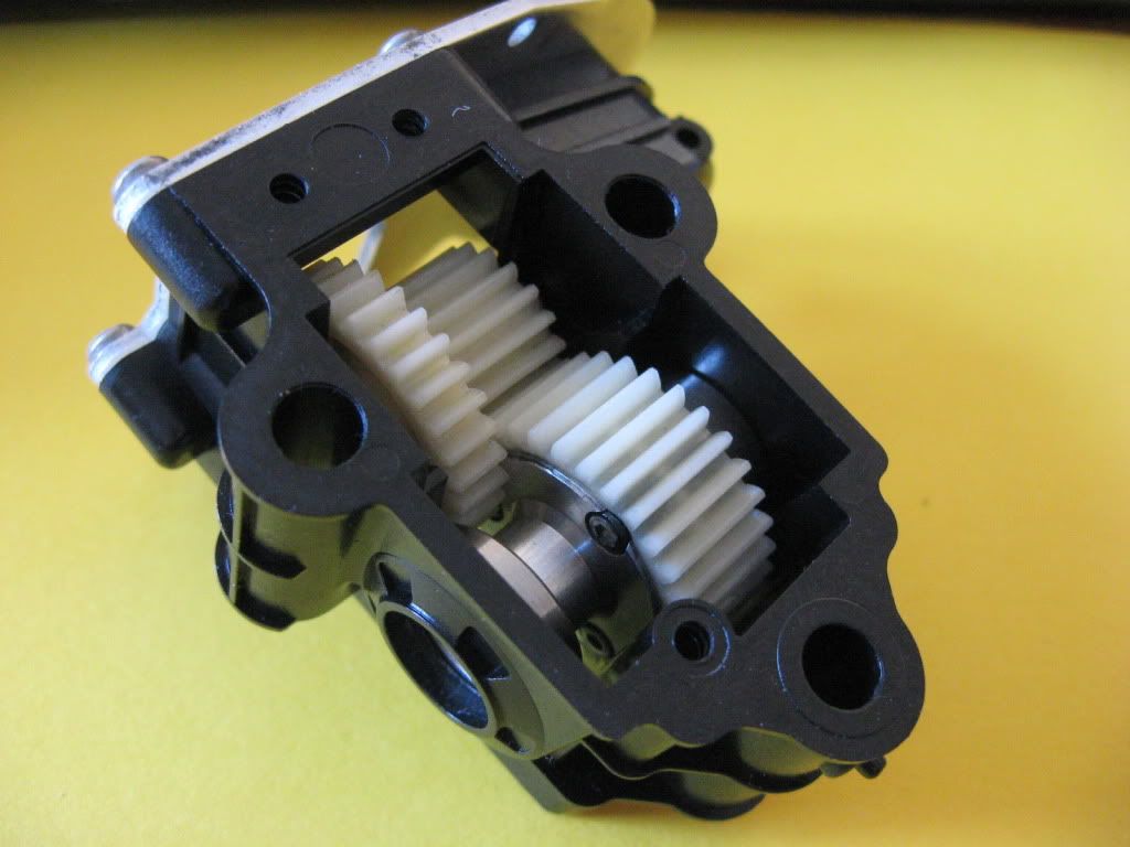

Onto the rear gearbox internals..
..well at this point i started to wonder why i was bothering, the grease was as it left the tube the day it was originally built, no discoloration, no debris, nothing but clean grease to be seen. As a result i decided not to open up the differential, just clean off the grease ready for a new application on rebuild...

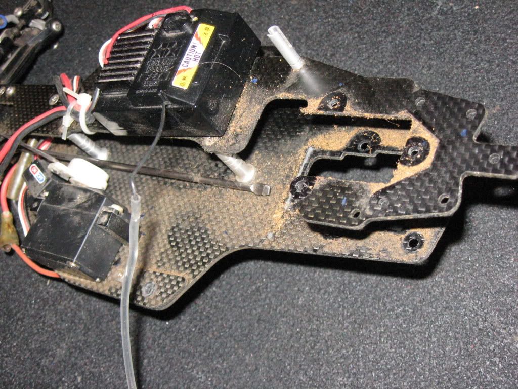

So this leaves me with the chassis now looking like this,,

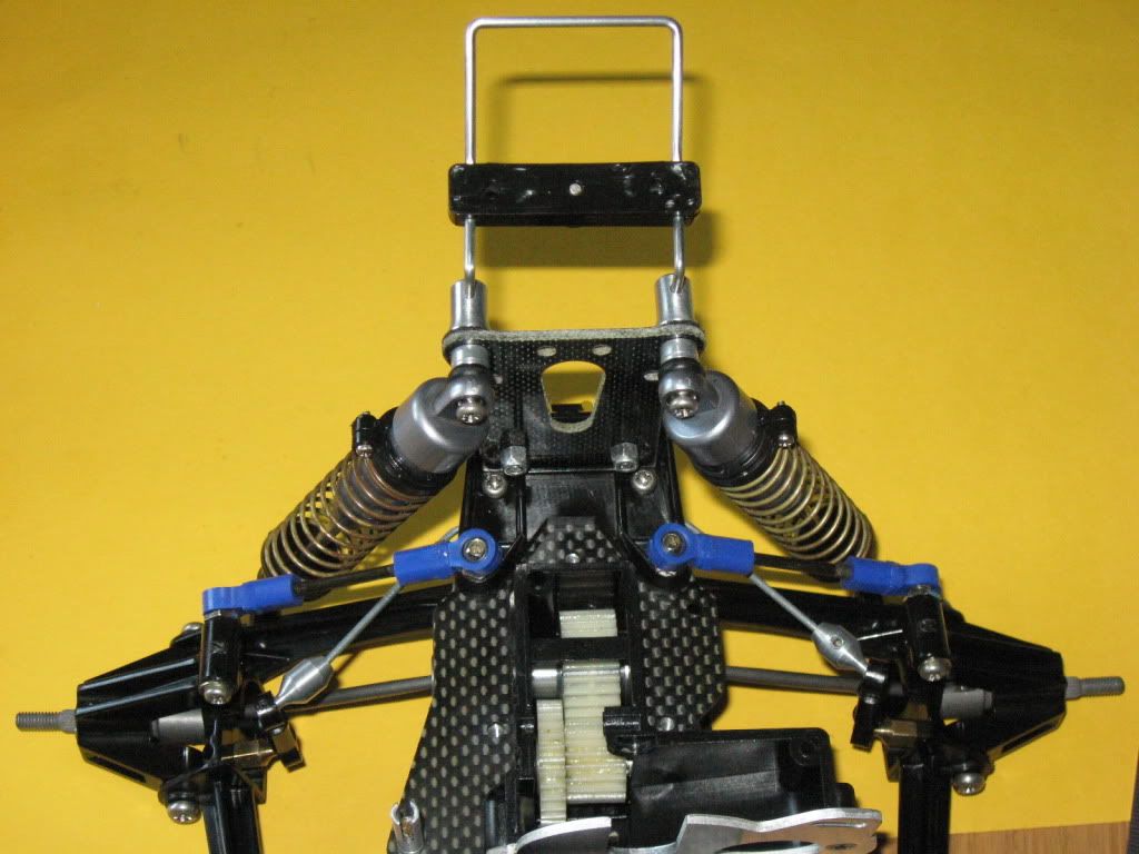

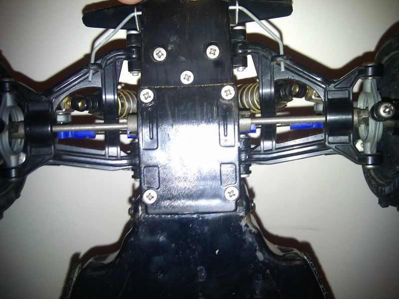

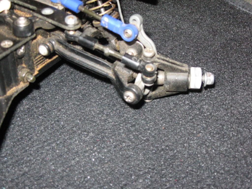

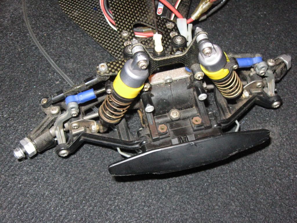

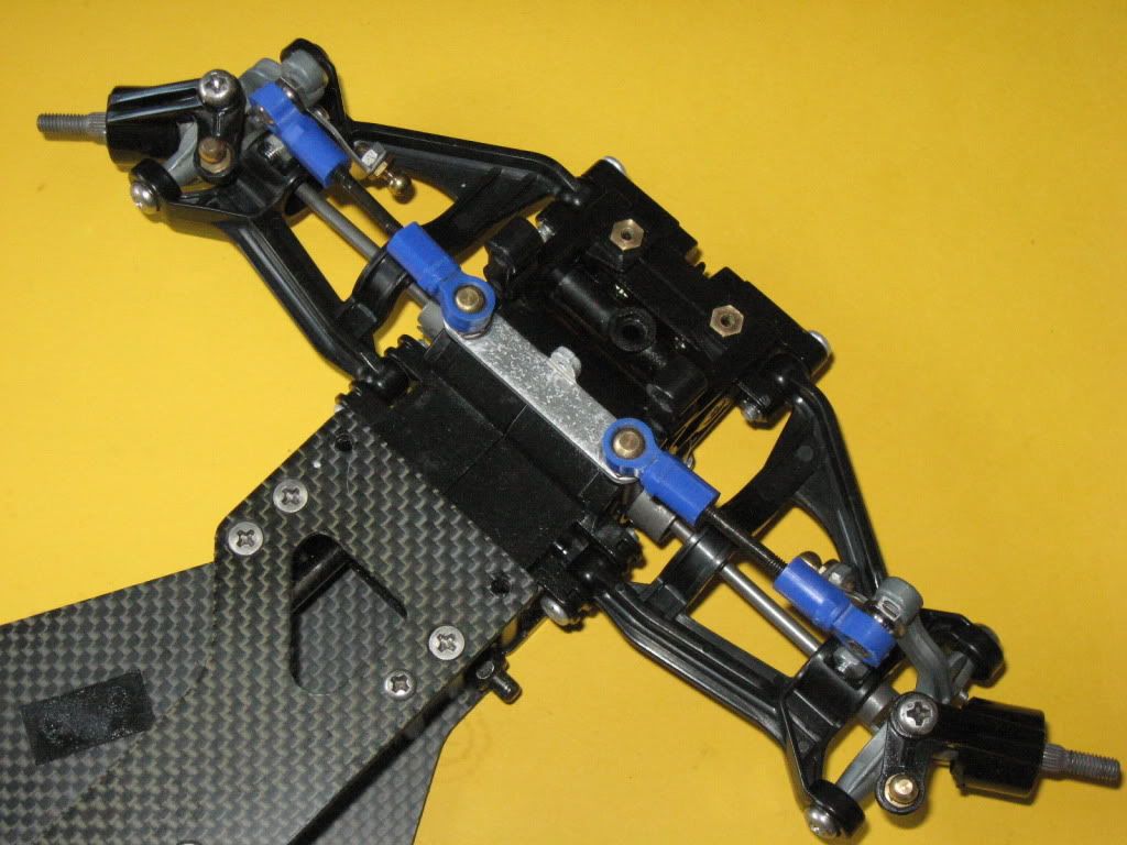

Front knuckles, driveshafts, shock tower and hi-caps now removed and ready for cleaning.
Struggling with the front bumper - one of the nuts that recesses into the plastic on the top side is turning in its recess so will need to improvise to remove the last bolt holding the bumper on. Have left it soaking in WD-40 for a few hours to free up the screw thread a little.

Rear gearbox - a quick look before it gets sealed for another 20 years..
Front gearbox - bye bye, see you in 2032 :lol:

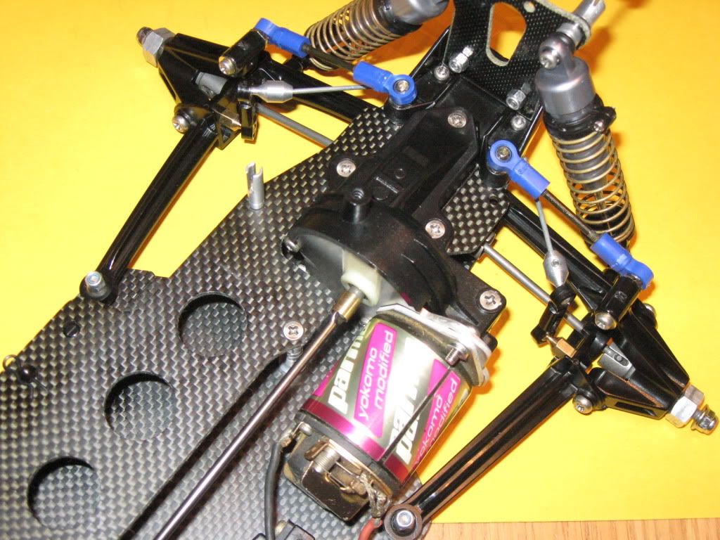

Gearboxes mounted to chassis plate..
Top chassis plate, rear swing arms and drive hardware installed..
Front end coming along nicely too..

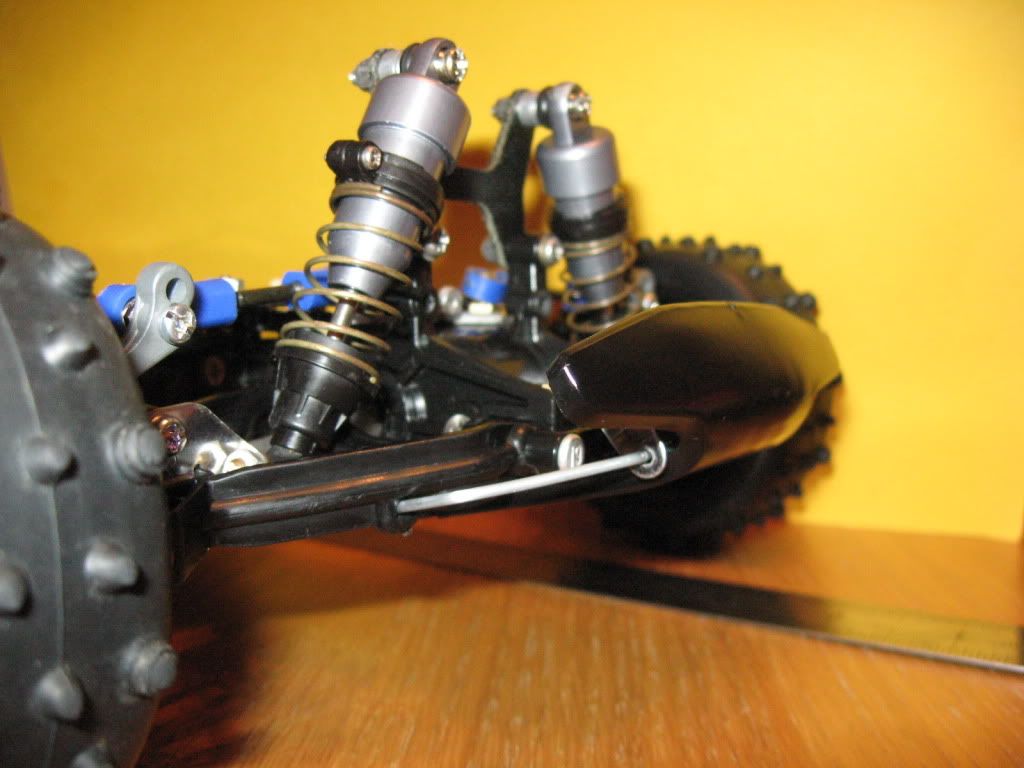

Rear shocks and wind stay added..
Front shocks added
Final rear gearbox cogs added - went with the one way bearing configuration as previously built..
Previous motor added, gear mesh set using the 'paper method'

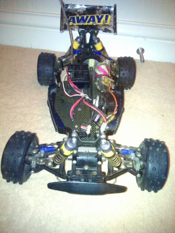

Almost done..
Front close up view (new bumper)..
Rear close up view..

I'm going to try to repair the original rear wing.
The shell doesn't have any damage as such, a slightly bigger hole where the rear body post goes but thats all. Undercowl is fine, just flaky paint.

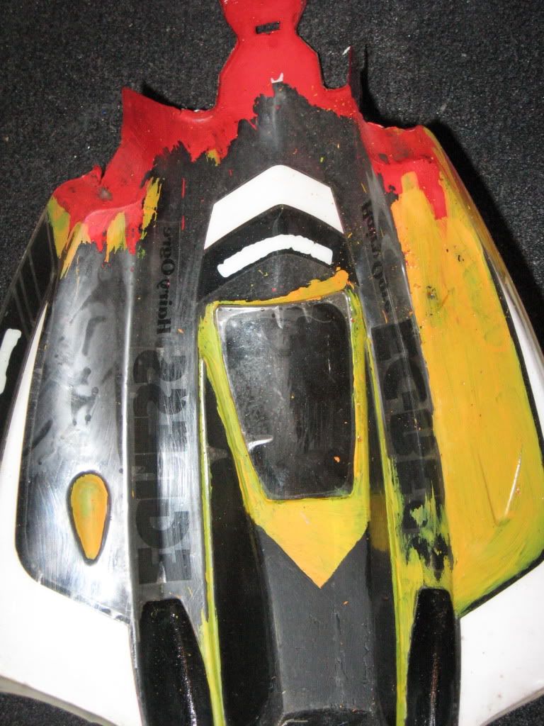

I was all for ordering a ***** body set, and a new set of original decals arrived today, but i'm having a play with the old shell....

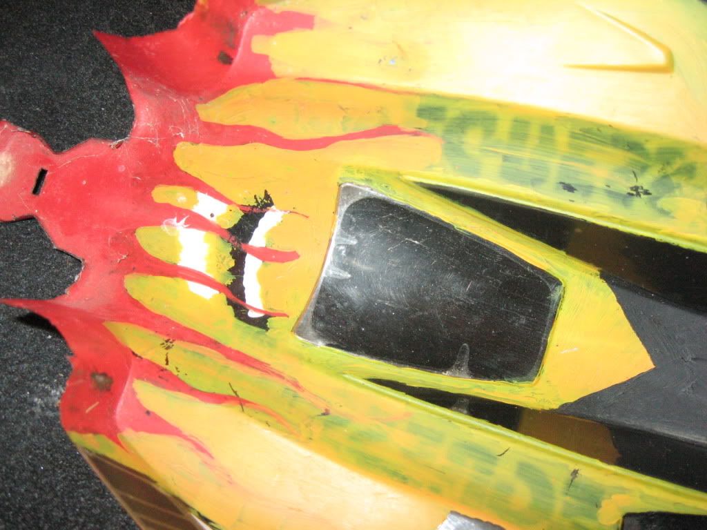

As it arrived..
and the inside - brush painted but only where the decals didn't cover the clear shell, so not too much paint. Inside..
Initial test with my magic lexan paint remover..
looks promising !
another 5 minutes later..
and after 30 minutes, with a few interuptions to my other project..
topo down, with white cloth underneath to see progress..

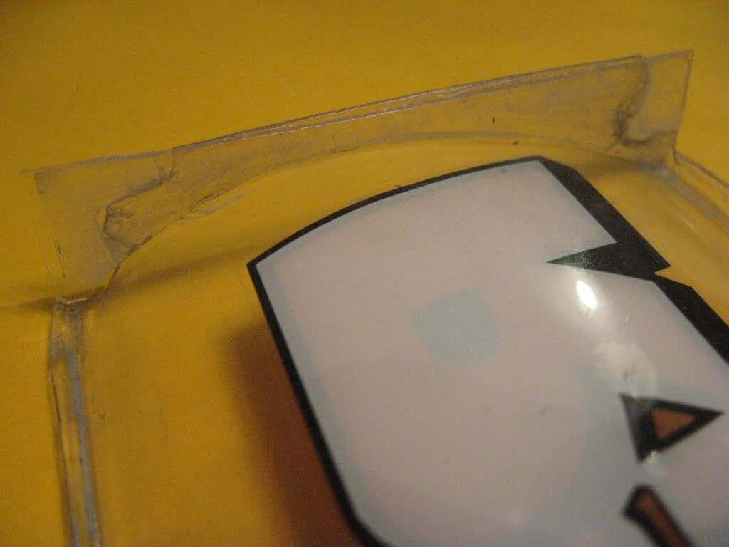

With my attention diverted to a nice short project of a Supershot/Hotshot hybrid runner, this afternoon i got back to the Eggy, turning my attention to the rear wing and repairing/reinforcing the broken section where the end plates bolt on..
Before..
After paint removal, I cut a section of spare lexan to shape and CA glued this behind the original secion, then added some scraps of lexan to level out the original mounting surface...
All together
End plates bolted together so i can get them symmetrical..
