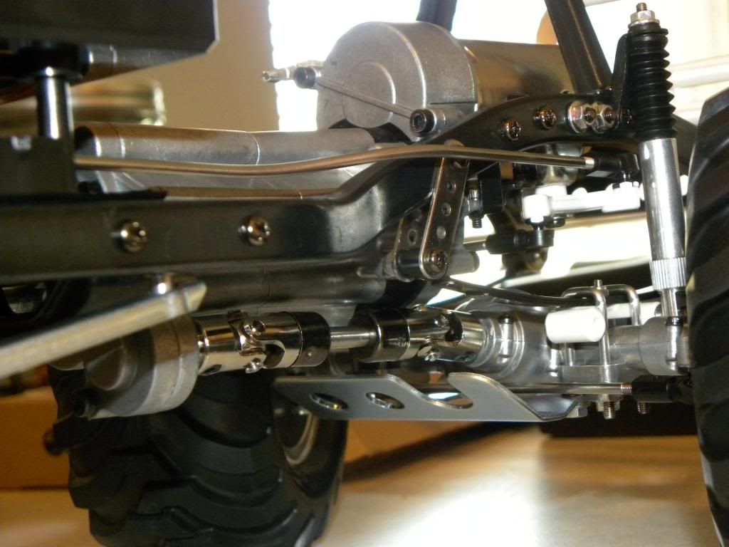

Not to hijack this thread...but, ive got a couple questions about Senior Bruiser.
On mine the front drive shaft is real close to the trans. It actually strikes the trans when you compress the front suspension. I's doen't really matter because it will be on display for a while, but it just bugs me.
Also, the traction bars. Do they just kinda float there and rattle around?
Traction Bars do just float .
Now the drive Shalft hits on mine as well , NOT to sure if i had set the front diff on the right
angle & this is why it's hitting ?. I'm sure i had , But may not done enough ..
My vintage Bruiser has ALOT of room in the front , But then again the leaf springs in it .
Have more of them , As my RN36 i didn't put all of the leafs in .

I agree -- Check your manual: There's alignment marks on the axle housing that show you what position the diff should be in.
@KennyG: Yours looks like it's clocked a few degees higher than standard?
I set the axle so the knuckles are at 90 degrees since they are clocked about 5 degrees from the output shaft. But I think i'll rotate the axle back a few degrees. Thanks for the input!
Went ahead and rotated the axle so now it's only at about 1 degree. Looks much better and no rubbing.

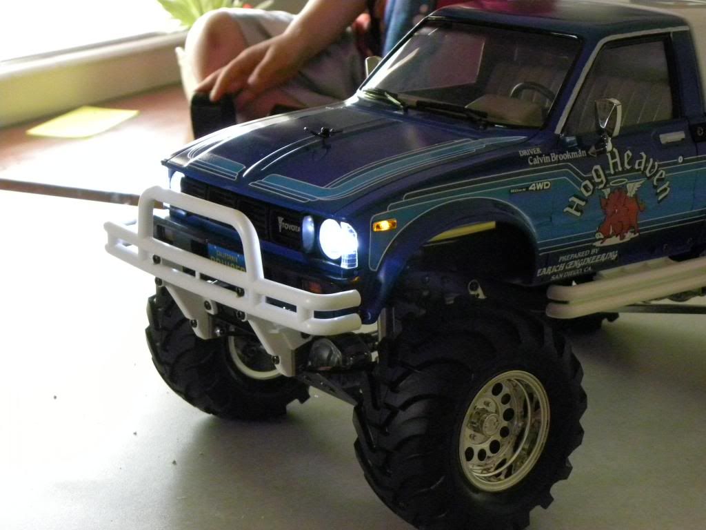

Here are some updated picts of my Bruiser. I now remember how much I disliked doing window trim on ABS plastic. There is always a run somewhere in the masking..
At first I had some reservation for the size of tire in relation to the amount clearance can be seen. Now, it looks find. The white wheels are nice and good trim paint work.
Thanks. I still feel that it sits too high. It's not as easy to lower the bruiser as it is with the Hilux 3speed.
If I remove the white leaf spring helpers, it will lower it, but then I have to mess with mounting the shocks elsewhere etc.

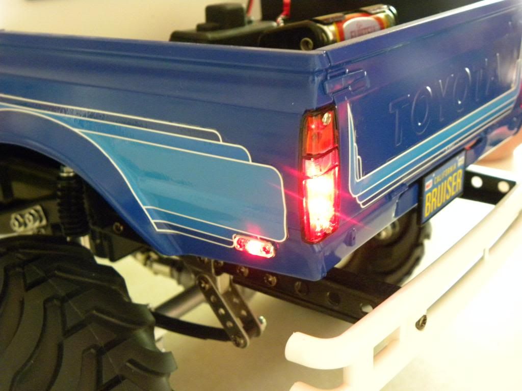

Let there be light!
Lighting is the Rc4wd Mojave basic lighting kit. Can't go wrong for $17. The pics make it look way crummy, in person they really look good.
