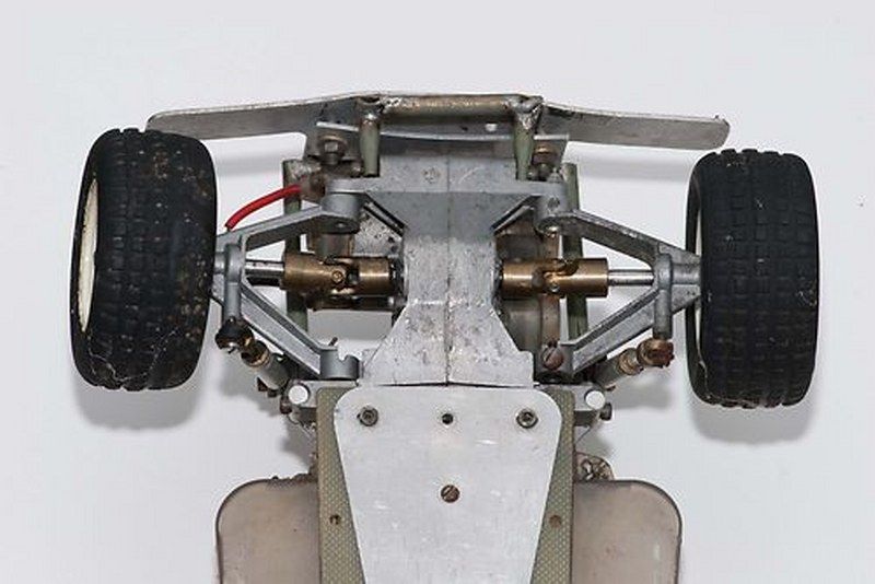

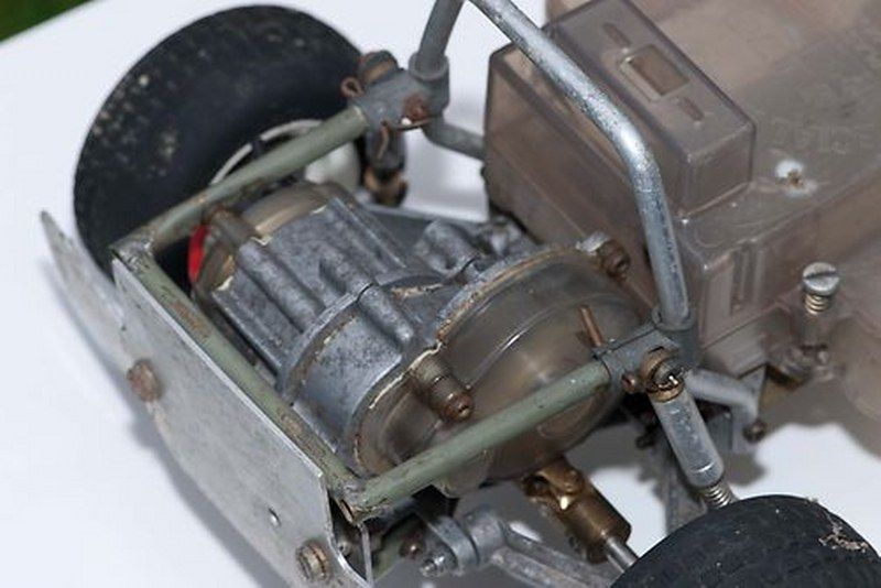

I have this collection of parts so far, its all based on what was called a Taipan version1 which was sold by an Australian exporter back in the day.
Its (front to back):
CRP butterfly chassis LWB
CRP Wide front axles
CRP shock brace (extra long)
RCH front Nylon arms
Kyosho Front/Rear (short) roll over shocks (depends if you want to run a mono shock)
JG Nerf Bars
CRP Rear cage with high shock mounts for longer shocks and rear stabiliser mounting screws
Standard Tamiya SRB Gearbox cut down - see motor more / light weight
SRB Ball diff
RCH Rear Arms
Hardened Rear UJs
CRP Wide rear Axles
Tamiya Holiday buggy rear tyres
Kyosho 1/8th Rear / Front shocks - these where the shock of choice to use in a Mono set up
CRP Rear stabiliser bar
I have a lexan RR shell for it and a period rear wing as well
I am really keen to get a set of RCH front nylon uprights but try as I have no one is selling them, I have about £100 waiting to be spent on a pair of good used ones and I will throw in a set of standard Tamiya uprights so you can keep running.
BTW I love these cars :(

Hedge and TomEG thankyou guys for taking the time and effort to post up the pieces you have :P , much appreciated. Hopefully this thread can become a reference point for TC'ers, all out there please keep posting up your examples.
Will 16,
Thanks for your post and the links. The Racing SRB's in the old days- couple questions thread is fascinating. As a result of all this I am going to start searching for 'Taipans' and sooner or later be parting with some cash......not the intention of my initial post at all!
The top 3 pictures in your post is the buggy on ebay as a BIN, if it hasn't been bought yet.
