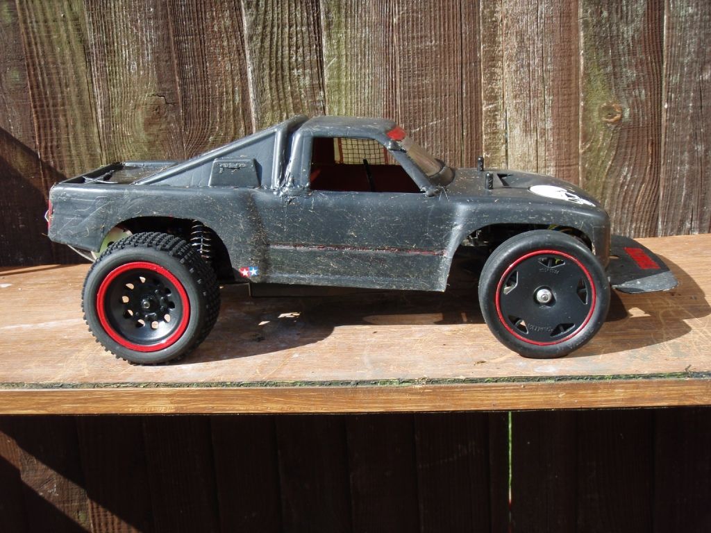

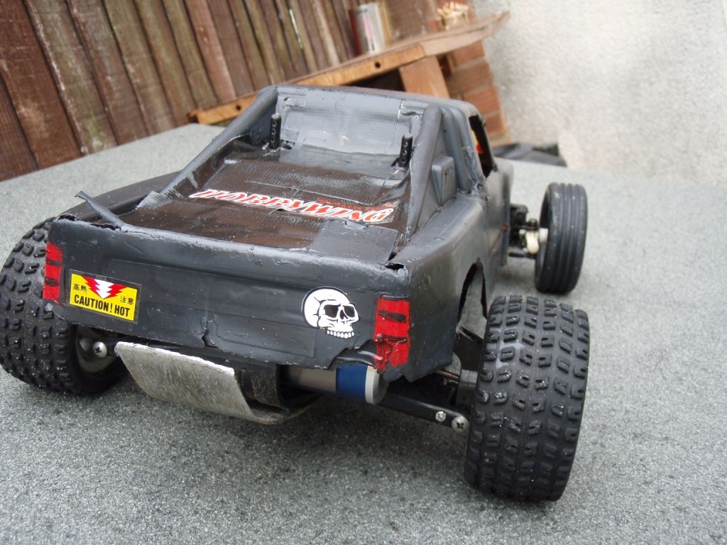

I spent last night repairing the body as best possible, although to be fair its pretty much trashed, applied some poundshop matt black paint! Painted the Gator (DT02) front wheels to match, lifted the back end with slightly softer suspension, and then fitted some TL-01 Alloy oil shocks on the front.
Had some old wheels tyres laying around for the rear (got another pair painted up to match the front, but not dry yet)
Here's the best angle to see the wheel combo:

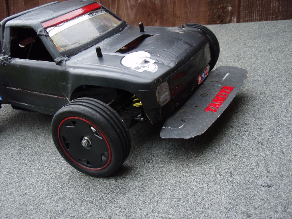

And the front end:

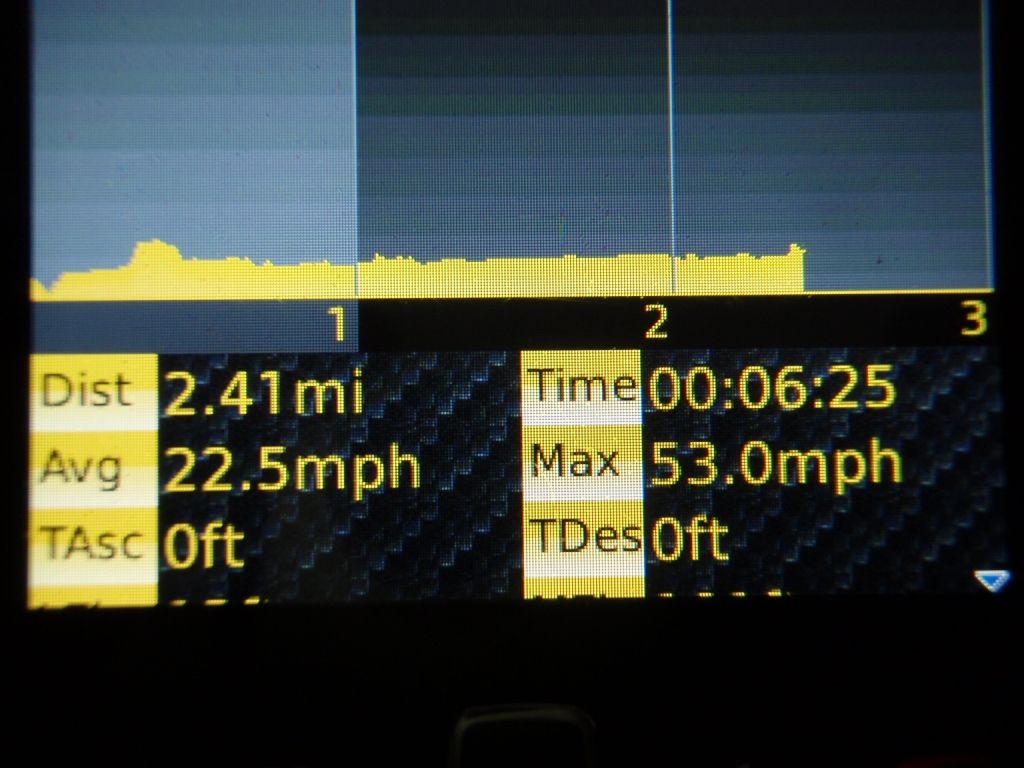

Its been wet all weekend, but though I'd give it a go, and heres the result!
So thats with a 13t and the motor timing on 0..... Very stable once up to speed, no front end lift at all.
Time to order a 15t, adjust the timing and go for 60mph
Much better handling, although it was wet so don't know what it'll be like in the dry. At speed it was solid, it was twitchy on max throttle but I think that was the rear tyres trying to cling on to the wet road.
I'm usuing the standard blitzer uprights with 2 plastic bearings on each side to space it out so the wheel doesn't flap about. I might try with some DT02 ones.
Very happy with 53mph, I think if I get it to 60mph i'll call it a day and lift all the suspension and put the standard front bumper on so I can do some off road bashing. Found a BMX track a few miles up the road, so I might set a new challenge on how high/far I can jump it.

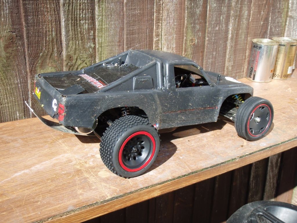

Wearing its new shoes now. (Need to glue them all and re-paint the red on the front)
