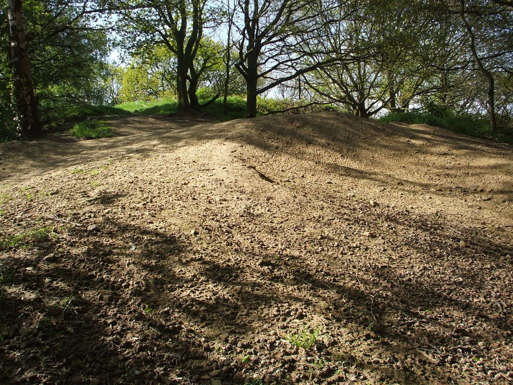

Progress report....After going Dukes of Hazzard with my Dyna Storm on this small patch of woodland near my home......
One of my prototype blocks from Paul broke :(

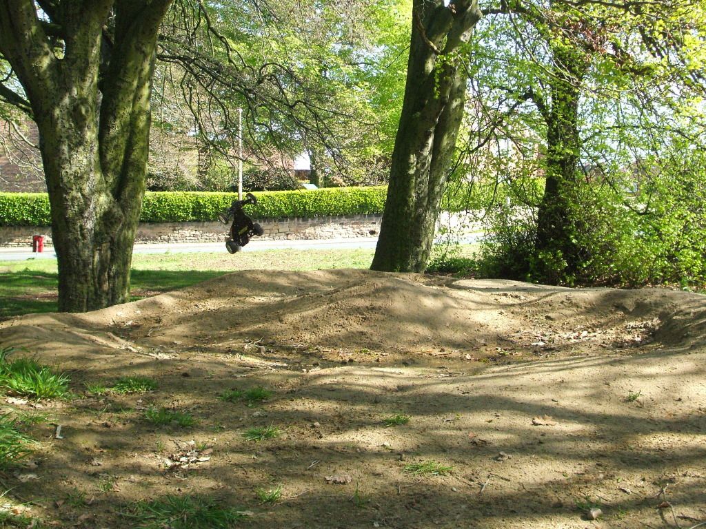

At the time I was running my Dyna with a Acto Pink motor with the timing advanced a little, A Mtroniks Viper RV11 & a HPI Plazma 7.4v 3000mah 20c Lipo. During the course of my little run I had my 7yr old son taking some pictures for me and I was trying to get some decent pics of the Dyna in flight etc so i was experimenting with different speeds & parts of the jump to get a good picture & landing.
On occasions I did give it some beans and everything was going well until in one of my little moments everything went wrong too fast wrong angle etc the Dyna ended up cartwheeling 5 or 6 times down the hill which resulted in the above picture. I do have to add something which I believe had a massive part to play in the block failing where it did, Before my run I gave my Dyna a check over & noticed that both of my rear uprights (C1 & C2) had cracks formed where the screw holds the turnbuckles to the uprights. When the C part failed completely during the cartwheels this in turn put more stress onto the block causing that in turn to fail where it did.

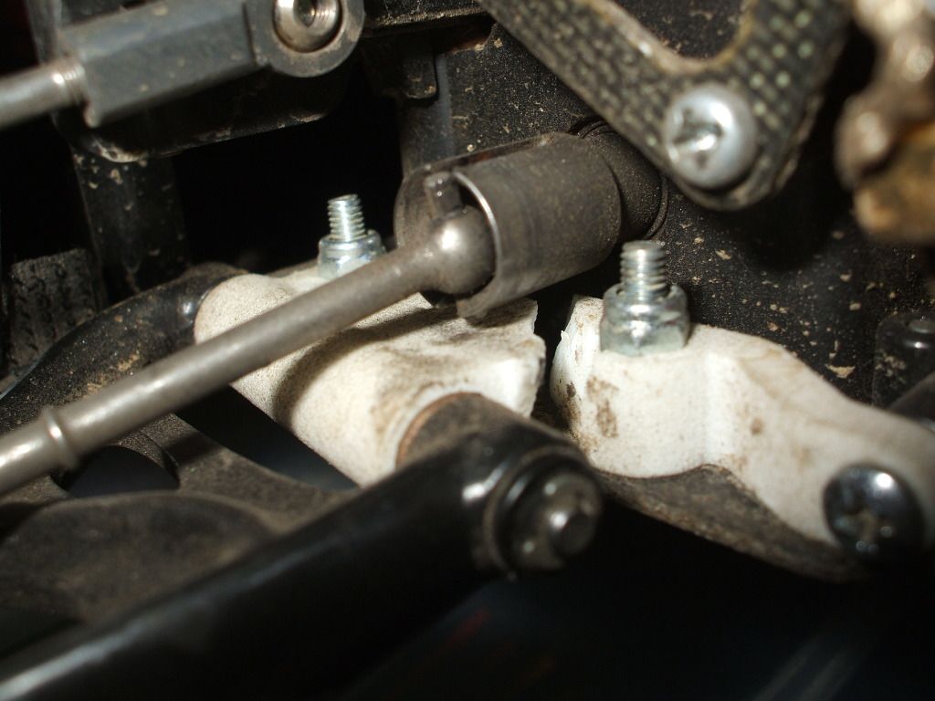

Below is a pic of where the C parts were beginning to fail.
I wish now that I had replaced both my C parts for the set of re-enforced ones I had in my spares box so that I could have given these blocks a fair test but I tend to not replace parts unless they break :(
However hopefully this will help Paul in his designing of this part.
Thanks for posting about this Shanks. It is of course bad news to see the part has failed, but it is good news at the same time. A breakage shows where there is potential to improve the part, and I think I know the cause of this: The sharp corner in the part. Making this into a fillet (a larger one at that) will significantly increase the strength, as the stresses concentrated to that corner in a crash will have a larger surface to be distributed over.

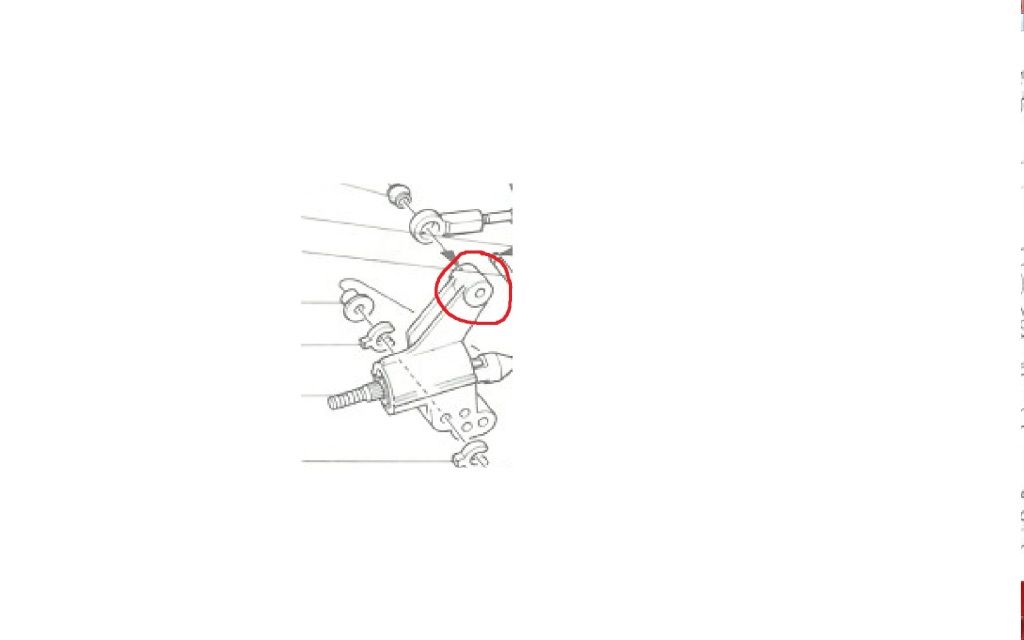

You have reproduced MK1 steering arms. Mk2 had a reinforcement part.
