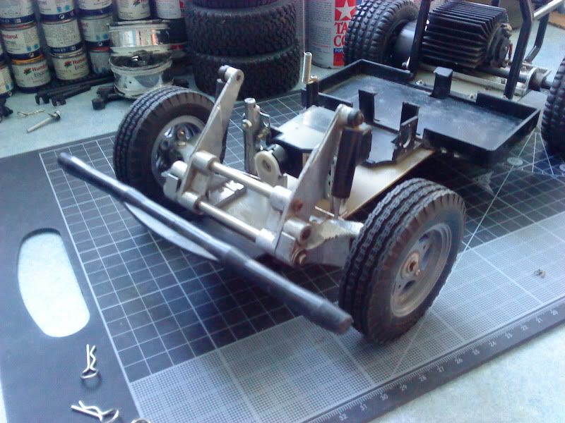

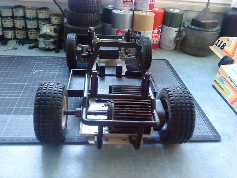

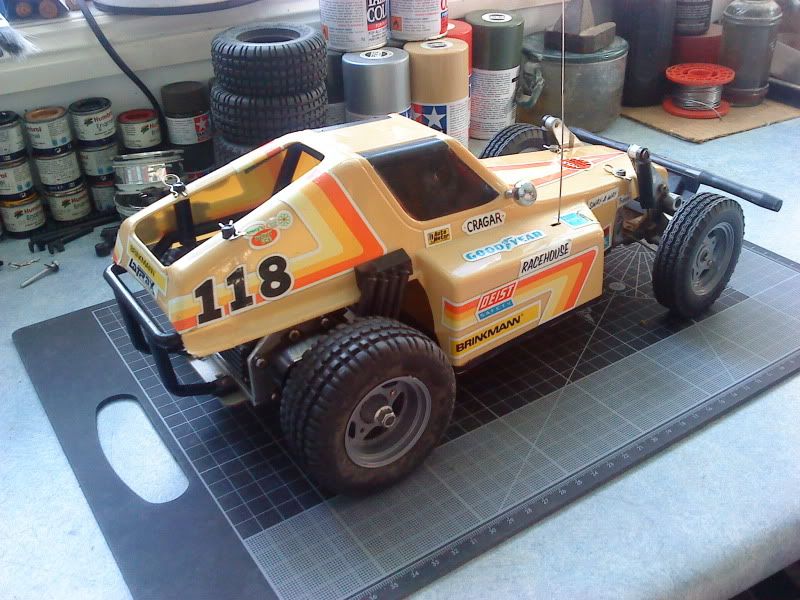

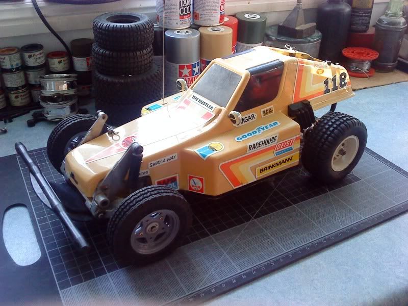

just bought this hustler buggy of fleabay dirt cheap , vintage 1979/80's , it has limited front suspension and none on the rear . tamiya rims fit them apparently , the rear rims are genuine and the front dodgey a/m ones .. the whole thing looks a bit like a tamiya rough rider
should be a clean up to be a nice bit of histroy ..
well , so much for it being like a tamiya rough rider ! . the bearing in the front wheels are small , very small and flanged and imperial ! , on the wheels i have any way . the back righ hand rim was cracked beyond repair and since finding a new/second hand one is like finding hens teeth , i made one up out of a fav wheel . they are very similar in being 3 piece but not compatible at all . i used the front wheels of the fav to replace the ugly spoked jobs after making up spacers to run the tamiya bearings . the servo mount is spaced fora realy wide servo soi had to make up spacer plates to mount a servo to hold the steering in steady . its a very basic car but it came out with an esc way back then so theres a large space in front of the motor mount plate . the steering arms are held on to the hubs by brass collers and attach to the servo saver by 'z' ends . i just have to paint the rims white .

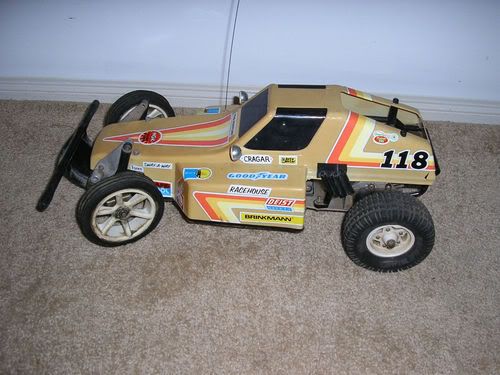

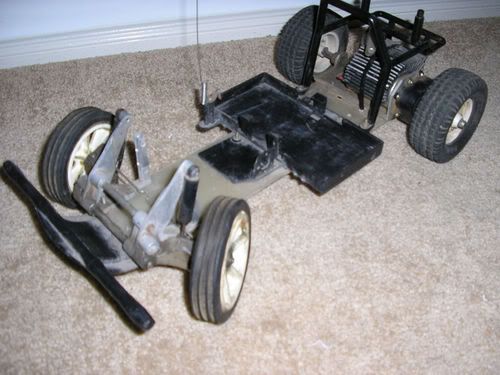

I'm in the process of restoring one of these buggies actually.
Fun fact: LaTrax Hustlers were all originally white (I have the original box for mine). But for some reason, the flexible white polycarbonate-ish (but probably not polycarbonate) body shells have turned light brown with age. Mine looks just like the one pictured above. It gives them a rustic, aged charm...like desert dust. :)
Also, this model evolved a little while in production. I actually have two, and one came with an earlier fully-metal radio with a steering wheel on the front (like an old school Futaba), while the other has a more conventional 1980s plastic radio. The car itself also changed a little. The included 2-piece saddle battery was always fixed in place by plastic ties, but it's a different battery across my two models. Also the heatsinks seem to have changed too.
