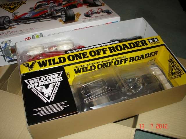

I'm a happy guy!...I just picked up my very first Wild One from my LHS.
Of all the re-releases, this is pretty much the only one I really wanted, it just looks so utterly awesome, just the way a buggy should look :wub:
I also picked up a "torque tuned" motor to replace the kit motor and I think that's about as much motor as I'll put in it.
I'm in the process of building it right now and so far it has been enjoyable...just taking a break...I ran out of 850 bearings! :wacko:
