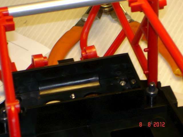

Many of the screws specified are LONGER than the hole they fit into so they stick out the other end,
just about whole kit now uses 3x12mm when 10mm could've sufficed.
Most probably won't cause issues... except for this location - poking into (vestigial) battery box:-

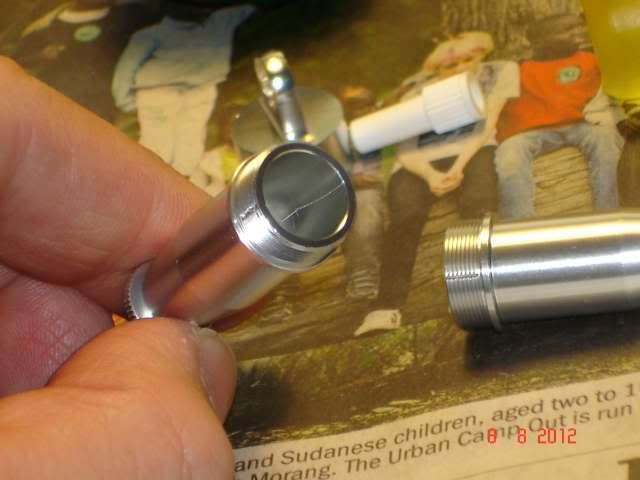

Worst QC fail is in the alloy rear shocks...
both rear shock cylinders have a deep score, looks like CNC tool has crashed into it badly
wow that's pretty awful. Makes me value my WO resto project even more. I wonder if the damper problem is consistent or if this is an isolated thing. Also, I wonder if there are any hex screw sets for this kit. I saw someone built their kit with individually purchased screws but that seems a bit a tedious. oh well.
unfortunately the shock bodies are hidden away in the sealed inner box,
so can't easily inspect all kits without breaking the seal
i substituted most of the screws with stainless hex buttonheads
although majority of the screws are supplied as M3x12mm,
like half of them are too long so i used shorter as possible
