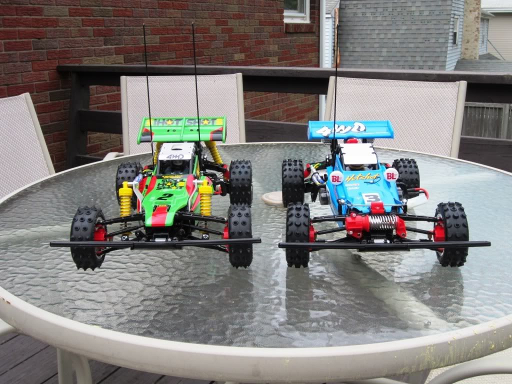

shenlonco 1156 Posted May 9, 2012 Well this is my Supershot and my brother in laws hot shot we purchased the kits and both built them at the same time. Enjoy. Share this post Link to post Share on other sites
markbt73 5290 Posted May 10, 2012 That Hotshot is exactly the same color as mine. Share this post Link to post Share on other sites
shenlonco 1156 Posted May 10, 2012 That Hotshot is exactly the same color as mine. Well It's a great color for this buggy! Share this post Link to post Share on other sites
matman 1498 Posted May 10, 2012 I have the original supershot with that Green color . Very nice color that green . Share this post Link to post Share on other sites

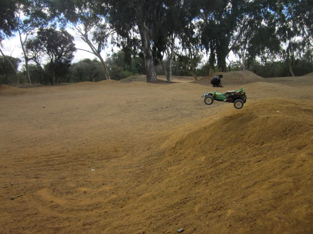

Thommo 1201 Posted May 10, 2012 I have the original supershot with that Green color . Very nice color that green . This one Green is good guys and I dig the blue Hotshot too. Share this post Link to post Share on other sites
shenlonco 1156 Posted May 10, 2012 Thanks guy's! Thommo nice shot that place looks awesome to ride rc's!! are you running the stock tamiya oil in the shocks? Shen Share this post Link to post Share on other sites
Thommo 1201 Posted May 11, 2012 Thanks guy's!Thommo nice shot that place looks awesome to ride rc's!! are you running the stock tamiya oil in the shocks? Shen Hey Shen, that actually is matman's original Supershot so he is the man re your shock oil question. Thanks for the up. That shot was taken at our first West Aussie TC meet here in Perth a few weeks ago. Check out post #136 page 6 in the Perth WA thread in meetings and events for more flying Supershot pics. It turned out to be a bit hard on the cars but yeah, it is a great location and very typical Aussie scenery (eucalyptus trees and dirt) Share this post Link to post Share on other sites
shenlonco 1156 Posted May 11, 2012 Hey Shen, that actually is matman's original Supershot so he is the man re your shock oil question.Thanks for the up. That shot was taken at our first West Aussie TC meet here in Perth a few weeks ago. Check out post #136 page 6 in the Perth WA thread in meetings and events for more flying Supershot pics. It turned out to be a bit hard on the cars but yeah, it is a great location and very typical Aussie scenery (eucalyptus trees and dirt) Cool Will do. Thanks Share this post Link to post Share on other sites
Tamiya Era 778 Posted May 11, 2012 Great,,,if u give to ur brother-in-law the white wheels which comes with super-Hot-Shot, then it will look Super great on his HotShot Share this post Link to post Share on other sites
shenlonco 1156 Posted May 12, 2012 I have to agree, what a fantastic place to run them. So how much faster is the Supershot compared to the Hotshot in a drag race? Assuming you've had a little head to head? I think the GT Tuned is pretty much the same as the original Technipower was in rpm/torque and the new 540 in the Hotshot about the same too. Would be interesting to see Well have to drag race em and see. Share this post Link to post Share on other sites
pastimesteve 49 Posted May 12, 2012 Shen -- I've always been a big fan of the box art red on the Hot Shot, but that blue looks fantastic. Great job on both builds. Steve Share this post Link to post Share on other sites
