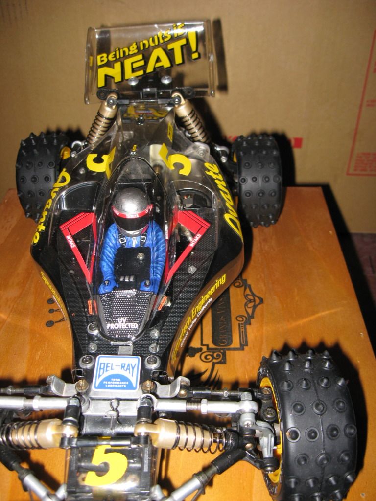

Search eBay for Autosmart Tardis. It's a car valleting product designed to remove tar deposits. I did an old vanquish body in ten minutes Sunday night (apply to cloth, rub although I've left it soak on an upturned shell for ten minutes before now. I dud an original avante body a month or so back in similar time. A Durga shell took best part of 5 hours on and off - the White paint came off in seconds, the metallic orange took forever!. My egress restore also got similar treatment, that one took a few hours in total -again different coloured paints took different times to dissolve.
I've used this stuff on at least four shells without no adverse effect -just ensure you wash the shell in soapy water before why repainting.
There are pics of the egress shell in my rebuild/restore thread. I can post a pic of the avante if you want as that is still naked. I retained the original decals on the egress, vanquish and avante by not exposing the outside to the chemical.

This was the original Avante as i received it, not sure how old the shell was but certainly it had been painted for many months if not many years...
and after stripping the shell with Tardis (total 15 minutes for the shell and wing) - original decals unaffected...

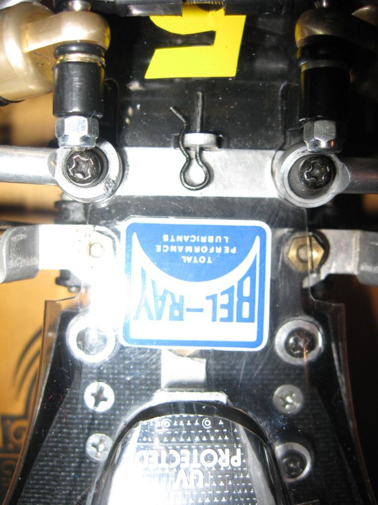

no fancy trickery with photoshop, straight out of the camera. Close up to show no effect on the lexan...
Original Egress shell, painted back in the day, part stripped..
fully stripped...
and repainted, not bad for a shell over 20 years old (ditto the undercowl and wing)..

This was the original Avante as i received it, not sure how old the shell was but certainly it had been painted for many months if not many years....
