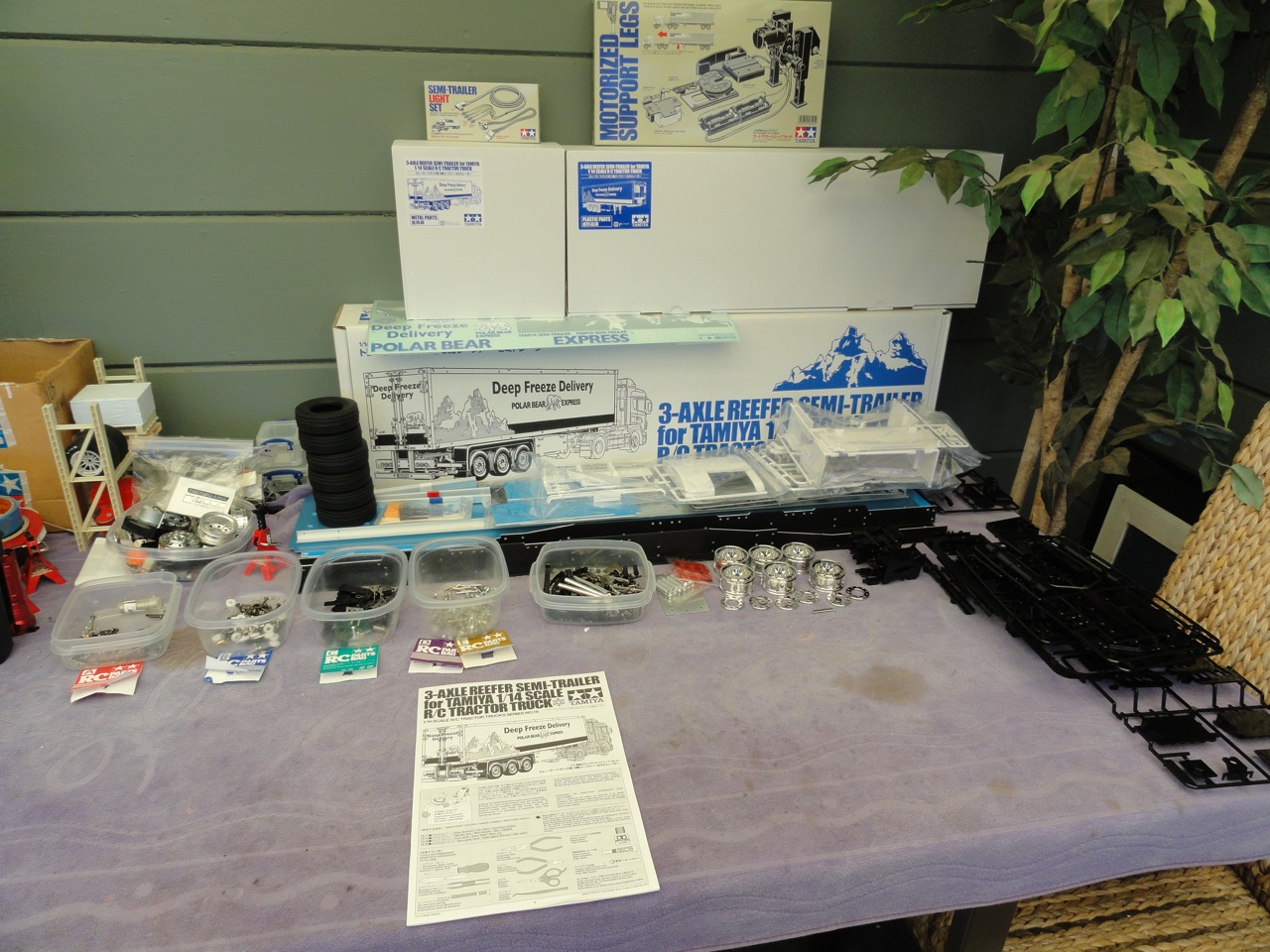

Skottoman 306 Posted June 28, 2012 Ok, so I was convinced that I needed a trailer for my "Hugger Orange" Scania. Reefer it is! (Just fun to say "Reefer") Will be matching paint colors to the Scania. I bought 12 cans of paint/clear/primer! Thread to document build as I get to it... The goods (Minus paint) Share this post Link to post Share on other sites

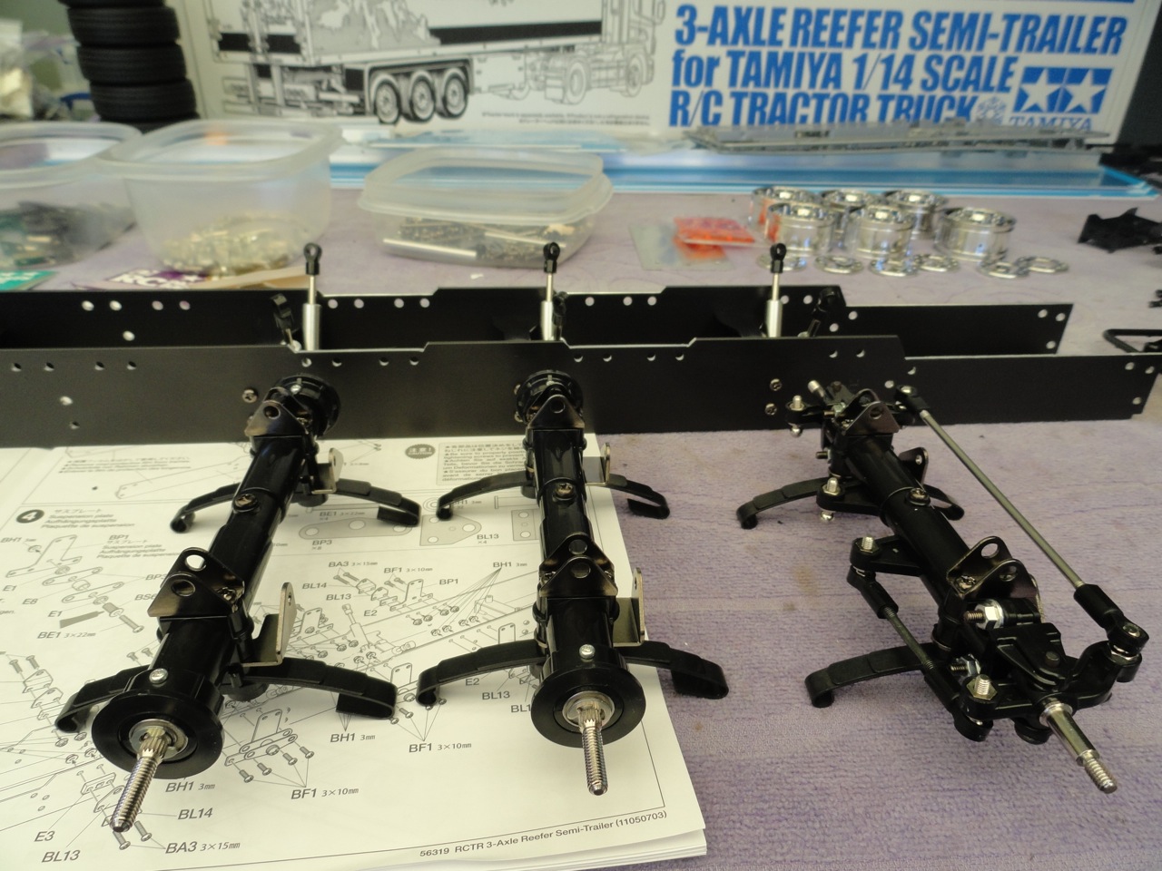

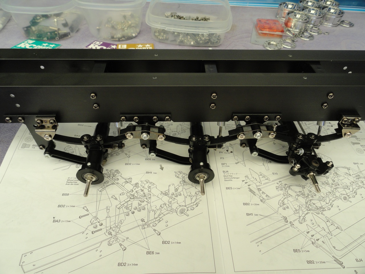

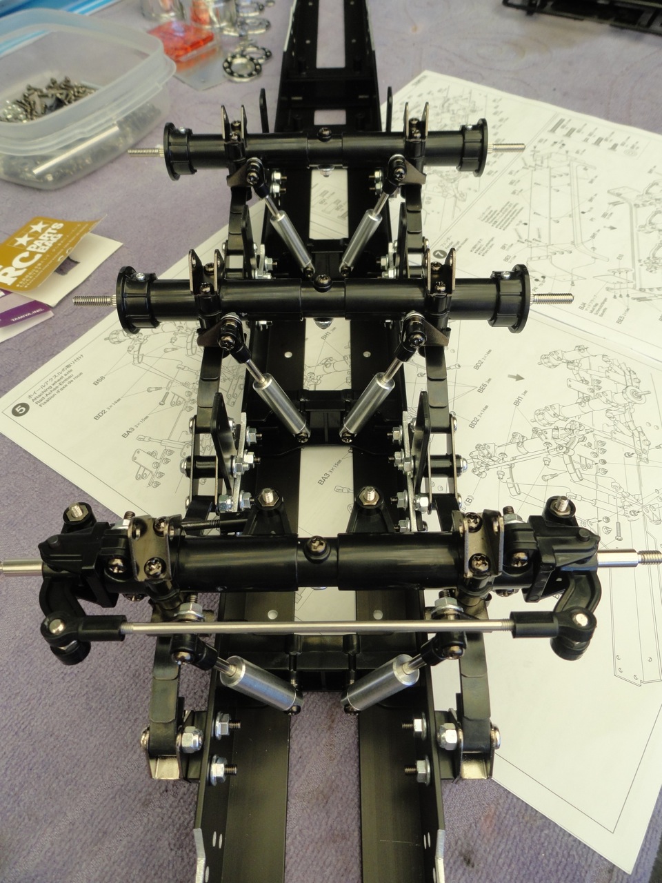

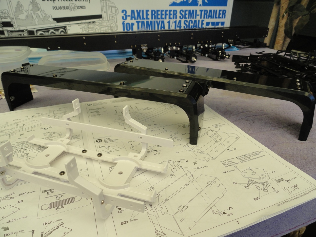

Skottoman 306 Posted June 29, 2012 Started the build... This is kind of the boring part until I get to PAINT STUFF! You'll notice the 3rd axle is setup for steering. Manual has instructions to lock, so you could get creative like TC member Ant88, and build a servo tray for rear steering. I am not going to do that. Share this post Link to post Share on other sites

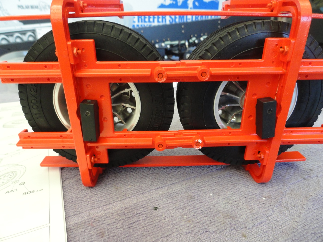

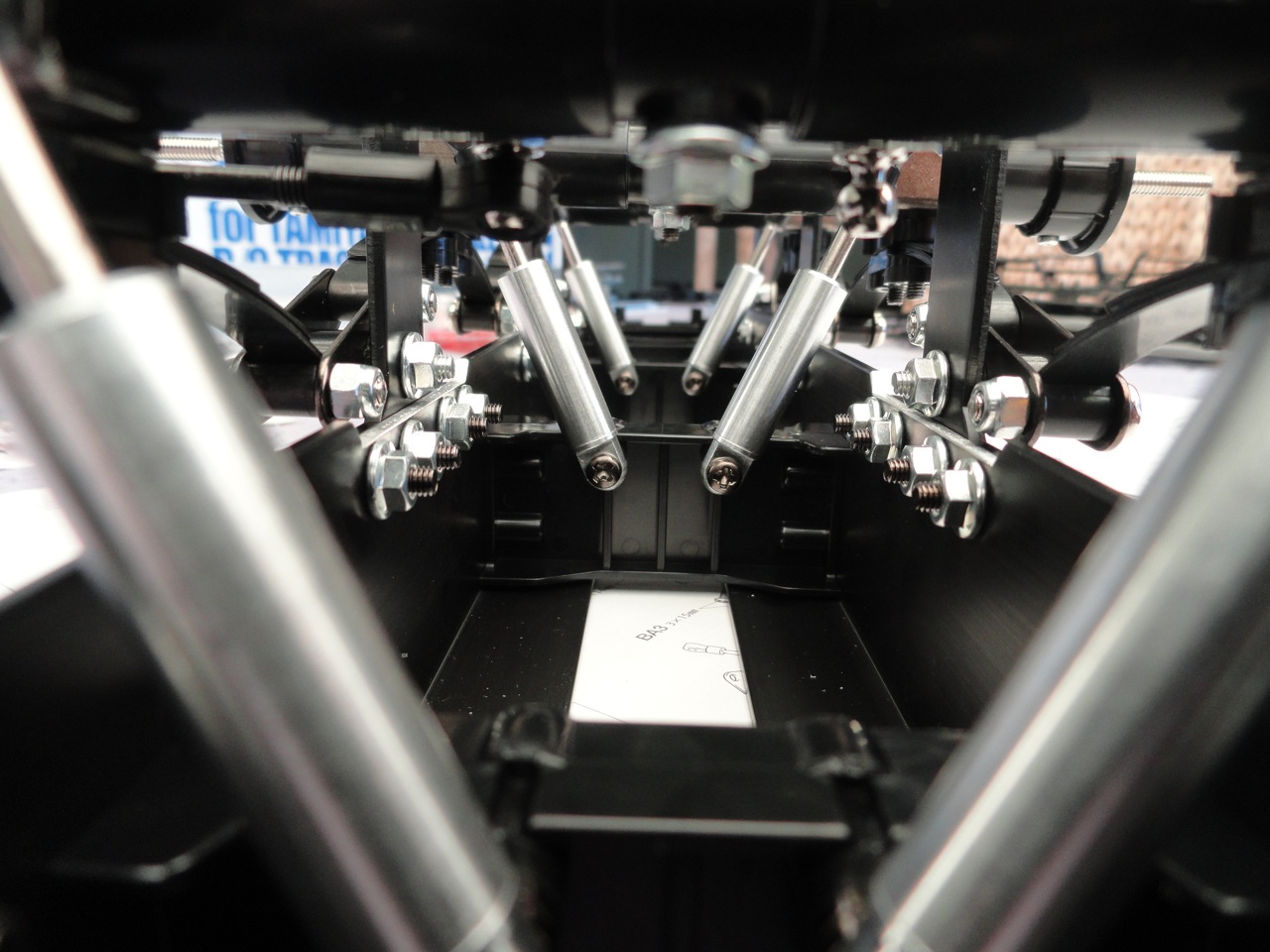

Skottoman 306 Posted June 29, 2012 TONS of screws/nuts on this thing... Basic suspension complete. Now I have to start painting bits before installing... Wooohooo. Bring on the ORANGE. Share this post Link to post Share on other sites

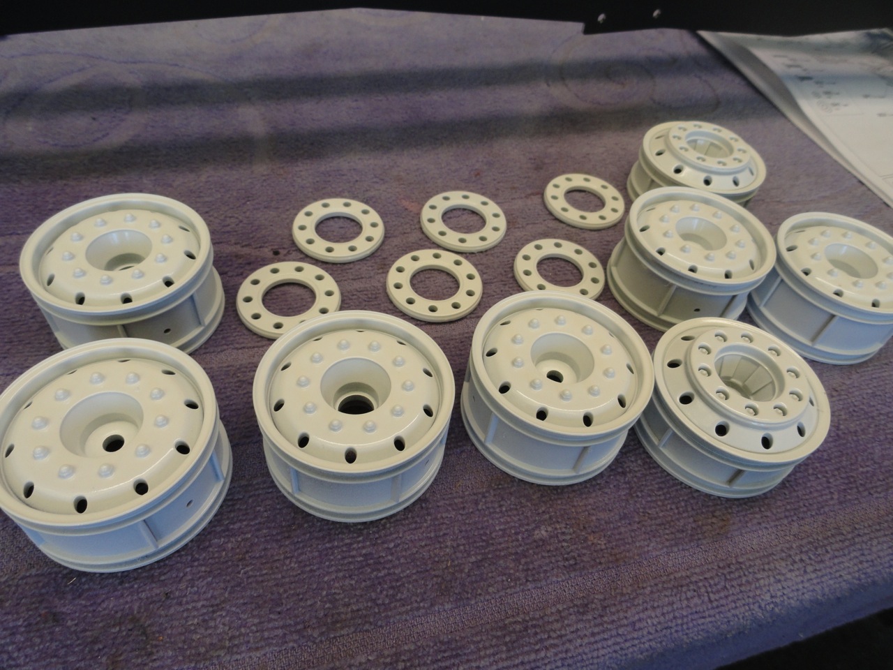

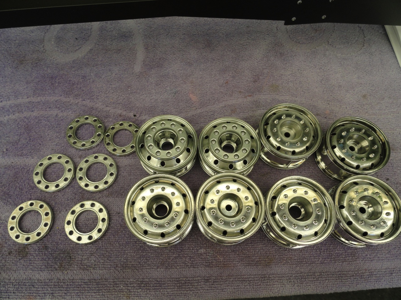

Skottoman 306 Posted July 1, 2012 Haha... #3 truck will be a Mercedes 1850L. I'm making the reefer to fit the Scania, as it's euro, and the flatbed will fit the Knight hauler... No, the reefer does not come with any servo mounts... But it's nice that the rear axle is steerable if you want to get into that... Wheels white to match the Scania. Steel wooled, then primed and painted, and clear coated... (Plus the 2 spares). A little blop of flat black on the wheel nuts, before putting on the trim rings... I tried the bleach method of removing the chrome before painting, but for some reason it did not work at all on these wheels. I've done it successfully in the past on other parts... Share this post Link to post Share on other sites

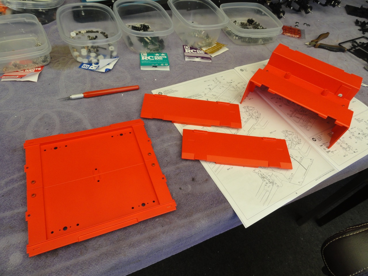

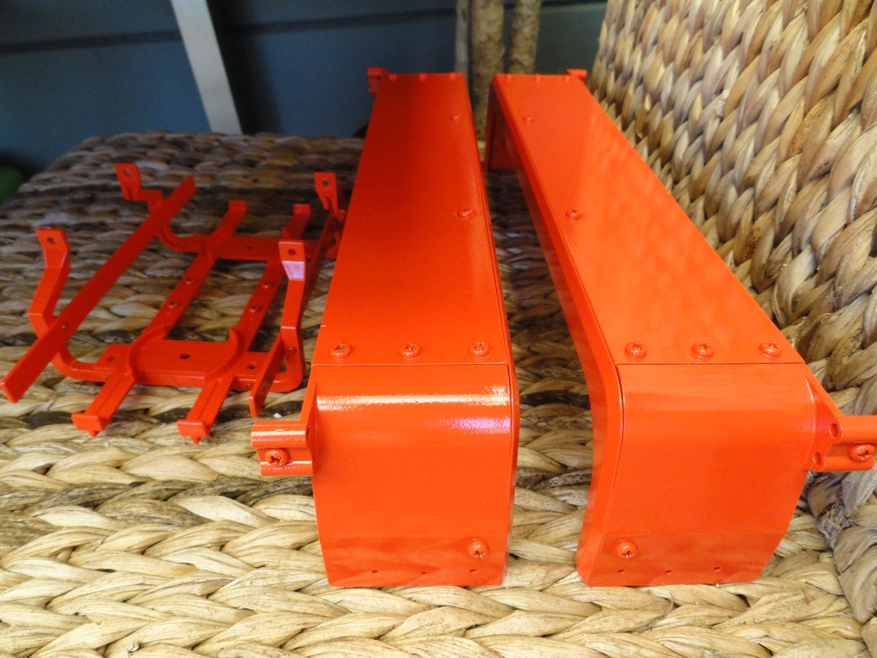

Skottoman 306 Posted July 2, 2012 Fenders, and spare wheel holder... Primed, and painted orange. Waiting for clear coat. Share this post Link to post Share on other sites

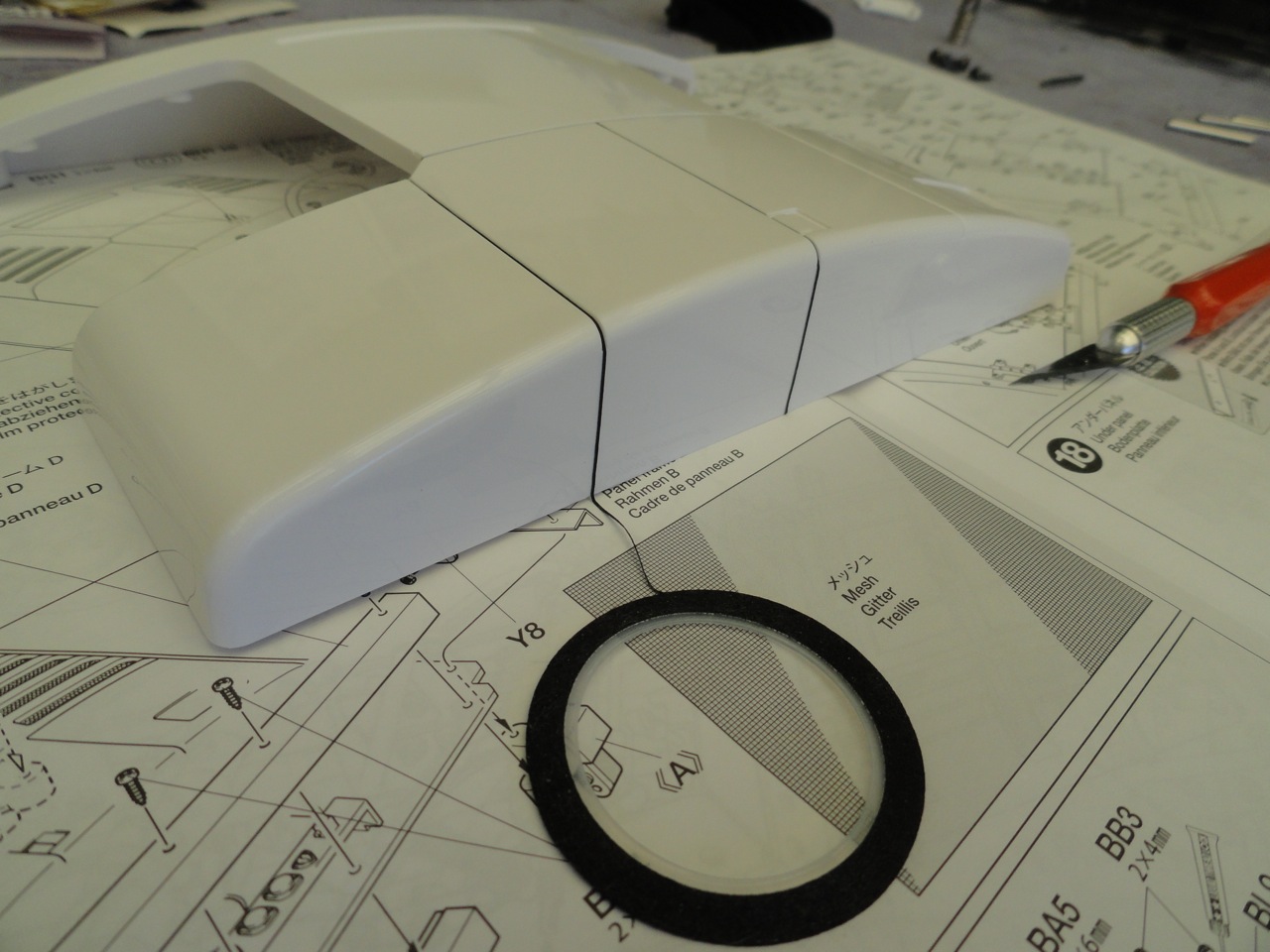

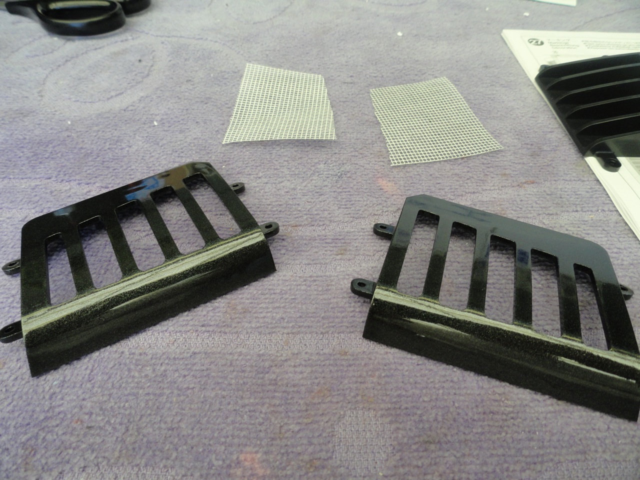

Skottoman 306 Posted July 2, 2012 More orange, and some detailing on the "Reefer" unit. Using same paints and grills as the Scania. Got the ThermoKing stickers from ebay, and using micro line tape for the panel lines... Share this post Link to post Share on other sites

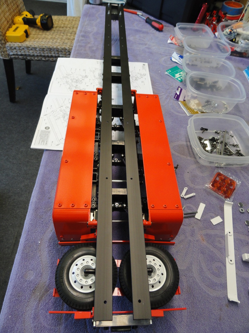

Skottoman 306 Posted July 3, 2012 It's an actual trailer now... Share this post Link to post Share on other sites

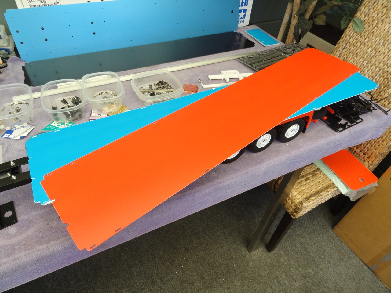

Skottoman 306 Posted July 3, 2012 So many parts to paint... So many LARGE parts to paint... And then again with clearcoat! Need lots of space to lay everything out... Share this post Link to post Share on other sites

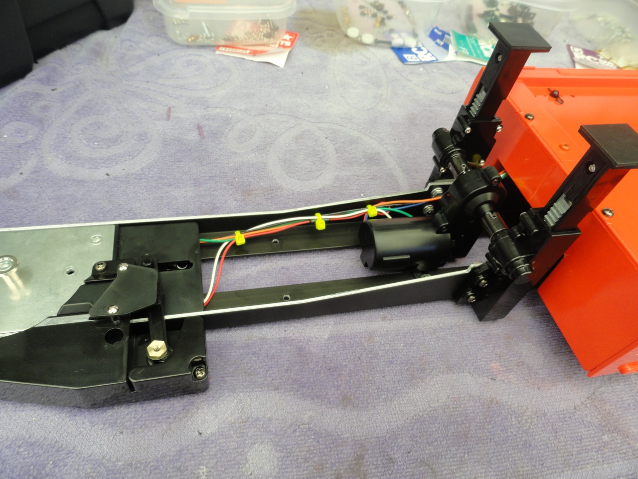

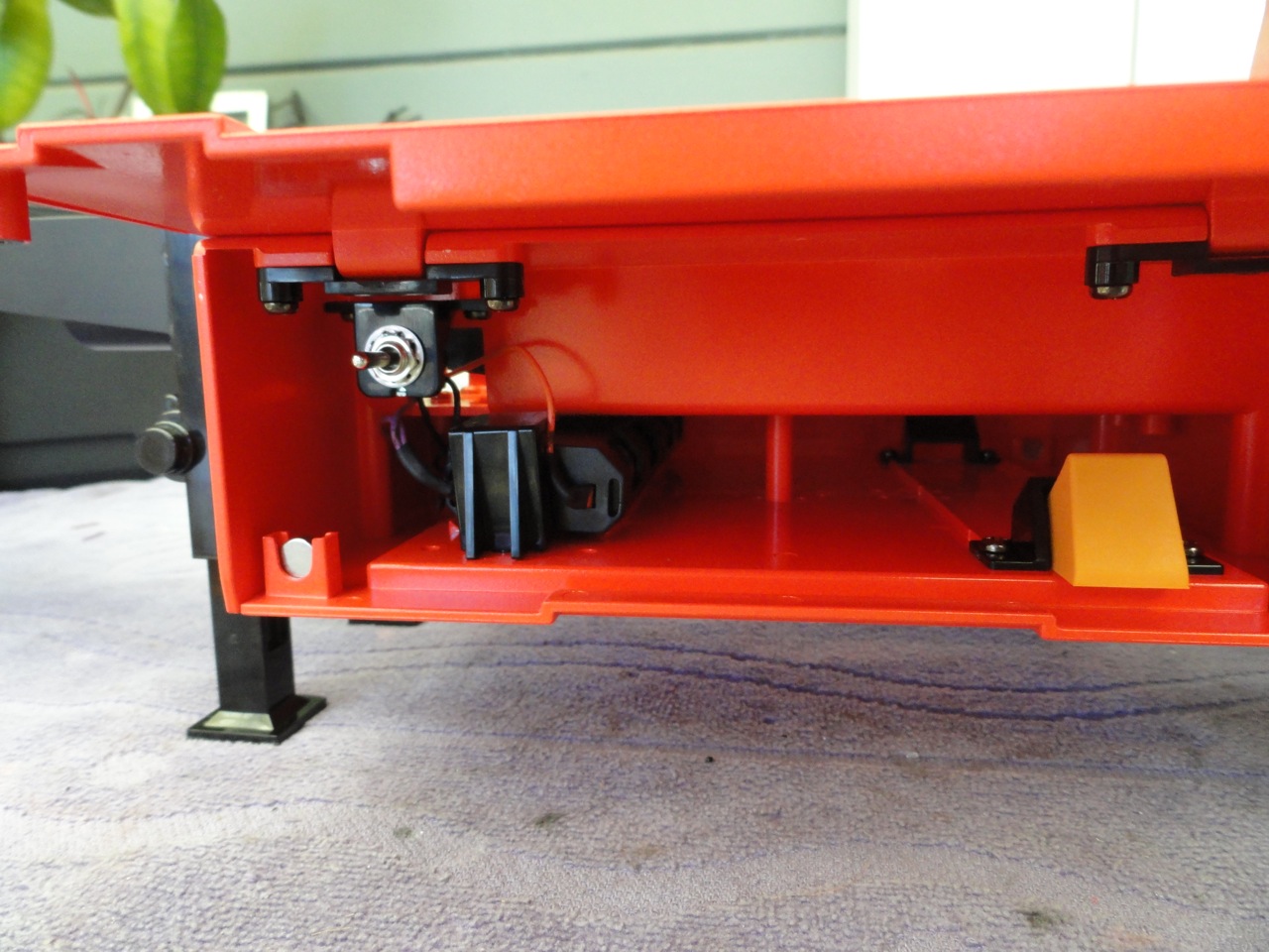

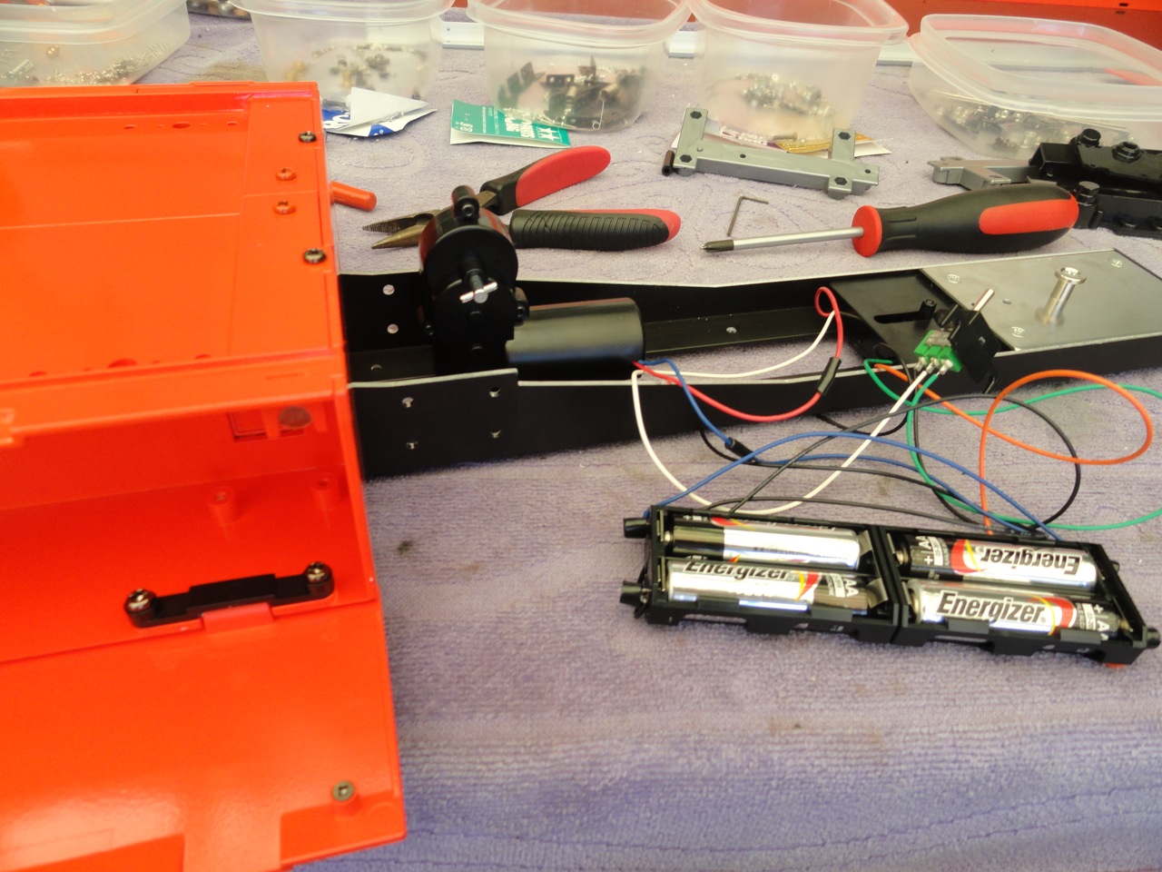

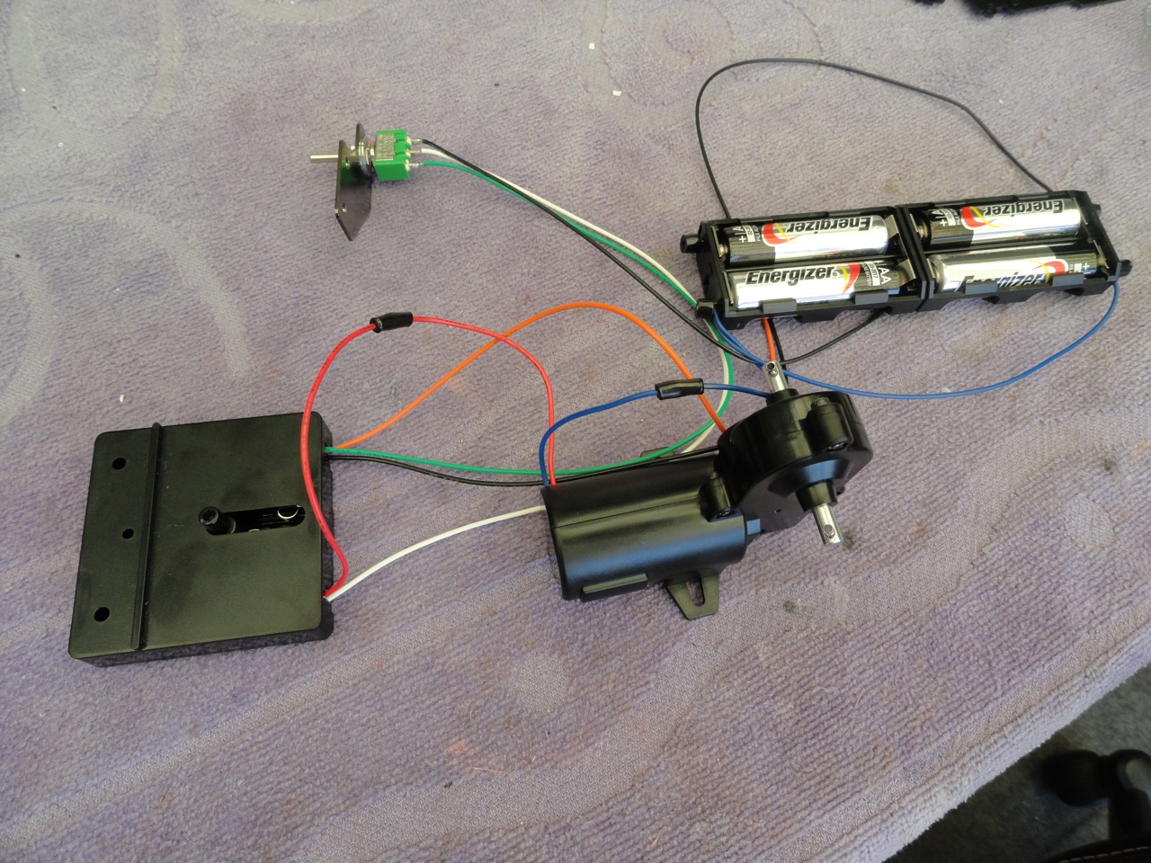

Skottoman 306 Posted July 11, 2012 Ok, getting into the electrics now... What a pain. The hard part is the instructions are not clear between the ones included with the trailer, and the ones included with the motorized legs. I have done the motorized legs once before, but this time it's more difficult. The #1 problem here, is I built up the parts and wired them, but now I have to unwire them so I can fit the batteries into the storage compartment. Not a big deal, and if I'd studied both sets of instructions I could have avoided this mistake... still building, little at a time. Also, got another shipment of Testors Wet Look Clear Coat, and more Testors Metallic Blazing Black. Lots of clear and black/metallic black to spray still! Share this post Link to post Share on other sites
Skottoman 306 Posted July 11, 2012 Motorized legs completed. Switch and batteries are hidden in the storage bins. Share this post Link to post Share on other sites
VTRSP1 10 Posted July 12, 2012 Skottoman, the reefer instruction ask that the batt and switch be place inside the storage compartment or you mod it? Very neat. Share this post Link to post Share on other sites
Skottoman 306 Posted July 12, 2012 Skottoman, the reefer instruction ask that the batt and switch be place inside the storage compartment or you mod it? Very neat. The instructions say to mount the battery and switch inside the storage compartment. My problem was, if you follow the motorized legs instructions, and wire everything together, you have to pull it all apart again. The Reefer kit does come with a few longer wires in order to install the battery and switch in the compartment, as well as a few mounting bits. The battery is held in with clips, and can easily be removed to change batteries.Still so many details to do, and lots of clear coat and paint to go... This is a HUGE kit! Share this post Link to post Share on other sites
