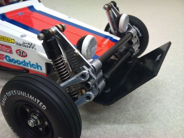

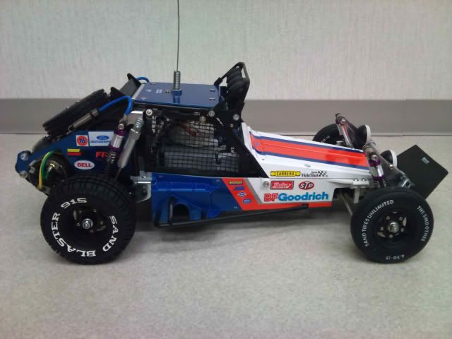

That is tremendous. You've gotta love the FAV. Not only is it great in standard spec but it has vast potential to be so much more. :)
I seen those before they are sweet.
it's not a fast attack it's a sand scorcher chassis under the FAV body.
Its a FAV w SRB front, not SRB chassis under a FAV body.
That thing is awesome. Maybe an idea for my next FAV... It really is some nice work. If it were me though, I'd have painted the motor and wires flat black to disappear and give even more scale look.
Still incredible!
Cheers,
Skottoman

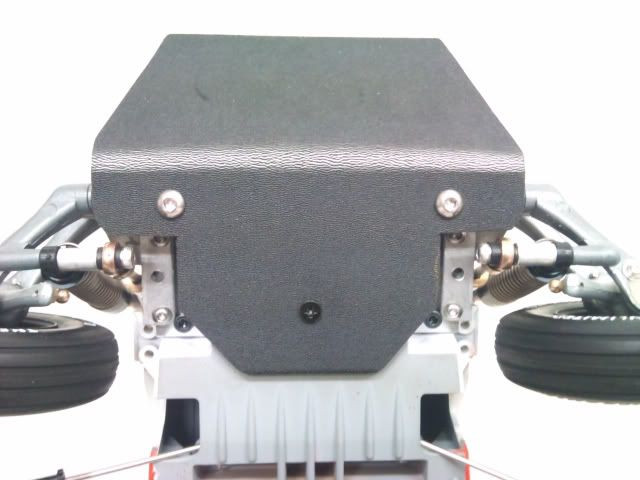

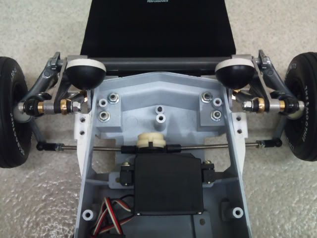

Wow it is just the front that's neat!! Wonder how strong it is bolted on like that?

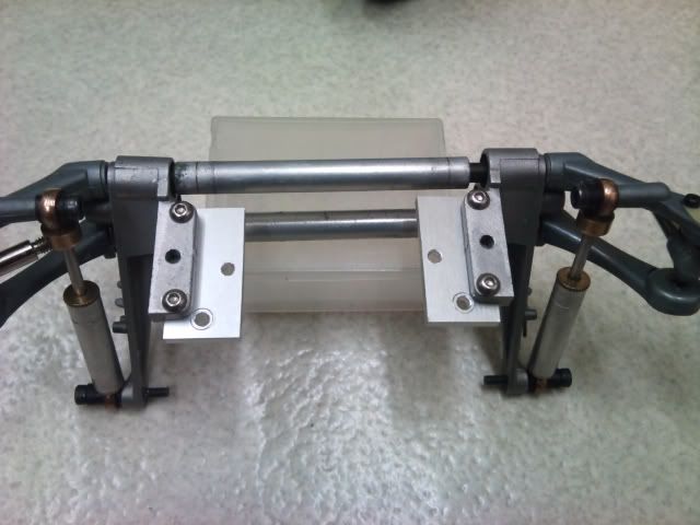

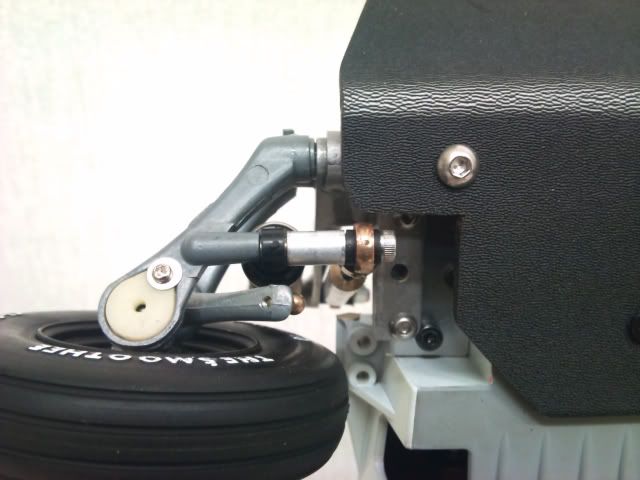

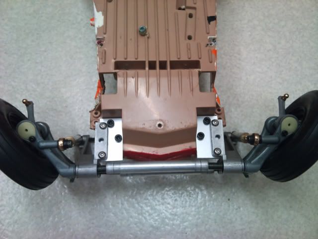

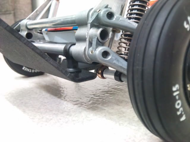

Here's how he did it.
It looks to be stronger than the original damper towers which are just two screws in from the top.
It does appear to be mounted a little too far forward which wouldn't do nice things for the steering geometry and it makes it look 'long'.
