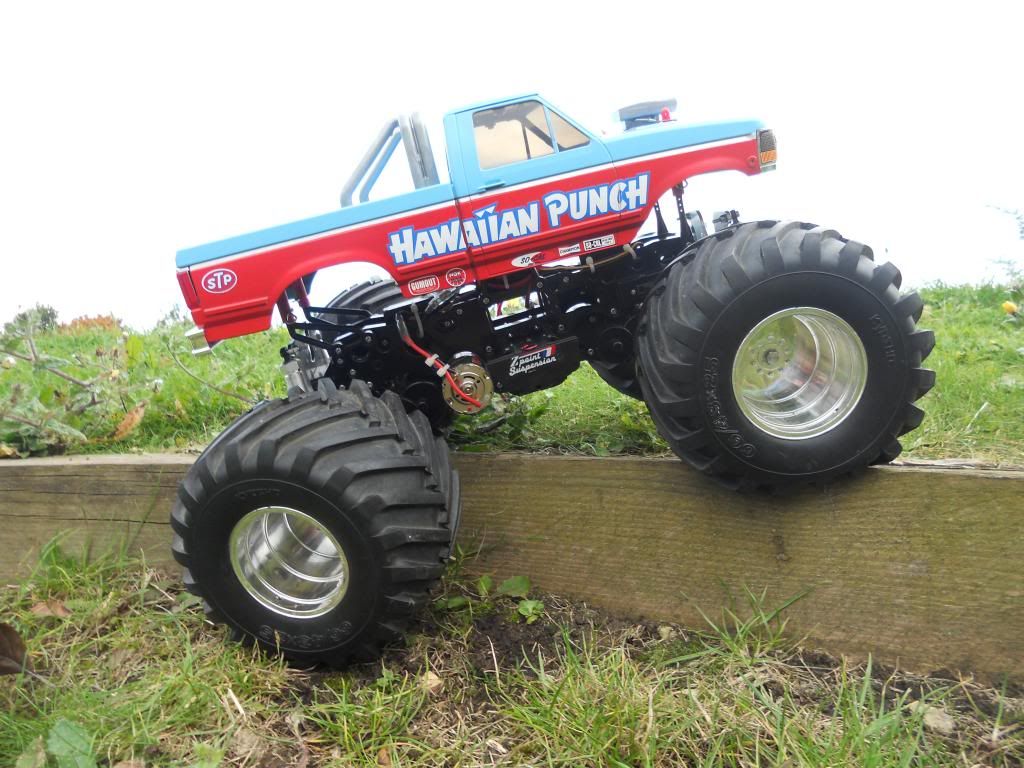

This is a beast!!!
Max
Its a Beast alright :lol: . It weighs more than any other rc i've ever driven yet performs really well . Its also very stable with the wheels actually being wider than the length of the body .
Looks great bromvw. Id love to see some "topless" pics and a running vid, bet it's a hoot to drive.
I'll see what i can do . Bit limited by the camara we have

Thats no problem with me :D . IMO this is a cheaper way to build a monster . I'd say its not as capable as a TXT but certainly a match for a Jugg

i used blackfoot extreme CVD's from 3racing . So far they have held up ok. To extend the axels in order to fit the big rims i had to use 19mm hex extenders . I used some blue thread lock to ensure they dont come lose .

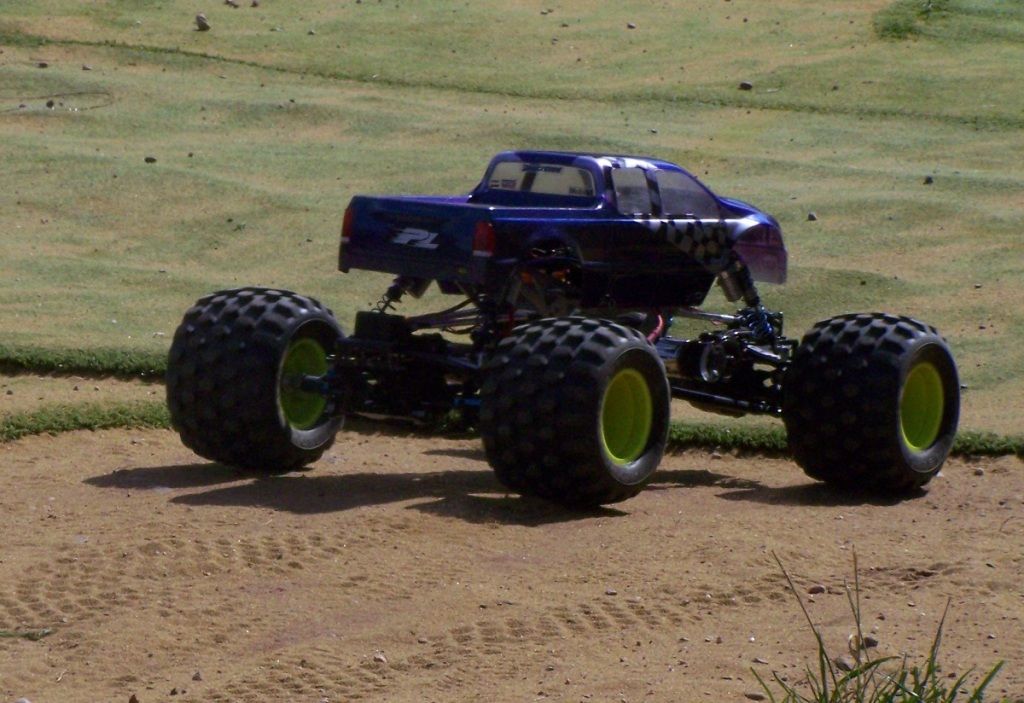

Do you have a picture of the truck sitting on a flat surface? I want to see what angle the A-arms are at to compare to my BFX.. I have acquired a set of larger wheels to see if I can make a monster as well. I just hope I don't break anything.. LOL

Jeff my laptop crashed last weekend and i lost all my photos . I'll try to take some shots asap but i'am on nights till the middle of next week . The adapters are the issue as you say . Then you will need hex extenders - give fussion a look . With the alloy shock tower extenders and other alloy suspension parts i used ( GPM parts from asiatrees ) the A arms sit at a resonable angle . Glad you like it Jeff .

Mock up to how mine might look:
thoughts?
Little dampers are there for now.. only can do so much at a time

I got around the gearing issues with 55t crawler motors . they seem to be fine temp wise .
