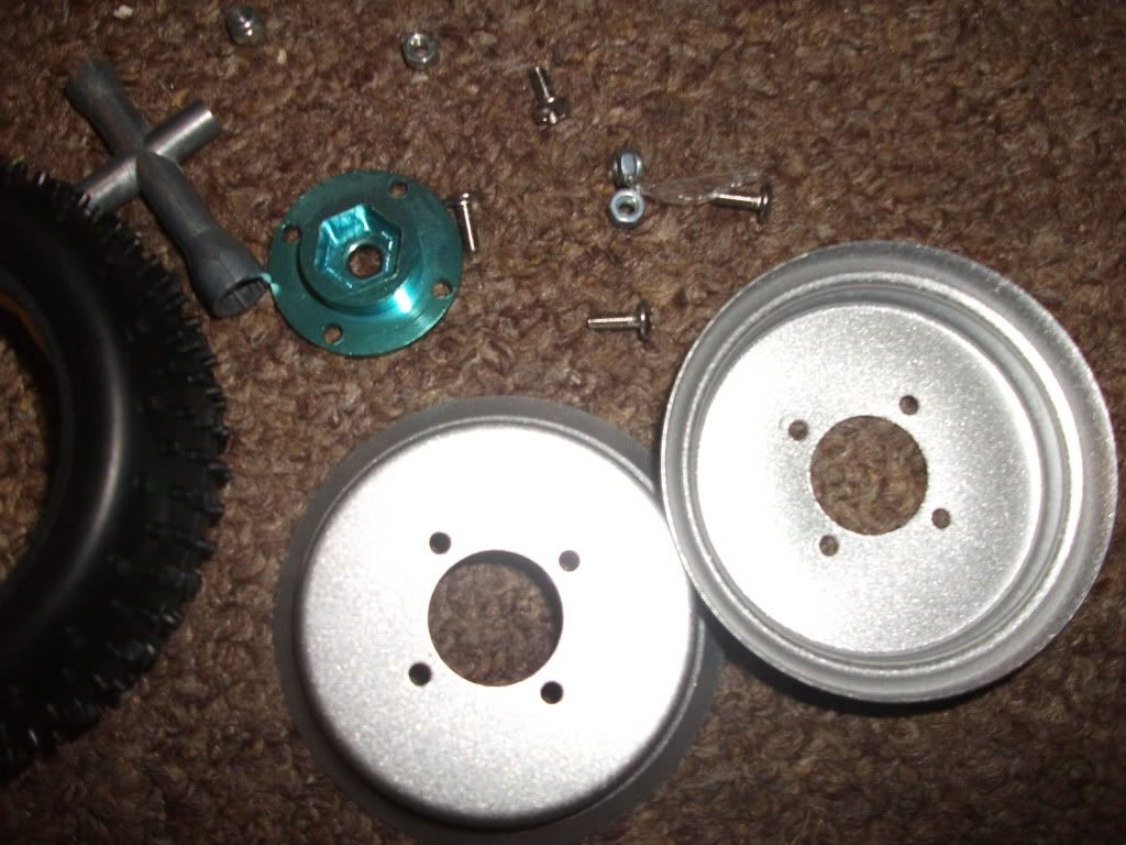

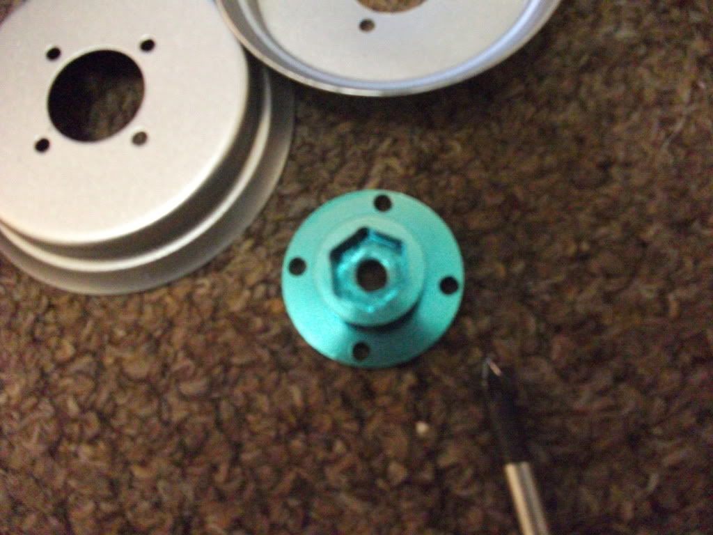

Here's the wheel as photobucket is working again.
I was hoping for a replacement for the blue bit with a bearing carrier instead of a hex fitment but it's never that easy.
One of the easiest ways now to fit 12mm hub wheels on fronts is to grab the new associated SC10 front parts.
steering block #9880
axle #9881
you'll need 4 bearings 3/8 od and 3/16 id
@Willychang, that sounds easy, I will have a look at sand scorchers wheels, thanks for that.
@Billg4, thanks for the part numbers, that sounds easy as well.
@Commiedoor, thanks for the link, I did look at that before, that is an awesome truck and a massive change to the Hornet, that must have took a lot of imagination, I will go and have another look at your thread.
