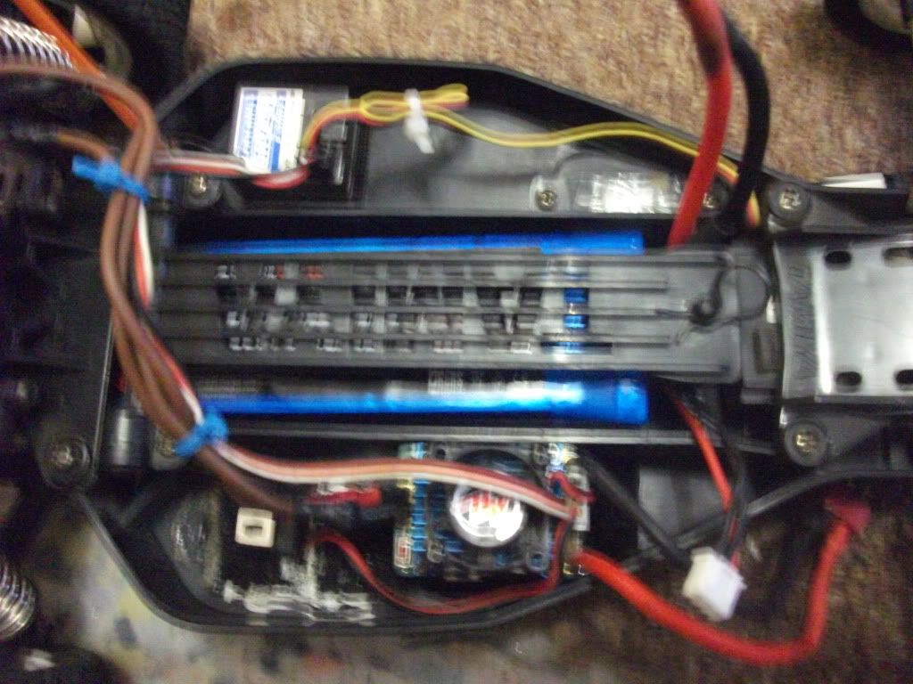

Wolfdog, I'd put a thin sheet of rubber under and over the Lipo to hold it tighter or it could short internally due to shock impact, plus it prevenst the heatshrink wearing through. It doesn't take much to split in a buggy or a car jumping all over the place, then the battery is useless (and potentially dangerous). Scratch this, just read the other thread, see you've got it covered there, lol.
I broke one like this in a Kyosho buggy.
Anything battery exposed I use hardcases, either yeah racing or HPI plasma round cases, they are a few mm longer but perform so much better, and I fit a dummy plug onto the chassis to hold the balance plugs or cable tie them up out of the way, (again, found out the hard way by having one come out and dragging down the road and destroying the plug)
If I can stash it out of the way, Turnigy Nano-tech soft cases from Hobbyking, cheap, available in any size you want, and usually delivered within a week. and I pad out mine to stop and movement or use Axial battery mounts with the foam pad and velcro straps to secure them.
