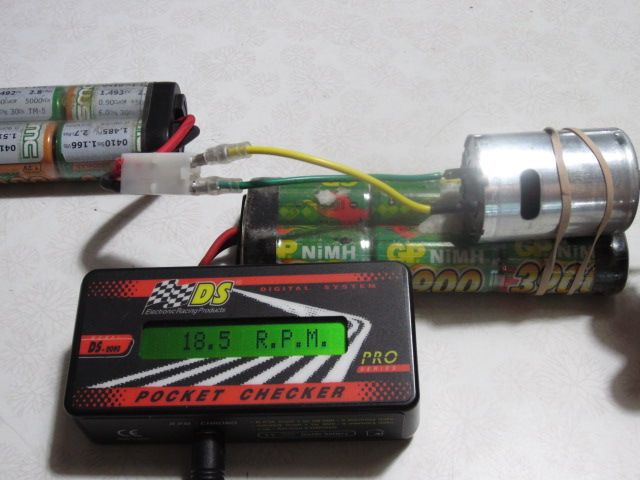

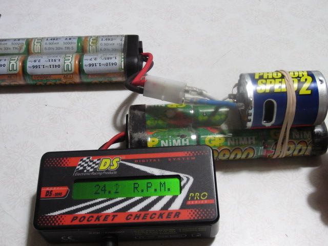

OK i did a RPM test used a freshly charged 6 cell pack
the duratrax motor as seen in the photo 24,200RPM
and a stock tamiya kit silver can 18,500RPM
So the same test shows with the duratrax photon speed 2 motor it gives you 5,700RPM over a stock tamiya kit motor..it also has much more tourqe.
:D So for a $11.00 motor shipped it's a great hop up in my opinion you can't go wrong with it at that price!
