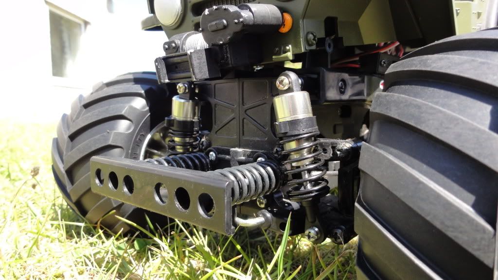

Hey Rob - you are right ! - the photo isn't the best, but the shocks fitted don't look stock for sure. Will see what arrives, especially given that I can already see a non standard ESC, RX and the tyres are fitted backwards !!
