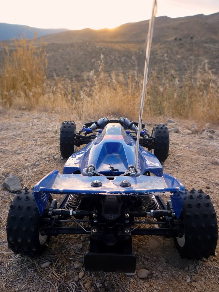

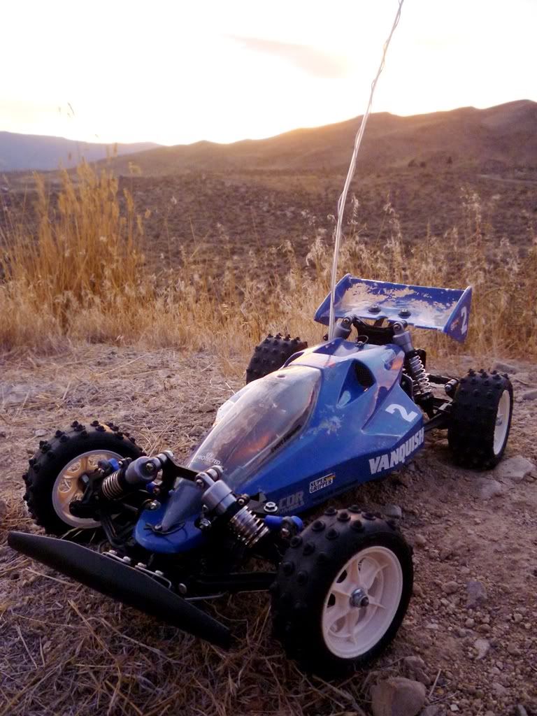

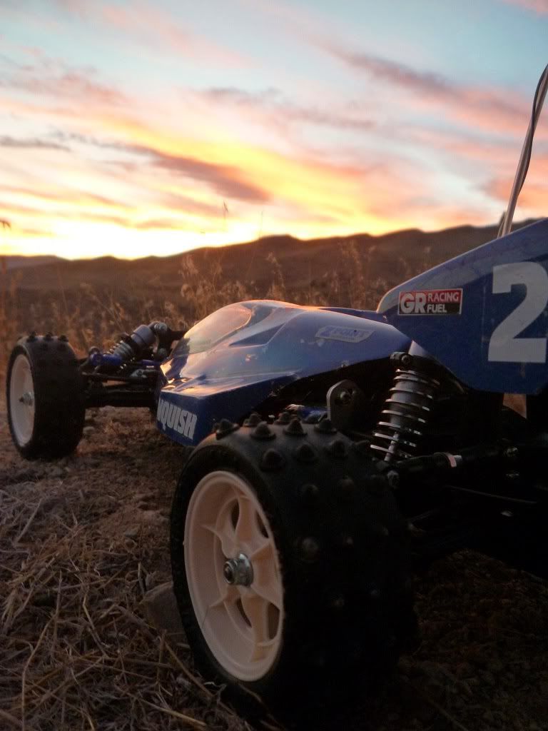

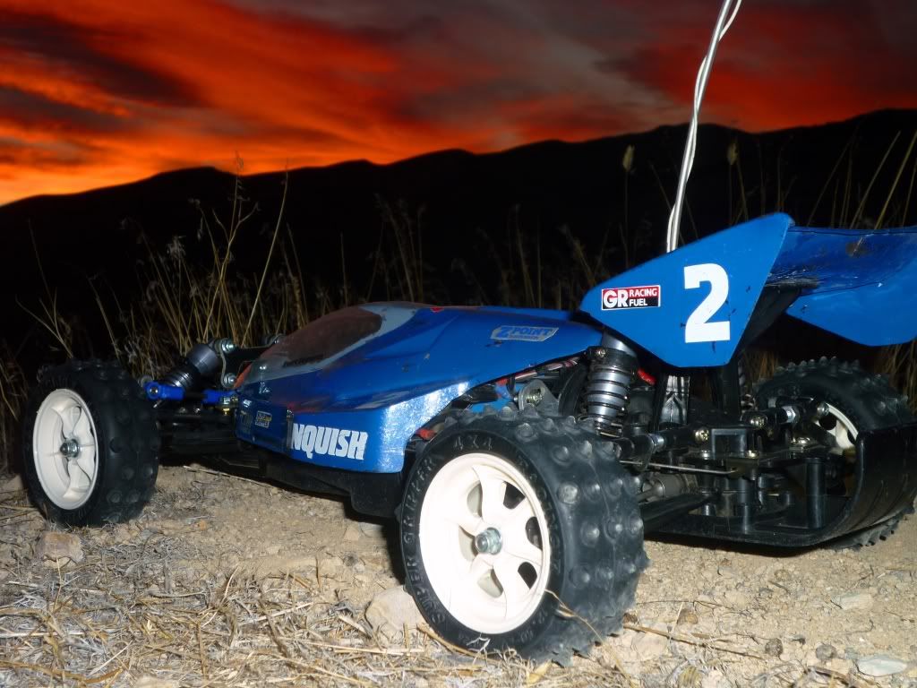

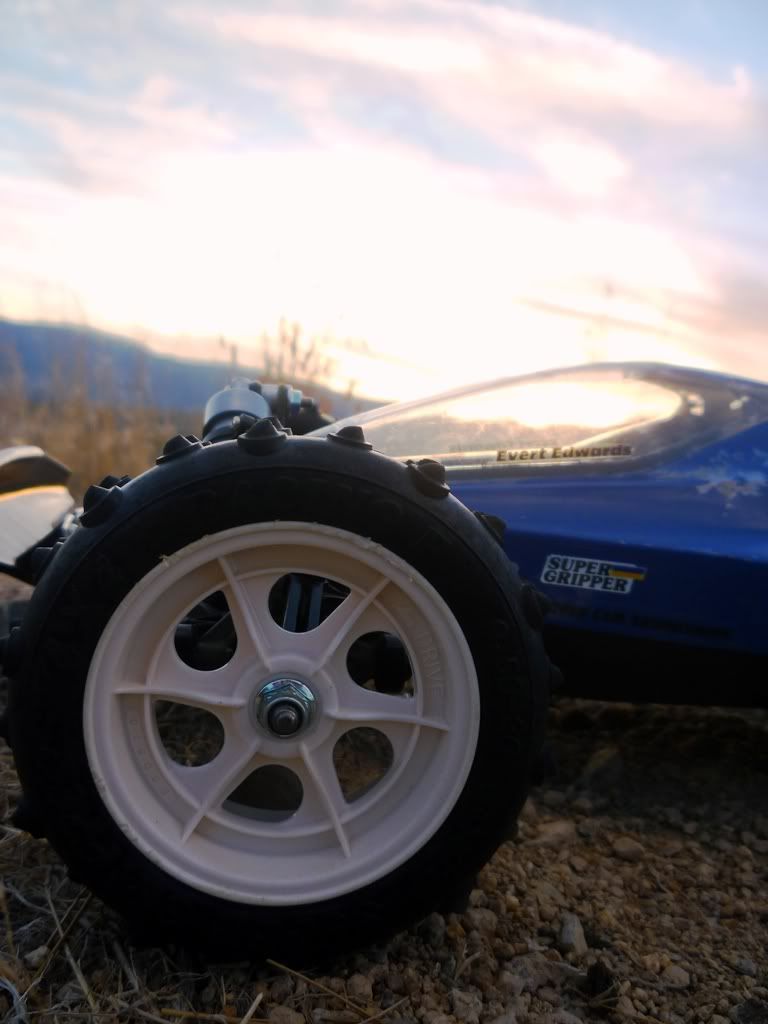

This car was a gift for my 14th birthday back in late 1990. I found the add for $99 in the back of Tower Hobbies magazine while sitting in my office (bathroom). This car has ran with many setups over the years. Originally it had a Trinity 427 (16T) in it, but that hot motor made short work of many ceramic resistors with the original MSC. The body was painted with Testor's enamel made for scale models. As you can tell it has had quite a difficult time staying stuck to the Lexan over the years. Though I find the splinters & chips add character more than anything. The wheels & tires are original kit pieces, though they only saw minimal dirt use. The current setup features a very old (indestructible) 80'sTekin Sport ESC, 2400mah Orion stick-pack lipo, Tamiya BZ motor, steel 18T pinion (DF02), Hi-Cap shocks, Hi-Cap Tuning springs, Ball-race steering, Hi-Torque servo saver and Triple ball-diffs. It's 100% vintage parts too (except the motor & battery). She goes quite well and I've even raced it on-road once (last year). I've also managed to clear the "triple" at the local off-road track with it.
I am currently planning a re-do of the body & wheels soon, so I had been thinking of taking some photos of how the car sits now. A few nights ago we had a beautiful Reno desert-sunset, so I grabbed the camera and went to work. Let me know what you think.
A very nice setting for a car with some cherished memories. Hopefully I can look forward to reminiscing about my original cars when I am older - and still have them!

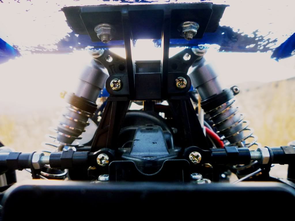

Is the nose of your Vanquish trapped/fixed under the front shock tower?
Why yes it is sir. Good eye. The Carbon Chassis instructions say to trim the sides of the nose so it will simply pull out (see link below), but I could never bring myself to ruin such a nice detail. The good part is that for typical running, you never need to remove the body anyhow. The battery is inserted from below, and the battery connector is easily reached by lifting the side of the body. Should you need to actually remove the body, it's still easily accomplished by removing one of the lower shock tower screws and barely loosening the other. This allows the tower to pivot up (with the damper still attached) and the body will slip right out. Tamiya's serrated lock-nuts allow screw loosening & tightening without the use of a wrench (screwdriver & fingers only).

At some point I did try fitting the vanquish body to my 2001. But in it's stock form, the opening is too narrow. Also I'm completely partial to the look of the hi-cap shock tower. I love the way it bridges over the body and compliments the angle of the dampers.

Just noticed a few details on your car - I like the mesh in the vents. Also I see you're using square section springs on the dampers - I used to have some of these but I don't know what I did with them - are they Tamiya?
Square section coil springs were an Hop Up Option of the Hop Up Option. So if the Hi Cap Dampers were an Hop Up for most cars the square springs where an Hop Up for the Hi Caps Dampers.
Max
Yes, the fronts are part 53053 and the rears are 53054. They both be found on ebay at the moment. The rears are very expensive these days.
They are good springs, but kinda awkward as far as tuning spring-sets go. They are not really meant to be options. It's kinda like Tamiya recommends a specific spring pair for specific chassis, and there is almost no way to use the other springs on that same chassis. The problem is that typical tuning spring sets should have the softest spring as the longest spring so you can maintain proper ride height for the given rate. In these sets, the shortest spring is ALSO the softest spring. This makes it EXTREMELY difficult to switch between rates or tune on the track since your ride heights jump all over the place each time swap them out. The soft springs make the Vanquish "LOOK" nice & low in the front, but then the spring is nowhere near stiff enough for that ride height. I will say setting up the rear hi-caps on the Vanquish was a complete nightmare unto it's own. Finding enough droop while keeping the dog-bones from binding took a couple days. As it stands, I am nowhere near the kit recommended setup.
Here is a link to the packaging for the "short" springs (the longer ones) so you can see how Tamiya recommends the install. The back of the box shows both front & rear spring recommendation for many different chassis: http://www.tamiyaclu...66393&sid=20749
Oh, and also the long square springs, like any other long springs, do rub the shock body cylinders. But since they are square & sharp-ish, it does make a bit of racket. So it kinda takes away from the smoothness of the hi-caps. Still looks VERY cool/unique.

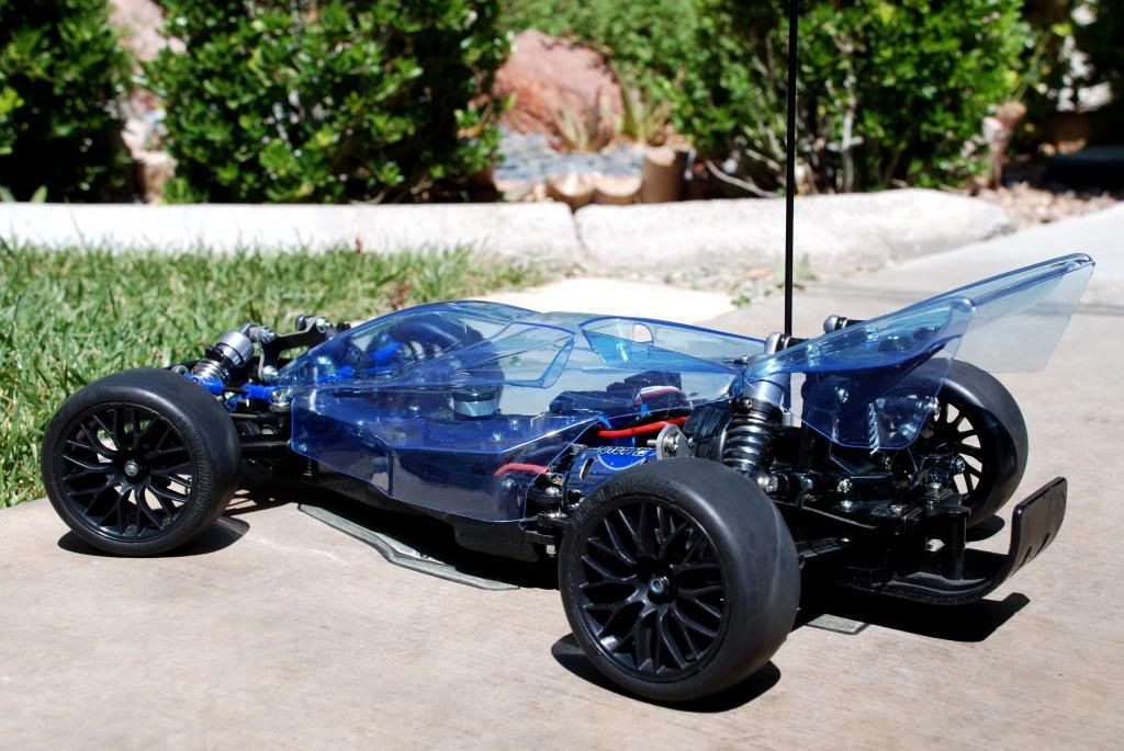

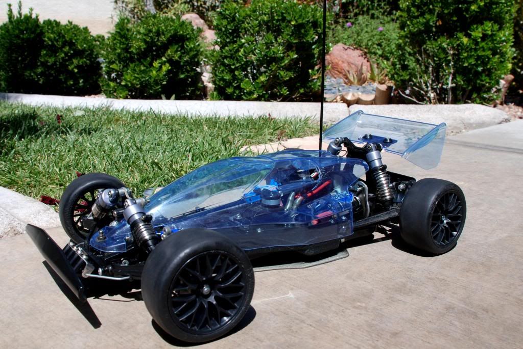

- Shimmed Front & rear suspensions.
- Full alignment
- Rebuilt, sanded & shimmed center diff.
- Fresh re-work of electronics.
- Fitted 3800mah Intellect Lipo.
- Fitted new steering tie-rods & ball joints
- Fitted HPI Super RS4 wheels & slicks.
- Fitted new replica body & wing.
- Fitted new front bumper
READY FOR A ROAD TEST!
Had a chance to run it last night with the slicks. It was pretty cool out, so grip was low, but the 4WD was still quick. It's almost insane just how much steering angle these cars have. Especially after the old-school alloy uprights carve their way into the soft ABS C hub. Additionally the center diff keeps the front wheels from fighting the rears in those tight turns, making the car extremely maneuverable. And the lack of a slipper really puts the punch to the ground (thank you LiPo). It's the only 4WD I've seen do donuts on pavement.
Still a great car after all these years. Very different from any 4WD I've driven.
