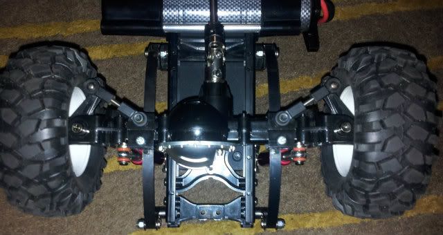

You mean this;

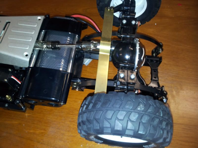

Can anyone explain the rear hub locking bar to me. It looks stock but is a bit of a weak link?
You mean this?
That plate spanning the knuckles isn't a stock piece, nor any aftermarket part I've seen
You can access the build manual for one of the High Lifts here; http://www.tamiyausa...roduct-id=58372
The stock setup is a 3mm diameter steel link - similar to the front end, unless that's been swapped out too;

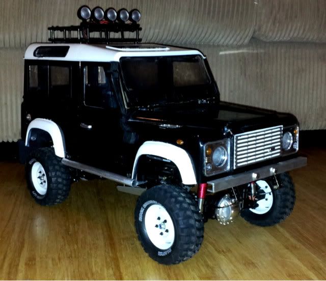

Who's D90 body is it? RC4WD? It looks like it is a perfect fit which surprises me because I would have expected it to have been too short without modifying the chassis.
Have you seen this one? It was made by TCer Mcovalsk: http://www.tamiyaclu...=97608&sid=6228
Now I have. Nice rig. A little high for my liking but if is was mine I wouldn't complain. Still got a long road with this one. So much to do.

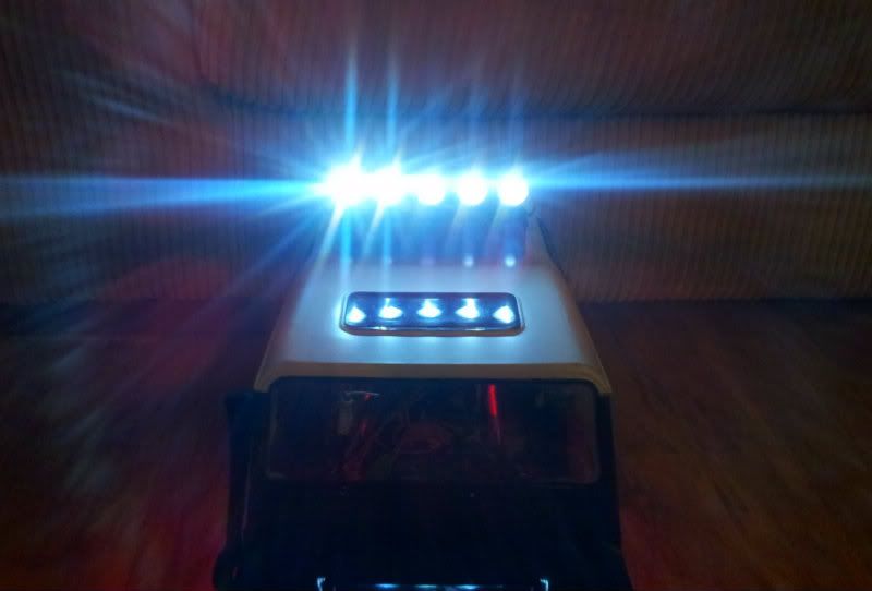

Added some lights for night driving. It looks so cool. I'm such a kid. :lol:
Headlights next.

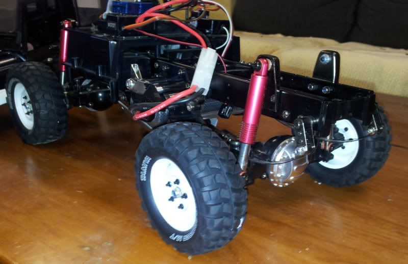

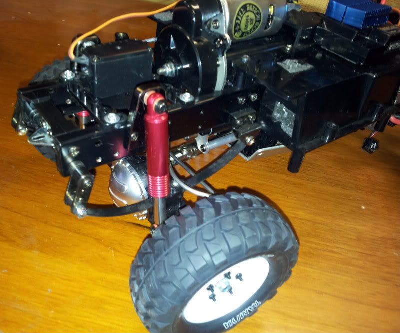

You may be able to move the shocks to the lower screw hole on the axle case rather than the upper one you have now - this will reduce the gap above the tyre, effectively lowering the ride height by ca 10mm
Ok. Did this today and now the "shocks" are binding. Going back to original setup.
That's odd, plenty of people have moved the shocks ( taking the blocks under the leaf springs as well). No issue on mine but perhaps I have a bit more clearance with the Gmade shocks I have fitted
Not binding on any body part but click when compressed from fully extended.
