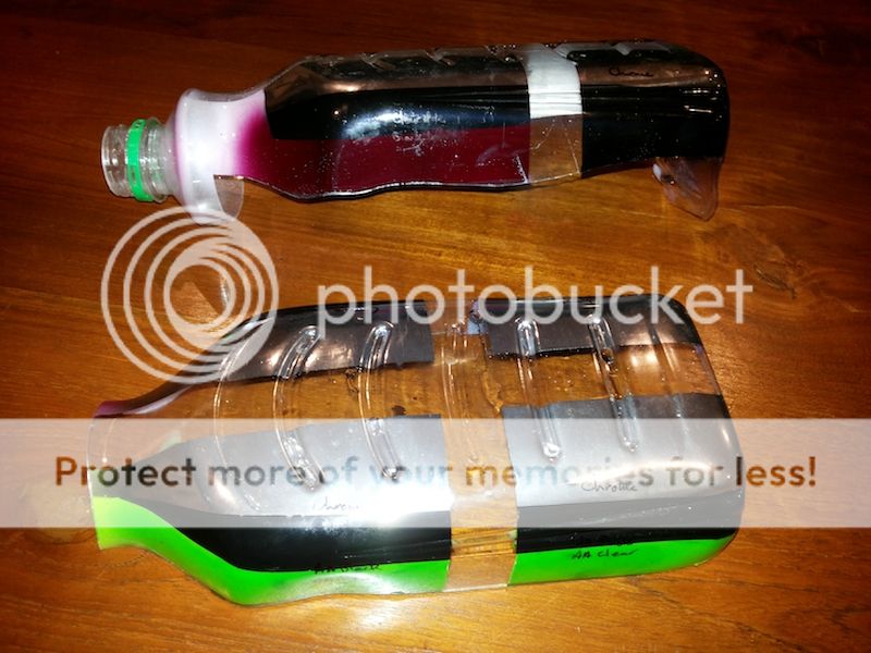

I found a couple of images that I thought may be of interest for a couple of reasons.
Here is how I often test paints for lexan. I used a old juice bottle cut in half. It isn't quite the same thing (polyethylene vs polycarbonate) but it is close enough for what I am trying to do. I then tape off sections depending on the number of combinations of paints I am trying to test. In this case, I have 4 sections on each bottle half. The main purpose for the tests below was to see 1. how well Spazstix Mirror Chrome worked, 2. how best to back it, and 3. if there were going to be any adverse reactions between Spazstix and AutoAir paints. It also let me test a few colours I had sitting around that I hadn't tried. I realise this is probably more involved testing than normal but it gives an opportunity to try out combinations and with a little thought, you can do a single set of tests like this and get on with painting the car shell.
In relation to the original topic, the red is AutoAir's Iridescent Red and the green is a Pearl Green. Both show up very well on the tests but neither photographed well. You do get a little of the effect on the red in the photo but not like the actual test piece. So, I would guess that you just get the Pearl paint, spray it on the inside as a first coat, then add what ever colour you are trying for, back it and you should get what you are looking for.
