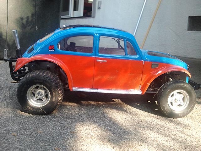

I'm running the F201 dampers on mine. The bodies are narrow and work fine with the SRB. I don't find the softer torsion bars and issue.. they work fine if the dampers are actually dampening the suspension. The stock ones don't dampen at all. If the torsion bar was stiffer, the rear end becomes bouncy.
I have GB-01 3Racing Shocks on my rere Scorcher alongside the original suspension and it has sorted it right out.
I took the blue anodization off with oven cleaner to make them a little more subtle.
