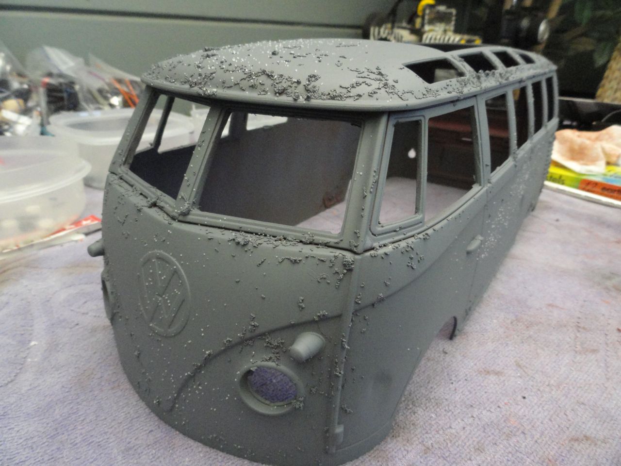

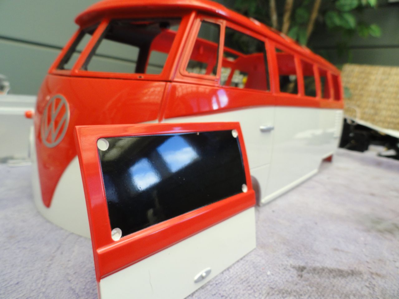

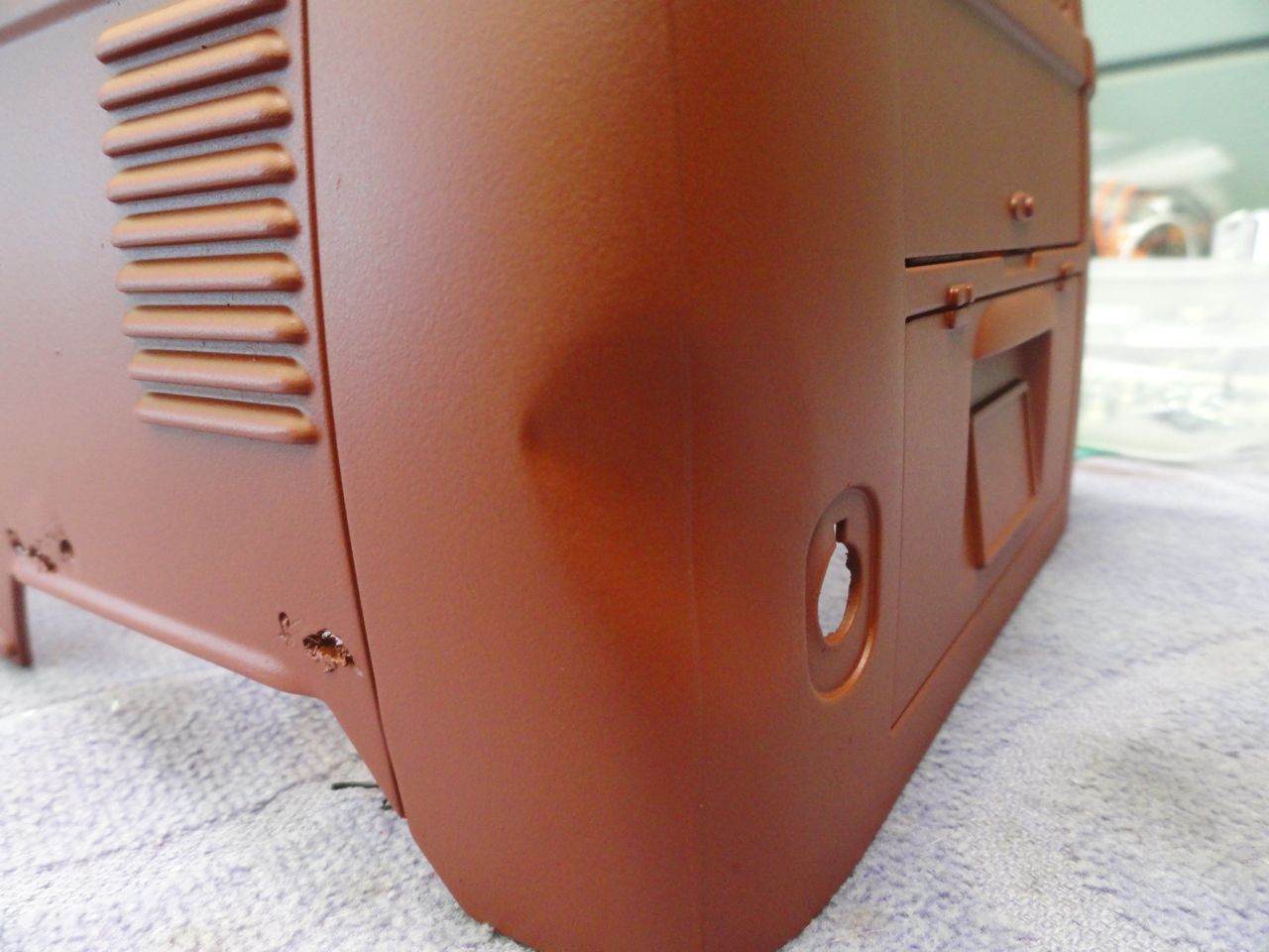

Skottoman 306 Posted November 19, 2012 Yes, I'm doing another build thread... I must be losing my mind! This is a Maisto VW Samba RC I purchased last christmas, and tossed the chassis because I wanted to use the body for something. I have yet to know what this will turn into, but I do know it fits an M04L wheelbase perfectly, so I'm building up one of those for it. I ordered some rally tires, and have locked the diff so it should at least get by on semi rough off road. As far as the shell? I'm going to attempt a weathered, ratty, rusty, junk bucket. Maybe a rally stripped down theme? Toss in a Willy? Roll cage? Plaid seats? Dunno yet... But it's going to be all or partially PERIWINKLE in color! haha For those wondering, I've never done this before, just going to read online how to do things, and pretty much "wing it"... Haha.... Started on the body. Main problem is all the "fake" windows, had to dremel them ALL out. What a pain... Also started some rusted away portions, and added some dents. On with the pix! Cheers, Skottoman Share this post Link to post Share on other sites

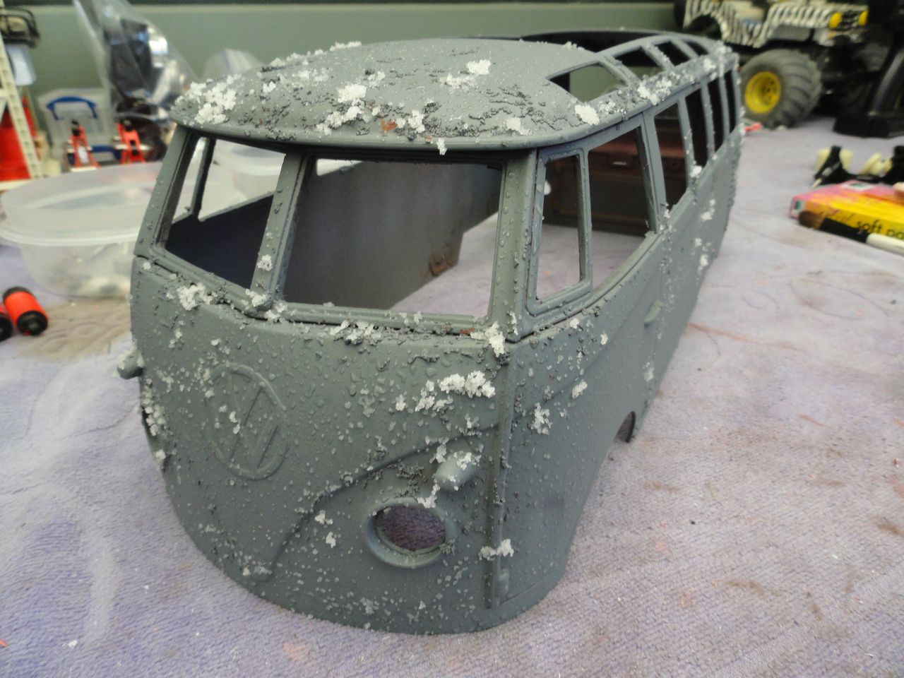

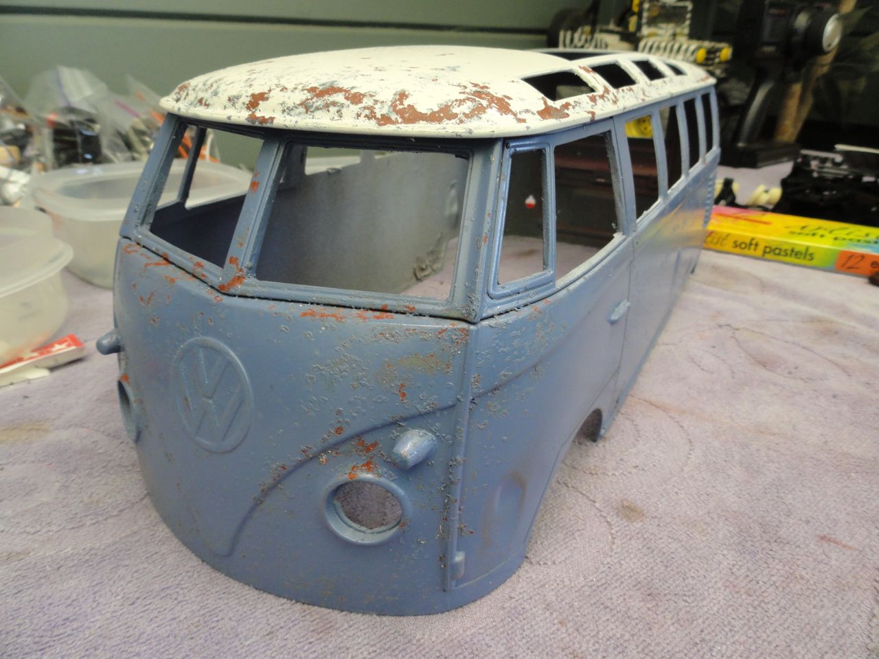

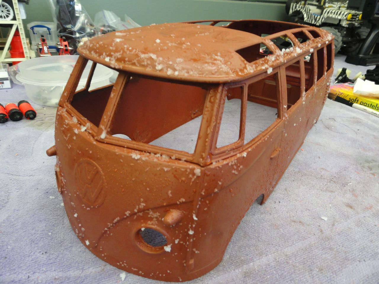

Skottoman 306 Posted November 19, 2012 Basic painting is done. Need to sand/detail/weather, etc... But I tried a strange technique of sticking salt on the shell between colors. Turned out pretty good, need to clean it and sand off some more, but it actually made it look like a mess! Haha... Just fun to experiment, I don't worry so much anymore if I mess something up... Cheers, Skottoman 1 Share this post Link to post Share on other sites
TA-Mark 195 Posted November 19, 2012 Finished effect looks like bubbling paint with rust underneath it. Mission accomplished I'd say. 2 Share this post Link to post Share on other sites

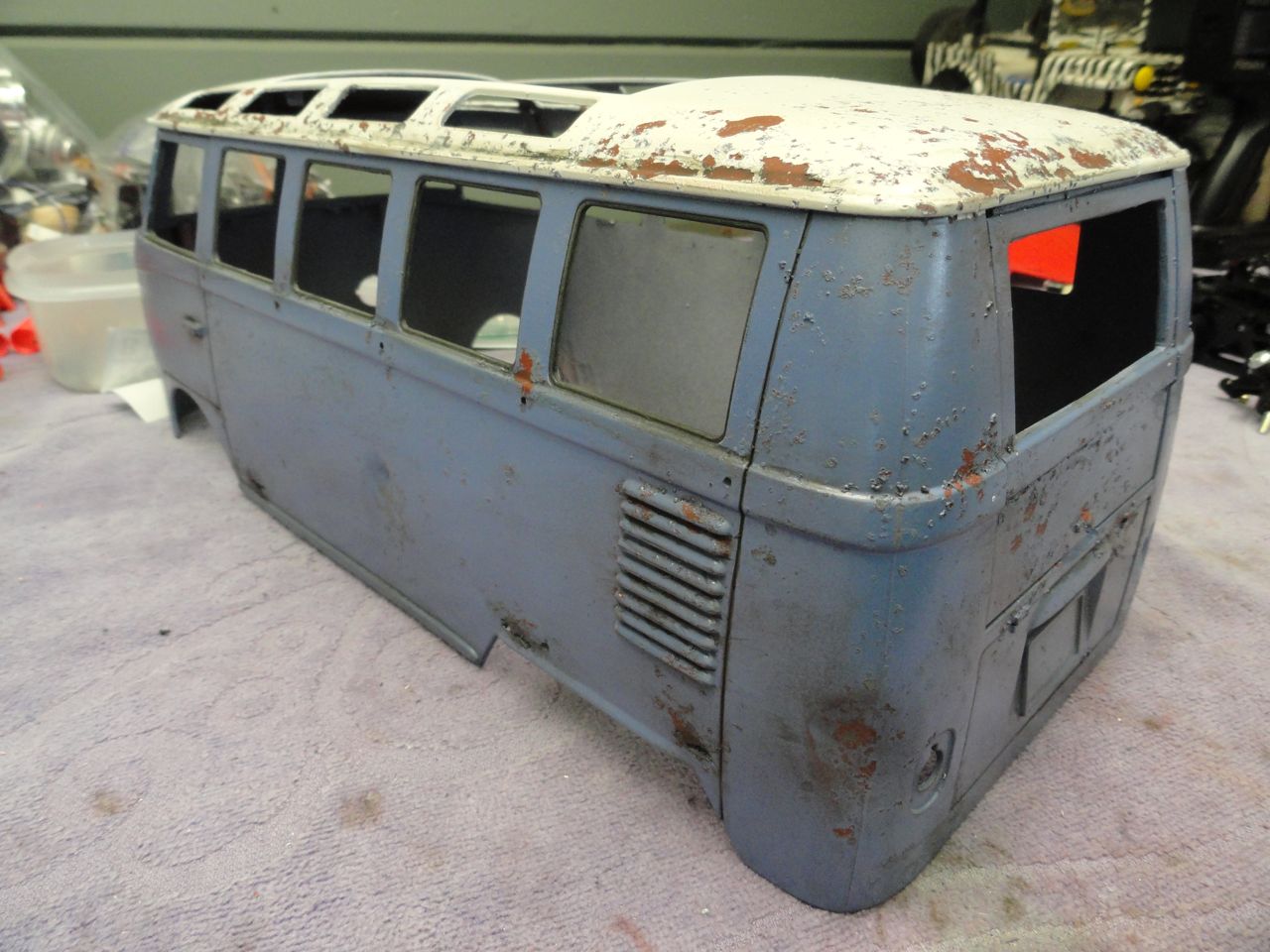

Skottoman 306 Posted November 20, 2012 So more detailing for the basic shell... Used a wash of dark green and black mixed to paint body lines, add basic grime and dirt, and paint the window rubbers. I read somewhere that solid black doesn't look as scale as a shade of grey, and they were right! Especially on a van this messed up! Also some crushed pastel dirt, and some detail to the VW badge... So much more to go, and I'm still not sure where this is going to end up! Hard to believe, it used to look like this just a short while ago! What have I done?! Hahah... 1 Share this post Link to post Share on other sites
