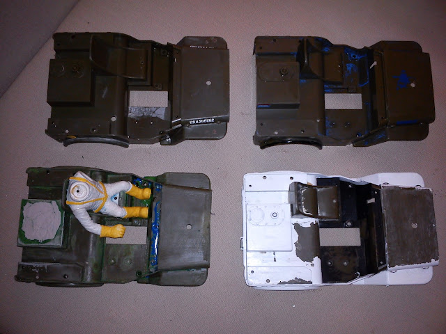

Caustic soda works fine on a ABS shells (you can get it at the pharmacy or use the stuff for the clogged drain). As the others point out, gloves, goggles and loads of fresh air. Warm water will help but not too hot as the soda heats the water as well. depending on the paint, leave it for a couple of hours and stir and brush in between. Some paint might stay untouched but so far I got lucky on most of them. And the paint on your SRB already is coming of a little.
they were all completly covered in different kind of paints, the white one probably heaterpaint.
I believe the lower right even had 4 handpainted layers, red, yellow, blue and green :blink:
Using caustic soda, I wouldn't leave it for an hour, let alone a couple, as it tends to brittle the ABS. Put the items in, wait a couple of minutes - start massaging with the brush and see what areas needs more attention.
Also - I only do a few items at a time and not a mixed bag, as items may need different treatment.
