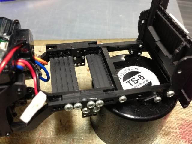

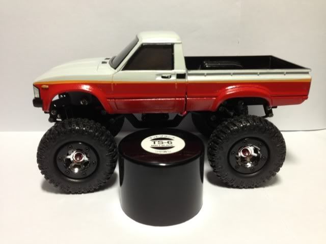

i dont have any 1/10 photo to show now, will have to go back and take a picture.
but i do have a comparison to a Tamiya spray can cap photo

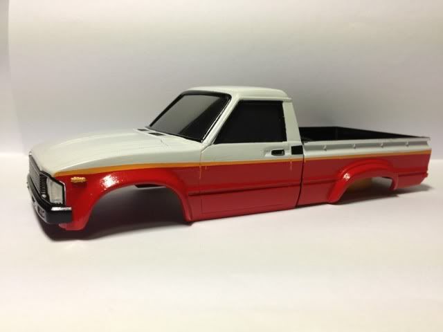

here you go.....

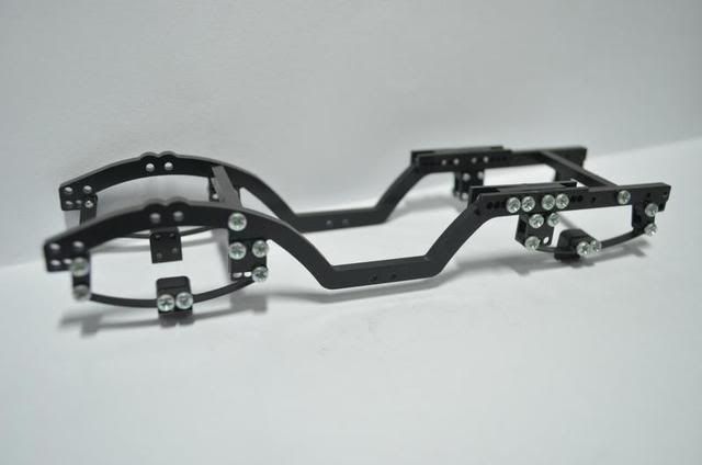

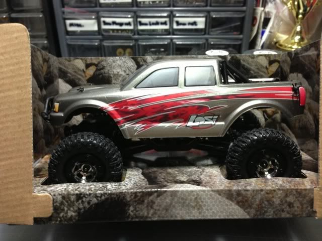

SMC 4.5 chassis

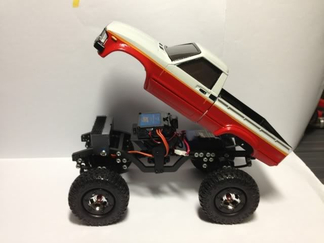

1/24 Aoshima Toyota Hilux model kit, painted, tinted glasses
Donor Car. Losi 1/24 Micro Trail Trekker
basically, i used the axles, motor, transfer case, steering servo, electronics and mounted it to the SMC chassis
DIY some mountings from sytrene
ESC mounts, batt holder, steering plate,

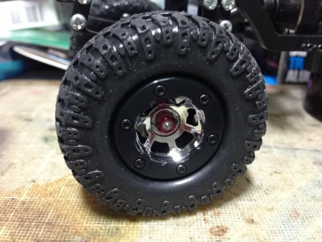

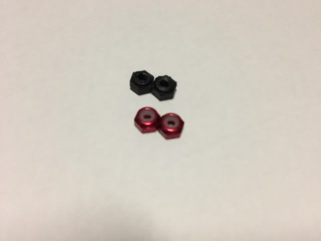

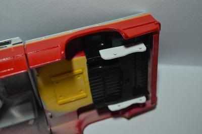

Changed the plastic locknut to alum
DIY mounting for the body to attached to the chassis

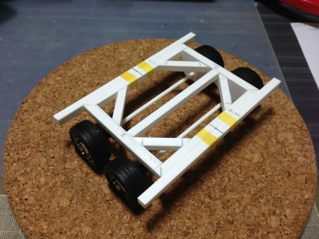

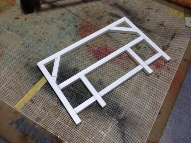

I still have another Trail Trekker and SMC chassis to work on but i cant decide on which body to use, so i'm putting that on-hold and deicded i need a trailer to transport this little baby around
Started with some basic sketch...
Detail in
Actual work on sytrene
The main body of the trailer
i used back the wheels from the model kit and made so simple axles to hold them in place
Back end
getting there....
Test fitting
Still need to work on the ramp and strengthen the whole trailer.

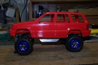

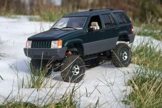

Great looking truck, I built one as well made my own chassis.
100_8568-001.jpg  Guess I should take a new picture, a bit larger100_9366.jpg
