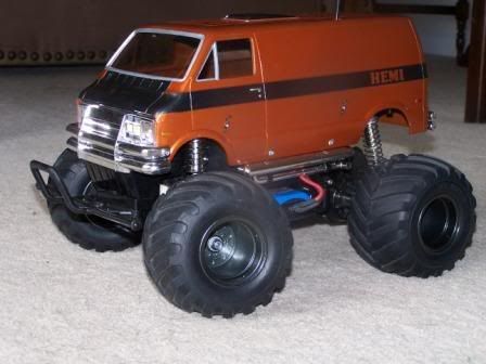

so i got bit again by the rc bug. been fascinated with rc since i was 5 or 6 years old. first real rc was a new monster beetle i got in high school. wanted the clodbuster, but as many young folks discovered, it was just too expensive. finally got my first clod in 99, gave it the esp clodzilla 2 treatment. fast forward through the years and i find myself with 3 ebay clods, a (piece of garbage) losi mini lst 2, a new axial wraith, and my current project... the lunchbox. i had a pumpkin many years ago, but just didn't have the knowledge or skills to make it work like i wanted to. after time spent here and on rcmt, i had a plan. after a 3 year hiatus, i got to work on it this past week.
so far:
third shock
crp front end
oil shocks
front strut brace
rear frame braces
centered steering servo
i really like the junfac rear shock mount, but don't know if i want to go that route
also still considering power. i bought a novak 8.5t for it, but don't know if i really want to go that route
once i get my pics sized properly... blah blah blah
Junfacs haken_gruen.gif at assembly I noticed the plastic Tamiya bit was broken so a good replacement.
:D
i do like that junfac setup, but i think i'm going to try and fab up my own version first. i think this truck is going to be my guinea pig, with useful mods transferred or copied to another, unmolested box
Like those alloy body posts! Where did you find those??
there is a guy on ebay from the UK who makes these and some other alloy stuff
Model_build on eBay supplies those. I have them on mine. Well worth having.
Like the look of that Junfac kit Emory. Does the Junfac kit incorporate the third shock mod too? Or have you done the third shock mod and added the Junfac kit ?
