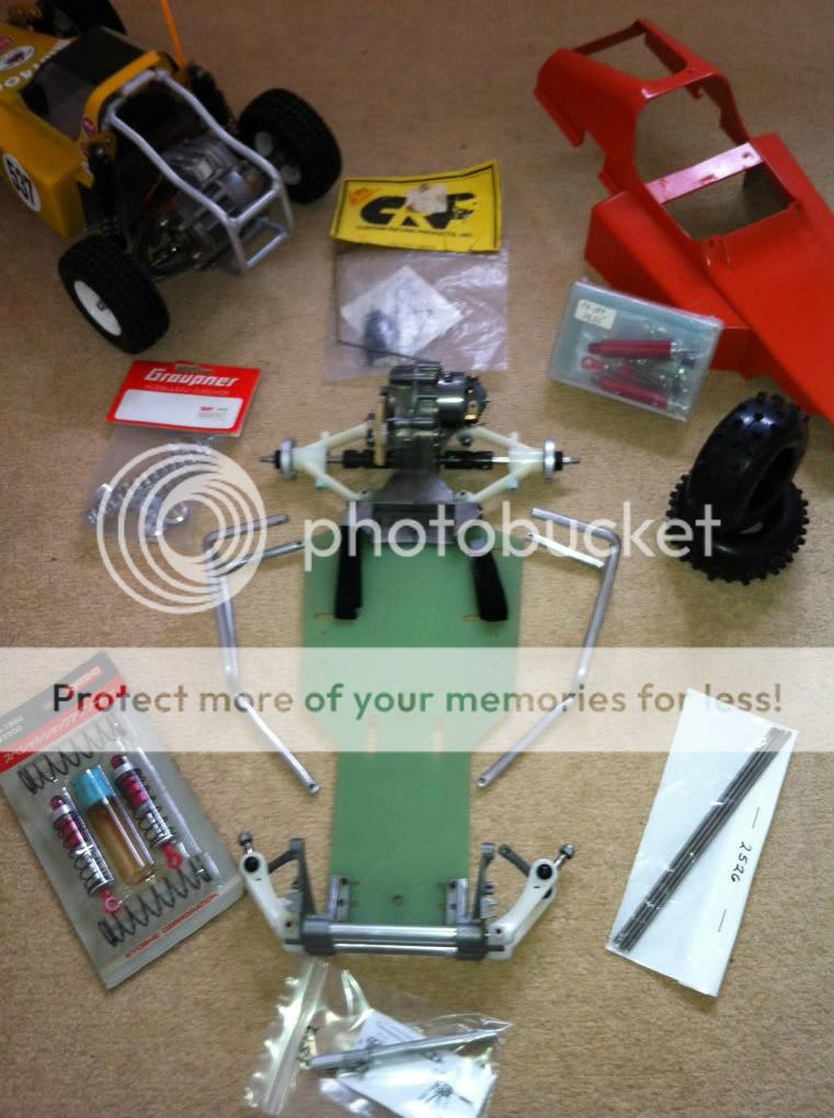

As for actually racing a hopped up SRB I never did, my earliest memories are from 1983 in an old wooden floored church hall where everyone put silicon on their tyres to get some grip. Back then I know there where SRBs and I remember the Superchamp coming in but I don't remember nor did I own a hopped up SRB. By the time I graduated to actual racing it was with a hopped up HotShot then a Schumacher Cat and finally a PB mini mustang. Of course coming from that era I also saw the rise of the magnificent RC10 seeing that race against Frogs and SRBs was like watching an F1 car race against Formula Ford :-).
However I do own most of a Racing SRB today - still collecting for it as time and money allow -
http://i330.photobucket.com/albums/l426/hedge1970/photo-1.jpg
I hope others jump in but it's a dwindling group who are interested in these nowadays.

Nice photos! Are you planning to put it back together at some point??
