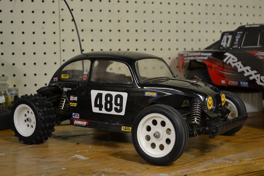

Here is what I did. They are Tamiya wheels but I think they look cool and bite really good in the dirt! This pic was where I was just mocking up the rear wheels and the body. The electronics weren't even installed yet. I should upload another more recent pic of my set now. I will try and do that in the next couple days.

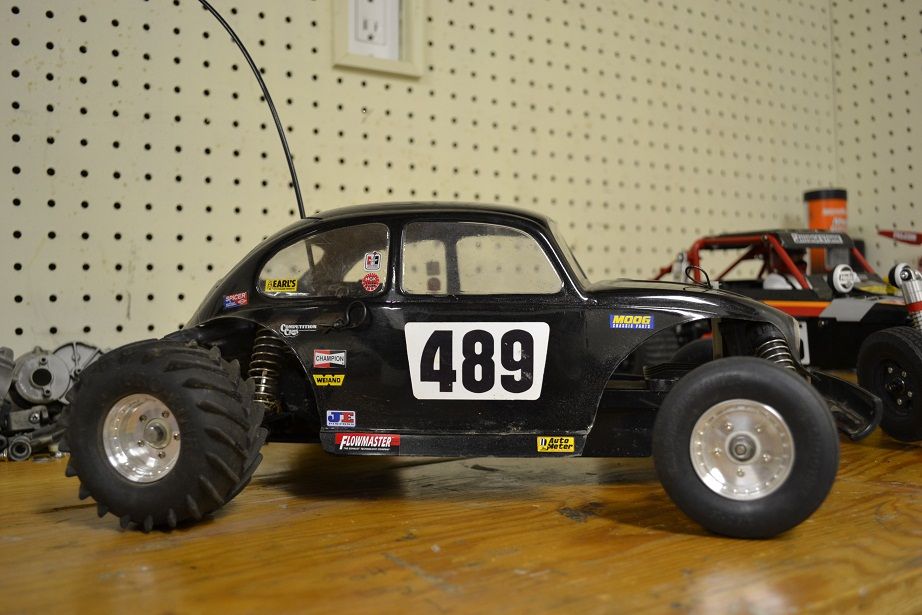

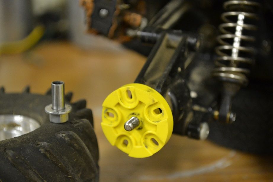

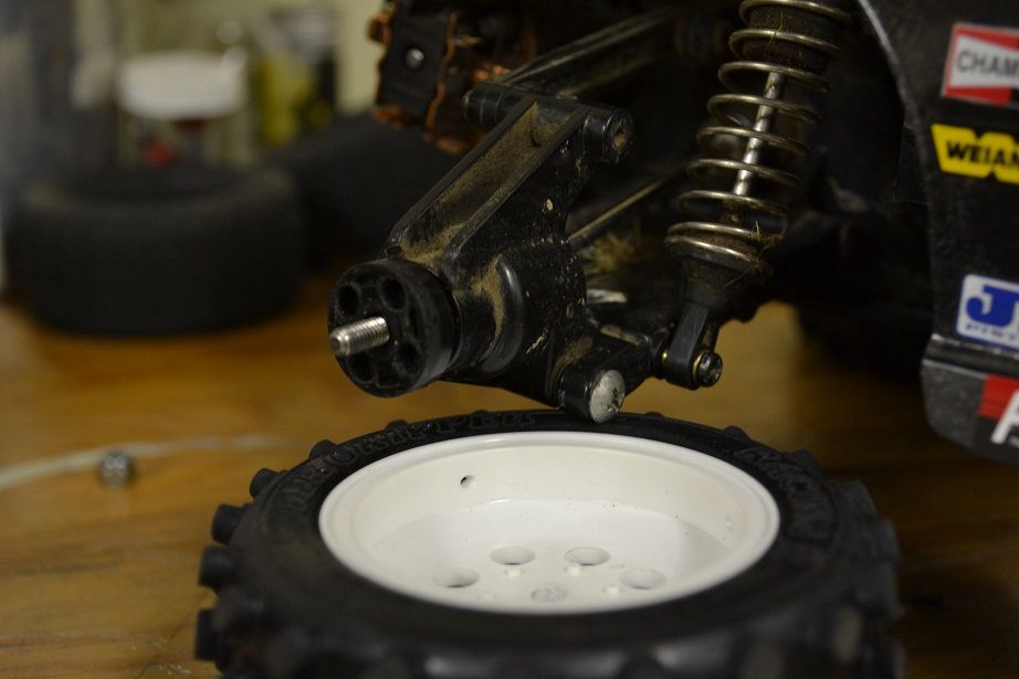

As promised! Here is the first photo showing the CRP adaptor and the special nut that goes through the wheel and connects with the drive cup. I worried about structural strenght but I assure you not a problem whatsoever! I am running a pretty hot brushed motor in this thing!

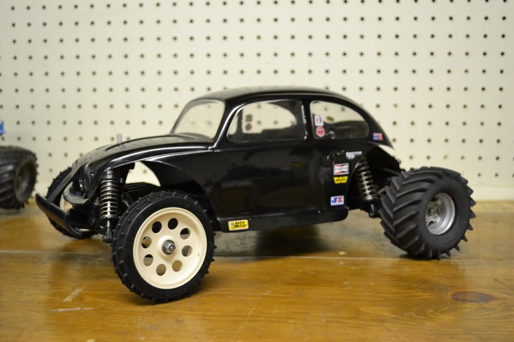

When I first thought about changing the wheels and tires of the blitzer Beetle I thought of running Wild One wheels and tires. I still play with the idea but right now I really like the set up that I am running with the SRB wheels and tires (see the photo above post #10).
To attach the Wild One wheels and tires I use Falcon Hubs. Falcon hubs fit directly to the drive cups and bolt up (Nut Up) ;) nicely. Now I will tell you that over time I have went through a lot of these Falcon Hubs because as soon as you put any kind of power to them the crack. A guy in England is reproducing them in aluminum which solves the cracking issues!

Hey Greg I will get some piics posted up for you. You can use the regular drive axles dogbones and inner gear box drive cups. All it takes is these CRP parts.
Many thanks! Now this is opening up a lot of new possibilities. :)

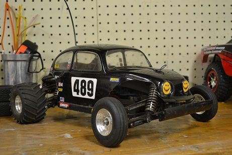

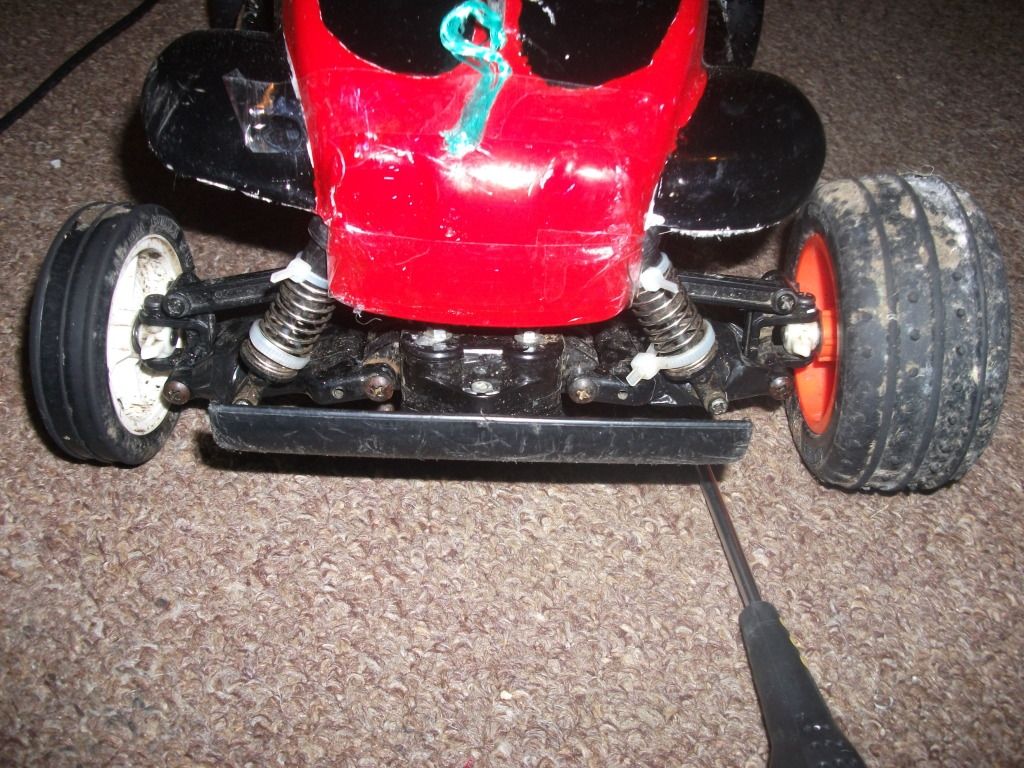

Now that's dirty. :lol: Just like it should.
I wonder what's the purpose of those zip-ties?
Lol, My blitzer is a mess, but it runs, 3s Lipo and a castle creations 4 pole motor. :lol:
The zip ties are to keep the front wheels pointing forward, I find if the springs are tight the shocks always bounce the front end straight again.
Well the bottom ones have worked loose and been left there, my 1 year old has hidden all my shock collars. :lol:
I have looked at the bump steer mod but haven't had time yet.
Without them the weight of the car make the wheels point east and west.
