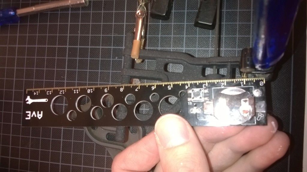

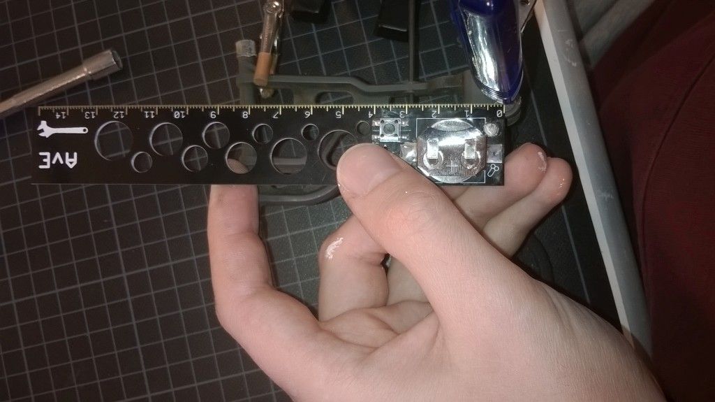

I equipped the Mad Bull with its wheels and measured the difference in track width. Left = old. Right = new. There's more difference than I was expecting.
This affects the large Mad Bull wheels on full steering lock. With the new arm (right), the tire will hit the front bumper. This means I need to cut down the bumper. There might be no trouble at all when using regular Fighter Buggy RX/Mad Fighter wheels.
I still think Manny's 3d printed design is great, and I'm still thankful for allowing me to get my hands on it. For any future iterations, I'd suggest making the arms longer, so they would match the DT-01 stock track width when using DT-02 c-hubs. This would also allow for a second damper mounting point.

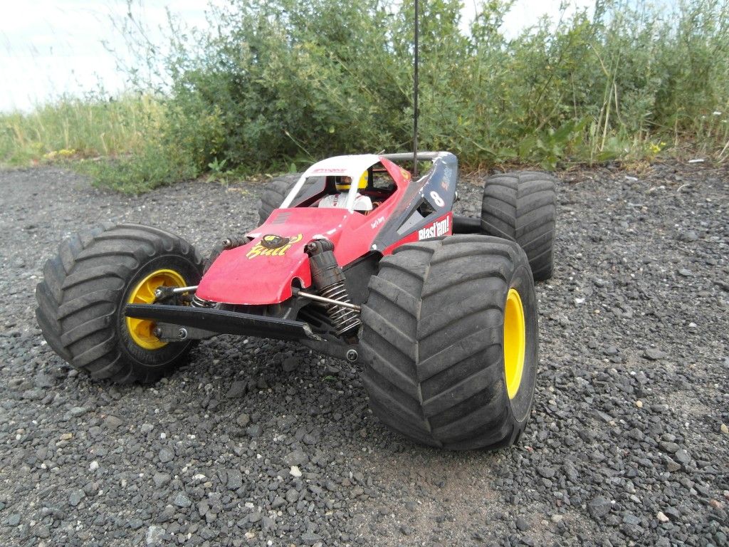

Sorry for the long wait guys. Today, I finally got around to finish the Mad Bull front suspension installment.
Since there's front track width is now shorter, I did some measurements, comparing the stock front arm to Manny's 3D printed front arm. Please click on the photos to get a better reading.
Measurements from center to steering knuckle pivot:
Measurements from shock mount to steering knuckle pivot.
More measurement from shock mount to steering knuckle pivot.

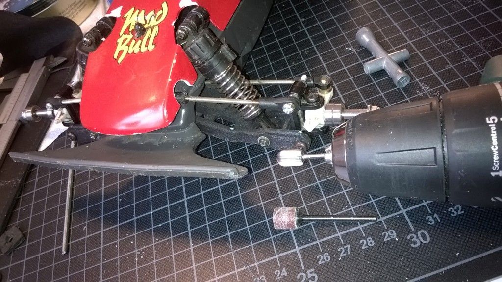

A Proxxon milling bit was helpful when I cut out the arches in the bodyshell to clear the upper links. Afterwards, I used a sanding drum to get a smooth finish.
The cut front bumper.
Width comparison to stock bumper:

I did a test run today. The arms held up very well. Funny camber changes are gone!
Thanks! I haven't planned doing one yet, but I think it's a good idea to show all the mods in a video, once I'm finally done and confident with the ball raced steering. I also need some grippier rear tires and stiffen the front dampers, otherwise I'd be just spinning out on gravel.
