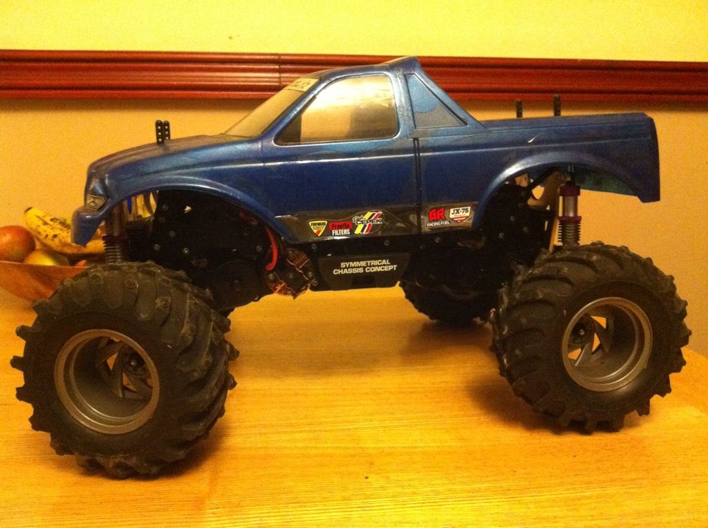

Well, after a week of waiting around it arrived today, completely standard in every way!!
So, nothing much happening today, apart from I have removed the servo and MSC, and taken the shocks off...
I have 2 19T Etronix sport tuned motors, and a Ripmax No Limit ESC in the shed ready to be fitted
On order I have

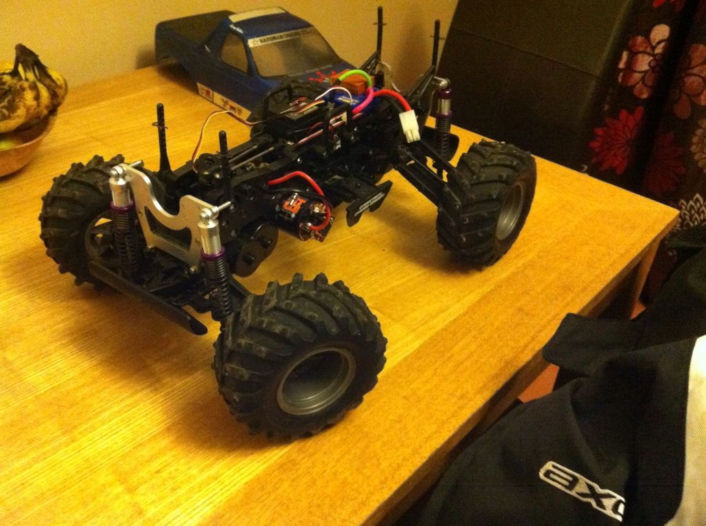

Little update, just fitted the alloy shock towers and 100mm shocks, a little more clearance now :D
Just need to fir the Hi Torque servo I have then its pretty much there...
Nice work, although I'd check the front and rear dogbones don't bind in the drivecups when the suspension is at full droop - ie wheel off the ground.
I had that problem Dave but cured it by fitting 3racing CVD's .

Dogbones seem fine actually so happy with that.
