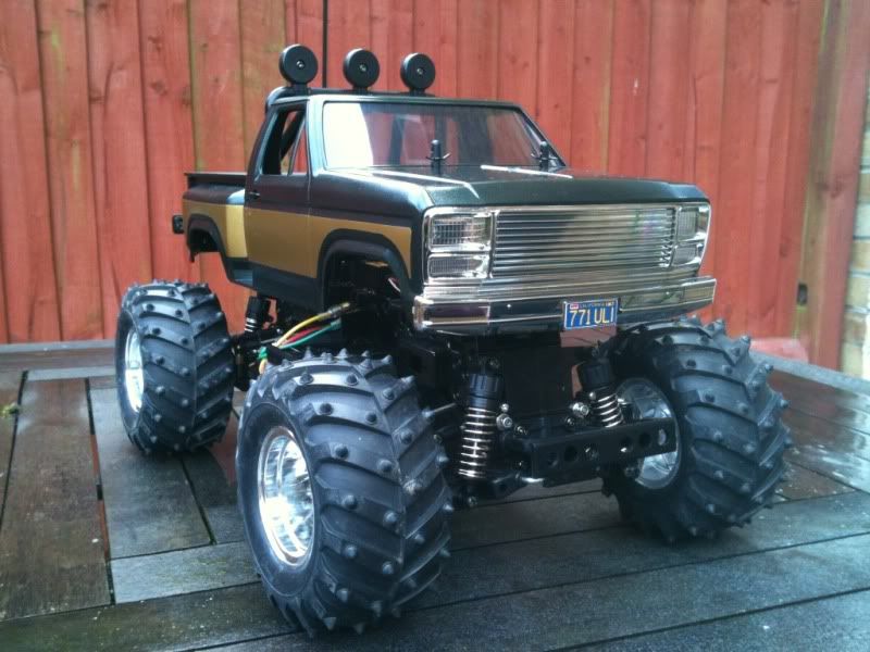

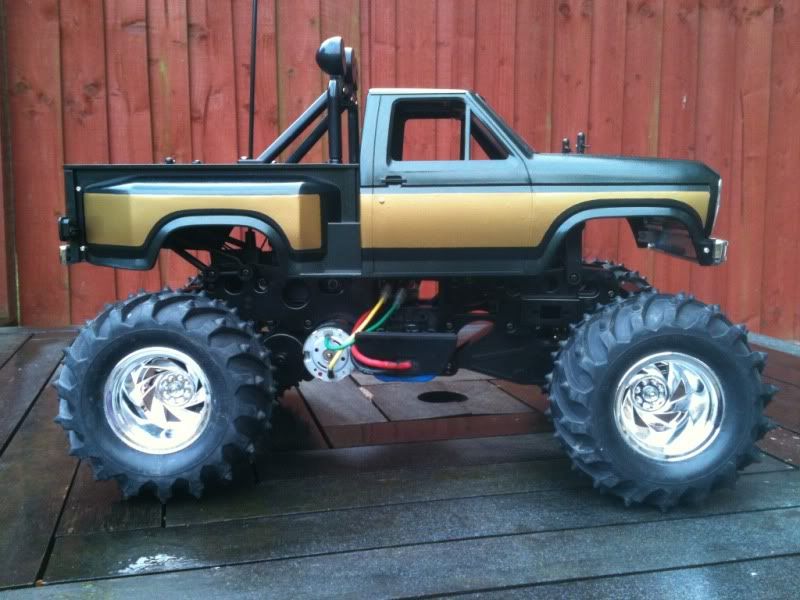

I'm even wondering about the gold panels now? Think I'll add the Tamiya tailgate decal and maybe the tribal bonnet, roof and flatbed cover decals.
Managed to get a few daylight photos between snow showers.

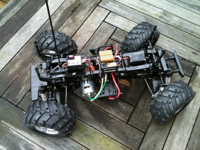

The servo saver spring on the rear was a white plastic item from the spares box and isn't really man enough for the job. I'm thinking to replace it with the Tamiya high torque set so that it'll be tuneable and comes with a choice of longer or shorter servo arms. I need the rear end to stay put and a few people have advised I might want less steering on the rear so that'll do the job nicely.

i would'nt worry about reducing the amount of rear steering . I have found that having the same amount of turn on both ends works really well . So long as you dont give it full throttle in the turns it works fine with little chance of a roll over . i'd try it as is before makong any changes to steering ratio .
Y cable arrived so had a morning of 4ws insanity.

Your right bromvw, can't see limiting the rear will improve it much although I definitely need a stronger servo saver spring as it tends to get pushed off centre at higher speeds. Managed to take a quick video but its very tame as I had the TX in one hand, iPhone in the other and was worried about my paint work...

Yep mongoose, the Y lead is to run two steering servos to get the 4 wheel steering.
Edit: I should've made this clearer but I will also be making a simple Y harness to run two motors from a "single" ESC once I have the 2nd gearbox fitted. I'll post up picks when that's done and report on how its working.

I usually swap my electrics between chassis so I want to go the Y cable route should I need to use the ESC or servos in other chassis in the future.
I have a no turn limit ESC that is able to handle quite a bit of current so it should be fine running 2 standard silver cans or a pair of 35T motors. Maplins sell packs of male and female bullet connectors that match the standard Tamiya motor connectors. It should be pretty simple to have a connector that fits straight into the ESC lead, and solder 2 cables going out to the 2 motors. Do that for both positive and negative leads and you're sorted.
Then it should just be a case of reversing the polarity on the rear motor so they both turn in the same direction when the throttle is pushed forward.
Its as simple as you say - thats exactly how i made up my y harress's so i can swop the electronics about with ease .

Decals arrived yesterday so got them fitted last night using the washing up liquid in water method followed by a blast from a hair dryer to fit the contours better. There was a very thin pin stripe edging that went around the large gold panels and I assumed it would be connected on clear vinyl but it was actually separate and for the life of me I couldn't get it to sit right so I've left it off. Still looks pretty good to me though.
I also used the number plate from the custom decals. I'll add the large Tamiya across the tailgate and the rear lights from the kit decal sheet but that might be all it needs. Oh also the fog light covers on the roll bar.
I also swapped the rear servo saver spring for a stronger one I had in an unused car. It will now hold a straight line on full power for the brief blasts I can do in the garden.
Just need to paint and glue in the rear window, laquer the body to seal in the decals, spray the bed cover satin black and paint up the driver.
