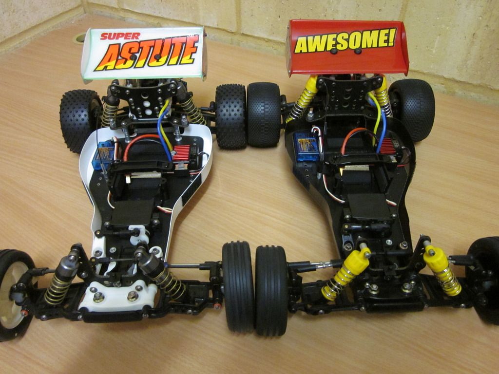

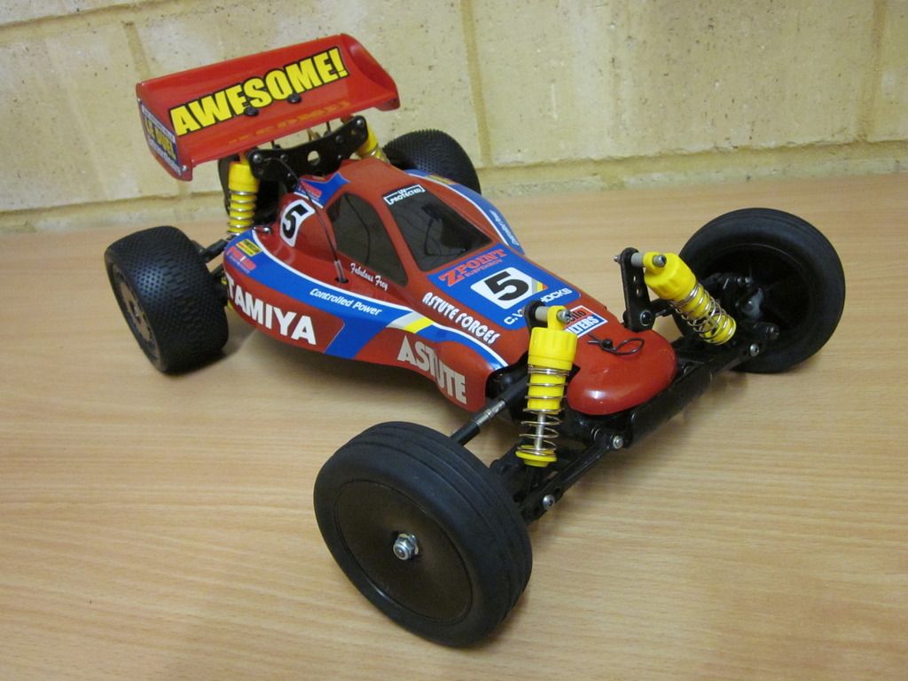

This car has had more face lifts than Joan Rivers but this time I decided to tidy it up with a new body and simplify the running gear and make it more sensible for a vintage runner. Sensible..... but still Awesome !

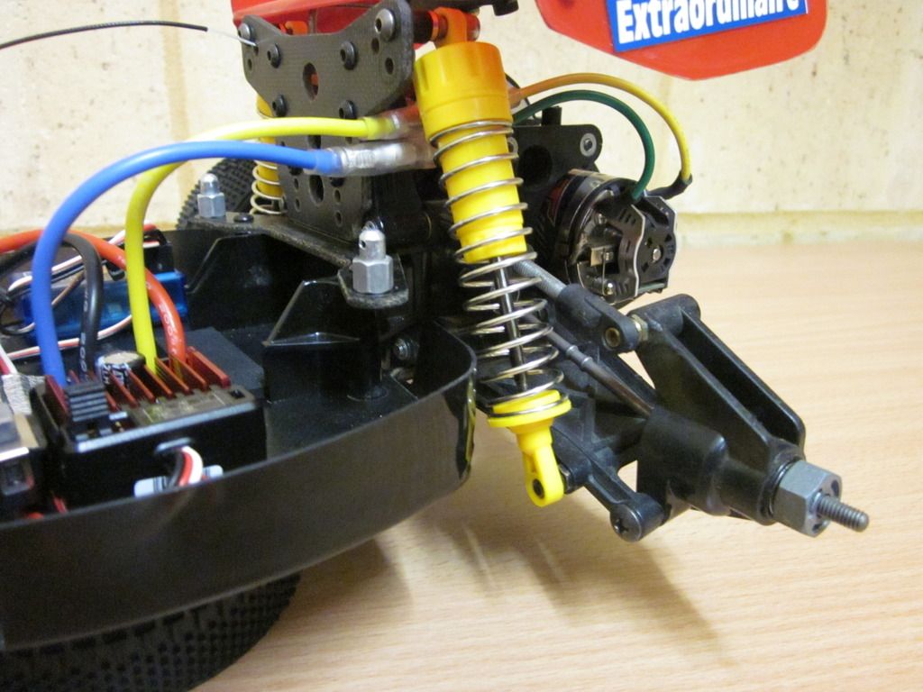

Kept the Madcap arms and C hubs, Super Astute steering arms, CVA II dampers with CC01 front springs, DT03 turnbuckle set, Futaba servo with Tamiya hi torque servo saver and Super Astute front brace.
Madcap arms and hubs again, also Madcap arm mounts. CVA II dampers with DF03 hard setting springs rear. Ditched the brushless for a GT Tuned motor and quicrun ESC. Other than the Super Astute battery tray, the rest of the car is standard Astute.
Now running twin set ups. The Super Astute has a hotter 17x2 motor and the Hi-Cap dampers that were previously on this car.
New replica body and decals and kept the black wheels for Astute box art theme. Thanks for checking it out ! :)

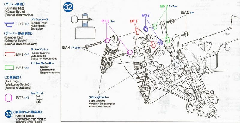

This looks like the prefect thread to ask a question.  I'm rebuilding a a super astute, and have gone the Hi cap route for the shocks, because they look so good!   The question is, what parts do I need to mount the top of the shocks?  I
The top mount for Hi-Caps is a steel ball and some rubber and metal bushings.  If you don't have these with your Hi-Caps, you might want to post your own Wanted topic.  Sorry, I can't be more helpful.
Don't quote me too much, but it seemed that I might have found a few of those pieces also found in Dyna Storm parts bags. I was working with the blue Sleeved Dampers a while back and needed the appropriate mounting hardware.
Many thanks guys......I had the dyna Storm brain wave last night, and did a bit of digging on Google to find the parts I needed in Germany.  So they're on their way to me, and I can relax again!
