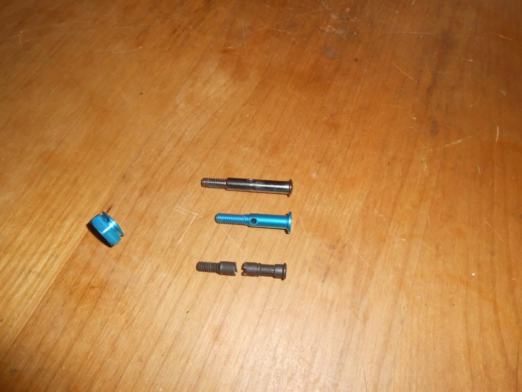

On this model with the upgraded axles to fit 12 mm hex, the front axles are very prone to snap right where the pin hole is. I've snapped both axles so far and I've had replacements on order through the store it came from for a while now. I was told this morning they have tried 6 times to order them with no luck. In my opinion a part that breaks easily with no replacement part isn't a good thing. I felt you all should know about this if your even considering this model.
It sounds to me like they need to Anneal their pins. Also if there is a sharp corner where it is breaking adding a radius can really make a difference.Dave can you send me a picture of the shaft that is breaking?Mike
The axle is too small for the pin they use and it's poorly manufactured. I found spares on Ebay but I probably won't go that way. In this picture the traxxas is silver, Tamiya is blue and the associated is the two piece one.

After looking at the trio of axle shafts it all became clear. The Traxxas is too long so it's out. The Tamiya would be good but I kinda had other plans for it. In my batch of Hotshot parts are upright cup drives or parts of them. The cups are gone but the axle is good. When I finish removing what's left of the battered cup I have a time tested axle that once I switch to 5 x 8mm bearings will fit just fine. I won't have to order in parts that most likely will fail anyway. Recycling is a good thing too. :lol:

After looking at the Pic Dave your right. There isnt enough material left between the hole dia and the outside of the pin. Or maybe there is but the material is brittle, which is highly possible.

I don't think thier worth making. I replaced them with the axle (less drive cup) from my Hotshot bin of parts. The drive cups were beyond repair but the axles had proven they don't break. I went to a 5 x 8 bearing too.

When I first saw your post I assumed the shaft was breaking right where the threads meet the "bearing Step" on the shaft. That's why I was thinking a bigger Radius but this was not the case at all :-)
To be honest the shaft itself looks like just plain old Pot Metal or something really cheap. You'll most likely be Way better off the way you went anyway.
