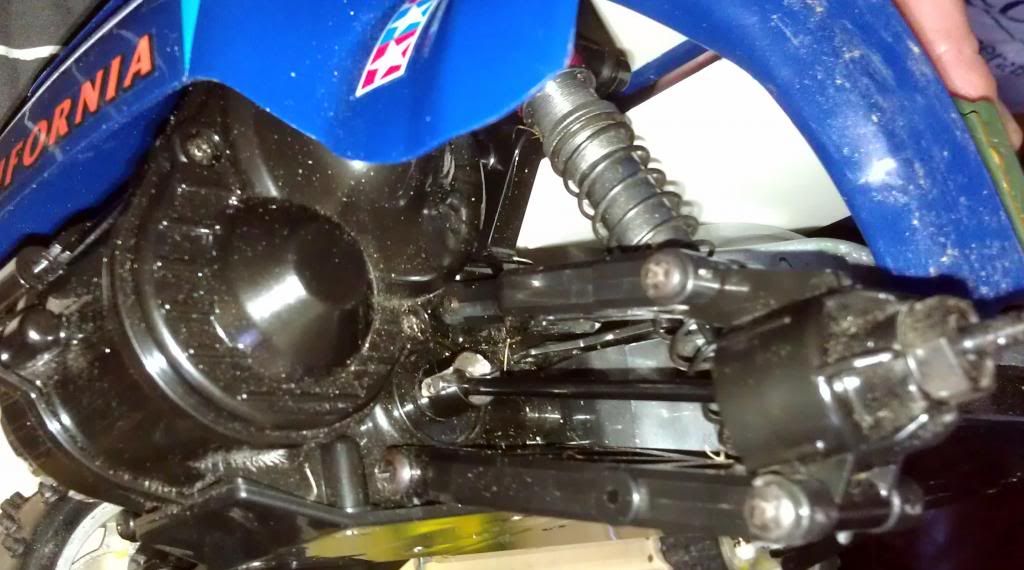

something i have noticed with this mod is that the universal joint on the shaft is placed directly above the outer, lower arm, hinge pin and the shaft runs parallel to the lower arm which keeps the diff end of the shaft in the same position in the diff outdrive regardless of suspension compression ,again its pure luck but the end result is a super smooth and ultra tough drive line .

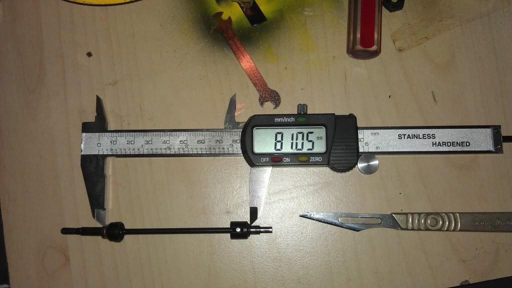

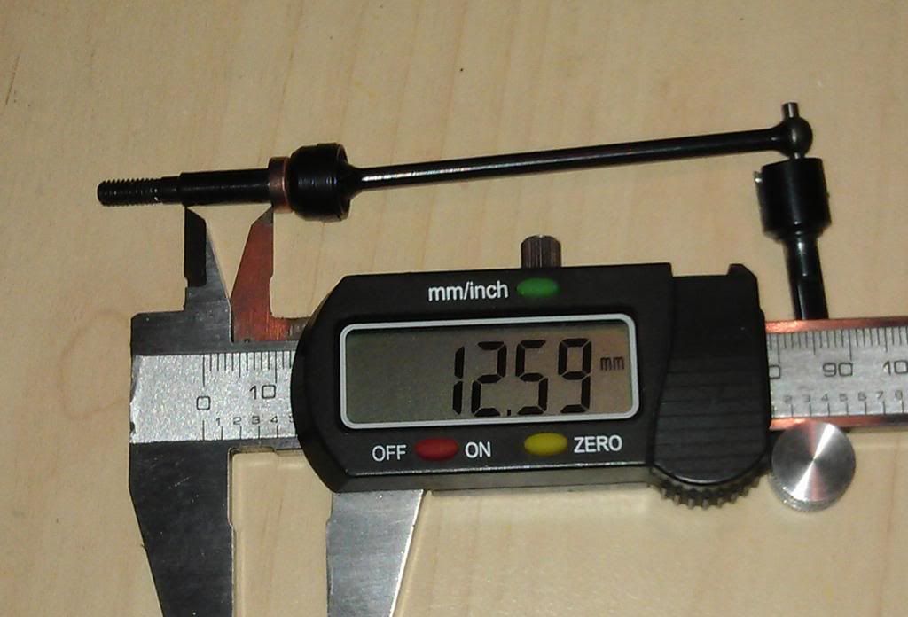

here yah go,
pivot center to center is 68mm ,
the hex pin in the stub axle is 2mm at its center from the step before the threaded portion , hope this helps, :);)

ok, so the shafts i used on the HB add an effective 13mm(with bronze bush) to the length of the plastic kit dogbones so as you said once you get the new outdrives you should be able to get something , the T3 shafts at 52mm you mention add 10mm to your stock falcon shaft length , i have had a look around but cant see anything with a 55mm shaft that would be compatible but you may get away with shimming the 3racing outdrive to fit.
