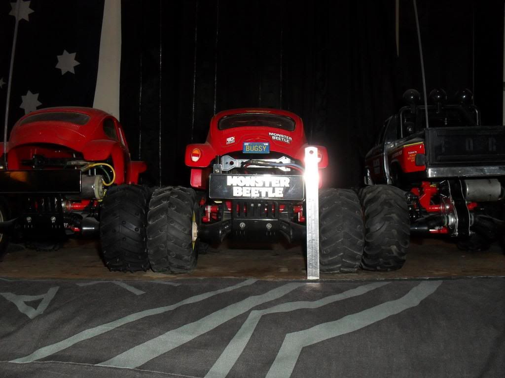

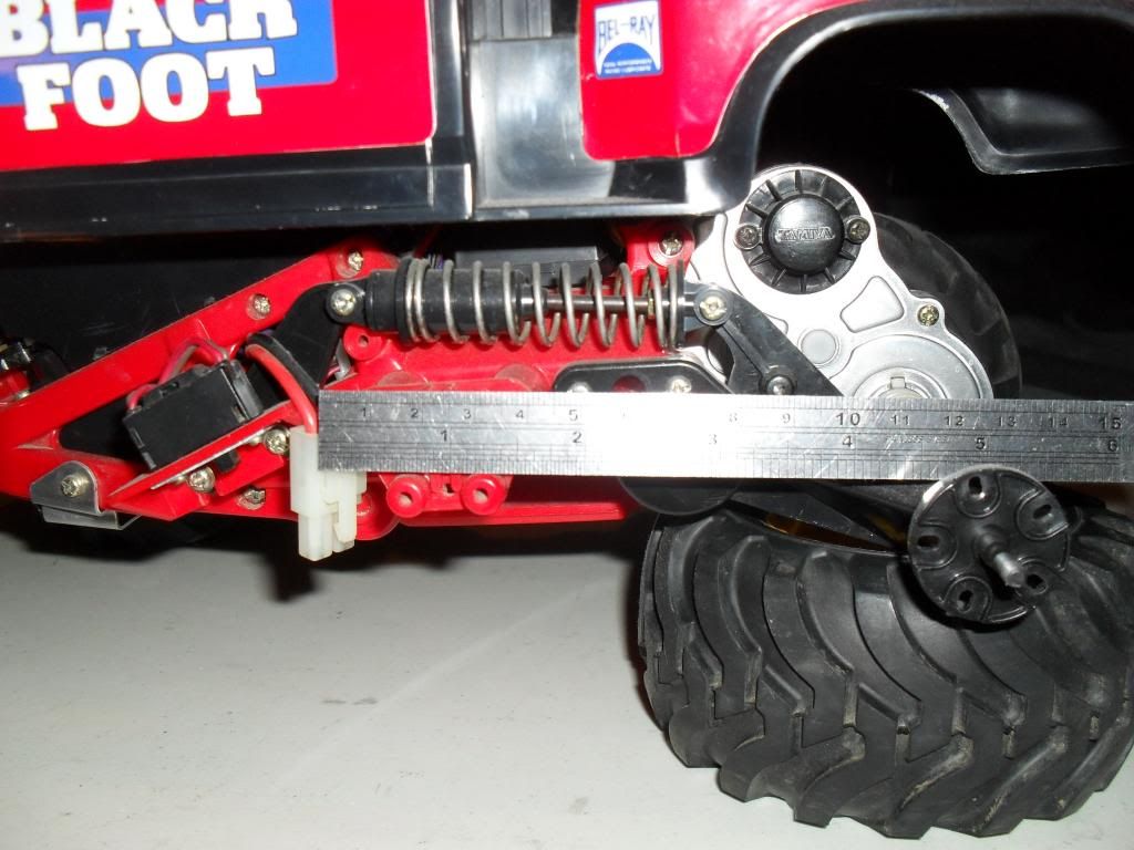

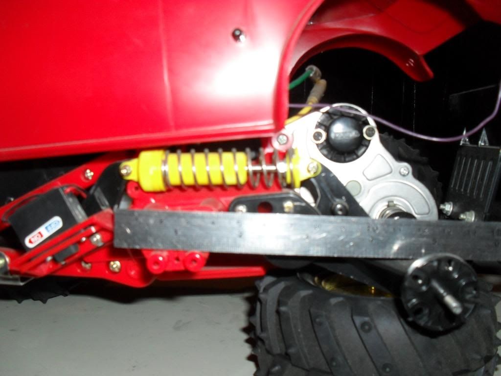

hi guys having terrible trouble getting files into this thread, have made them as small as possible but still wont attach ok they have gone in now.
right the MB is the chassis with the drive shafts almost in a straight line and the BF is the one with the shafts almost at 45 degrees. Both cars are at rest with no batteries in them.
The MB yellow shocks are at full extension and actually stop the swinging arm from hitting the red stopper on the underside of the chassis by about 5 mm. The yellow MB shocks measure 70mm centre to centre when on the car and also when off, this is the same for the front shocks and also the back shocks, so i thought hey presto buy a set of MB yellow shocks and problem solved. But nope the yellow shocks have arrived off the bay and they measure exactly the same as the BF black shocks 80mm.
The BF black shocks actually allow the swinging arm to go full distance by stopping at the red stopper on the chassis. these shocks as previously mentioned measure 80mm from centre to centre.
exactly the same chassis but the MB drives sit almost straight when at rest but the BF are at 45 degrees and i assume the reason why the right rear pops out every now and again.

Hi Smiffffy
Looking at the pictures you attached, what I can say is that the near 45 degree angle of the axel is what you should have (on both a Monster beetle using yellow shocks, or a Blackfoot using black shocks, whether they are using the dogbone hop ups, or the original hex type axels). This is how it should be.
I can only assume that the reason the rear axels are running almost straight on your MB with the yellow 70mm centre shocks, is due to the odd shortness of these shocks you have (unfortunately I don't have mine to hand to measure at the moment, but i'm certain that the yellow & black shocks should measure the same length, probably @ 80mm, I will measure mine and come back to you on this).
Like I say, I have a Blackfoot using the black shocks, and my axels are just like your picture (their near 45 degree) and I also am using the dogbone hop us (bought of ebay, in the blue transmission bag).
I have run this Blackfoot quite a few times, and I have not had any trouble with the dogbones popping out, I have not had to use any shimes or rubber grommets).

As Gripper said the steep angle of the dogbones looks to be correct. I run the dogbone set up in my runner MB running a 15t motor & Ive never had one pop out(I do have one grommet in each drive cup)those uni's should work fine too.
I also have MB & BF shelfers with the original hex drives & the angle is the same.
Blackfoot
Monster Beetle sorry rule's a bit hard read
MB in the middle is my runner with dogbone set up
