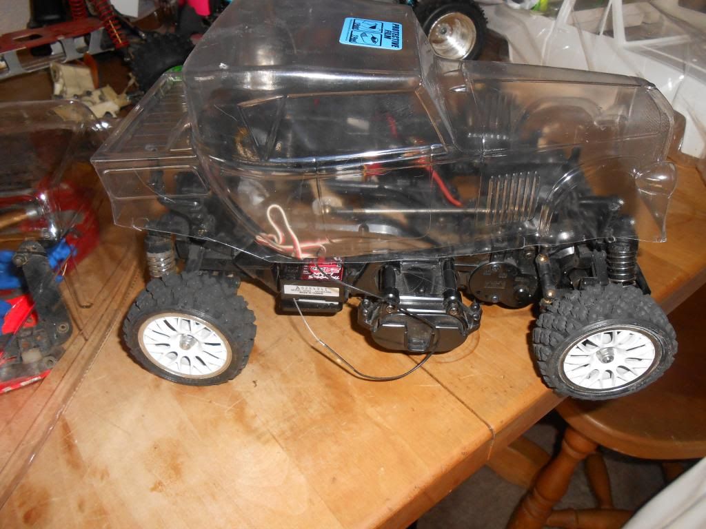

That's odd, from the pic of it on the m chassis it looks like the m chassis is too short in the wheelbase!
That's not an M chassis in the picture, It's the GT01. It just fits under the front and back of the body and the 160 width is about as close as you could ask for.

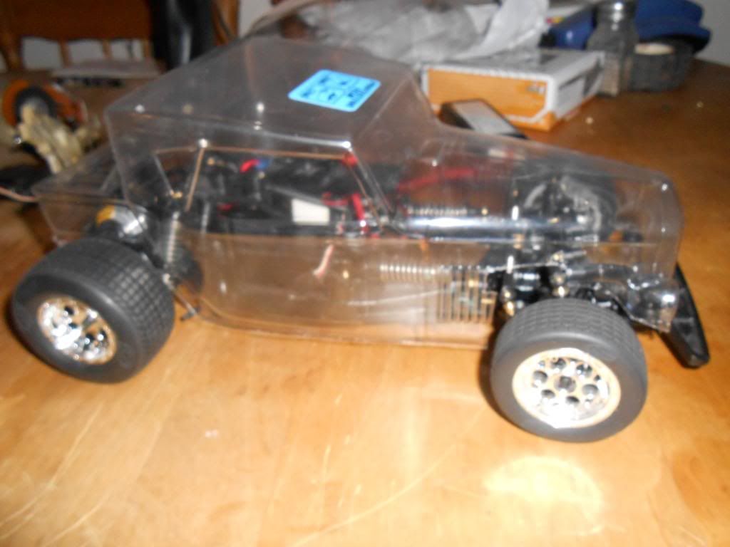

This is on a short version M05. The centerline of the shocks is the same as the ends of the body and the front wheel wells would have to be opened up. then there's the battery that's wider than the body. It could be done but there'd be a lot of cutting.
Oh whoops! Yeah I think that body could handle having more of the wheelbase offset to the rear, but with the front axle centreline pulled slightly forward of where it is in that pic. An m06 may be narrow enough to fit within the tub too!
I've never seen an M06 close up but unless the battery mounts different it would be sticking out both sides.That body is pretty narrow and has a really long hood with nothing in the back so nothing really is going to look anything other than a little different.

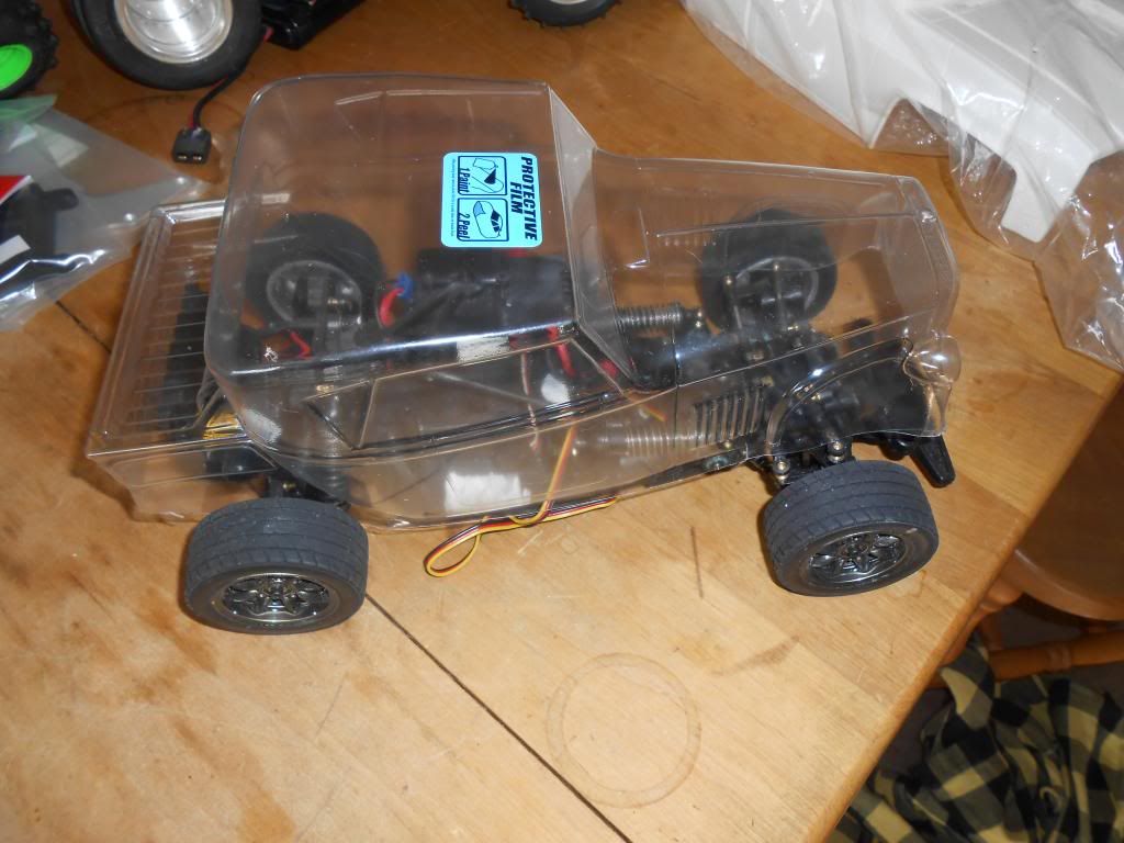

This picture shows a bit better how I intend to put this body on the GT01 chassis. It's still very preliminary but it looks like it will work.
That looks great Dave, are they the street devil wheels ??
The wheels and tires are heavily modified Losi minis. the fronts are what I use on the 956s and I spotted that larger than M05 rear at the LHS and thought they'd look good since they match. The GT01 is 12mm hex but doesn't use a nut.
That looks great Dave! Yes the M06 has a longitudinally mounted battery so it's not as wide as any other M chassis.
That's good to know about the M06, I tend to do this type of thing a lot and finding the right chassis is usually a task all by itself.
