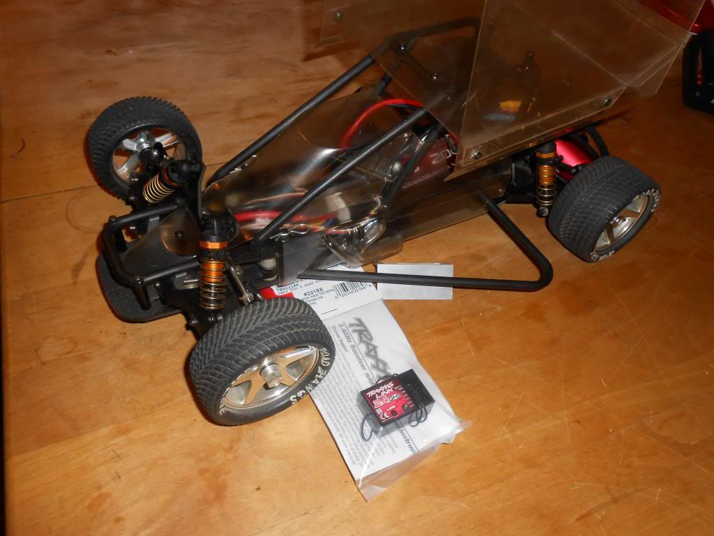

Here is the Nemesis. It's an outlaw sprint car and after trying the phone number for Team Cobra they're most likely out of business. I was originally thinking about a primarilly red paint scheme but I'm leaning toward a two tone green and something. I've been gathering up bits for it and it looks like a brushless 4 pole and a 3 cell LIPO should give it a bit of power. The steering had me baffled but I'll just use one of the servo mounts I already cut. I'm also leaning towards Hooters sponser decals just for fun.
I understand a lot more about this one now.
It's suspension parts are copys of Team Associates from the RC10 era so those are still easy to get and a good thing. They originally listed an option with the needed hardware available to use an AE gearbox. In truth it's not an option, without it there isn't a way to run it. I have all the documentation on this and 2 areas are glossed over. Mounting a steering servo to the provided linkage and putting in a 540 motor. There are no holes in the area to really mount a steering servo in the direction it needs to be and all picures I've found don't show the original setup but custom mounting.
To put a 540 into the mounting places they made you have to use a huge pinion and it puts the speed into an area that I won't even go. The mount is machined too low and puts the motor up against the lower arm unless your at the maximum from the spur.
For me this explains why so few of these exist and why it appears to be the only car they did. They did a few optional types but they all shared the issues I've found. and with them out of business finding the option kit is not very likely.
This is not a show stopper. I've already fit a custom servo mount for the steering and it utilizes the existing linkage. I pulled the diff and motor brackets to see if it could be modified to work and it could but it's really not worth the effort since it's a one of a kind sorta deal. I fit an old AE gearbox into it that has a ball diff and slipper. I need to make a pair of longer upper rear linkage rods and some wing stabilizers for it to be complete.
I washed the body panels and they all cleaned up just fine. I'll probably have fitment issues with the rear body piece and the back guard but that's nothing to keep it from running.
I did try the huge pinion just to see how it acted. It wasn't pretty and the tires aren't bonded but need to be. :o

I managed to keep the stock gearbox and tried it out with a very strong motor and ESC combo the other day and it's actually pretty impressive. I don't see it as a regular runner but it's a challenging car to get right and I'm always looking for a project that takes some effort.
I'll post some pictures once it gets to be something worth looking at.

To watch a car go in circles doesn't do anything for me either and nascar is a four letter word around here. I had a good friend that had his own company building custom pieces for oval track and the cars themselves are interesting to me. I have to add that driving one like this is a lot of fun, it's like drifting on steroids. Imagine a 350 V8 direct driven to the rear end in a car with no weight. You have a steering wheel, throttle and kill switch for control. I'm not sure I could keep it in the walmart parking lot, on target on a 1/4 mile oval would be next to impossible at any speed.
I put the 2800 KV four pole into it knowing it had too much power, then geared it on the high side as well. It's fun using the sideways wing to keep it on the ground during a semi controlled power slide drifting corner. Cornering like that is actually pretty easy, it's coming out of it in the direction you want that gets hard. Driving it is way different than watching it. The ESC and motor chosen are waterproof so I'm sure it will see some slick condition use at some point too.
