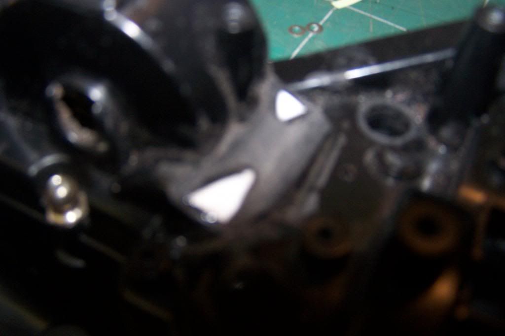

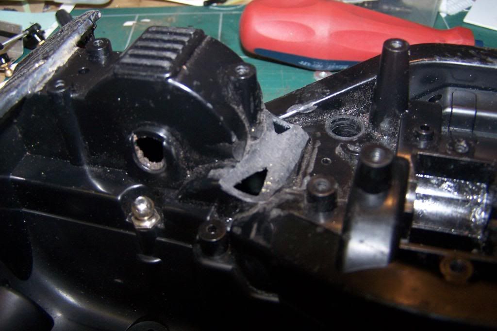

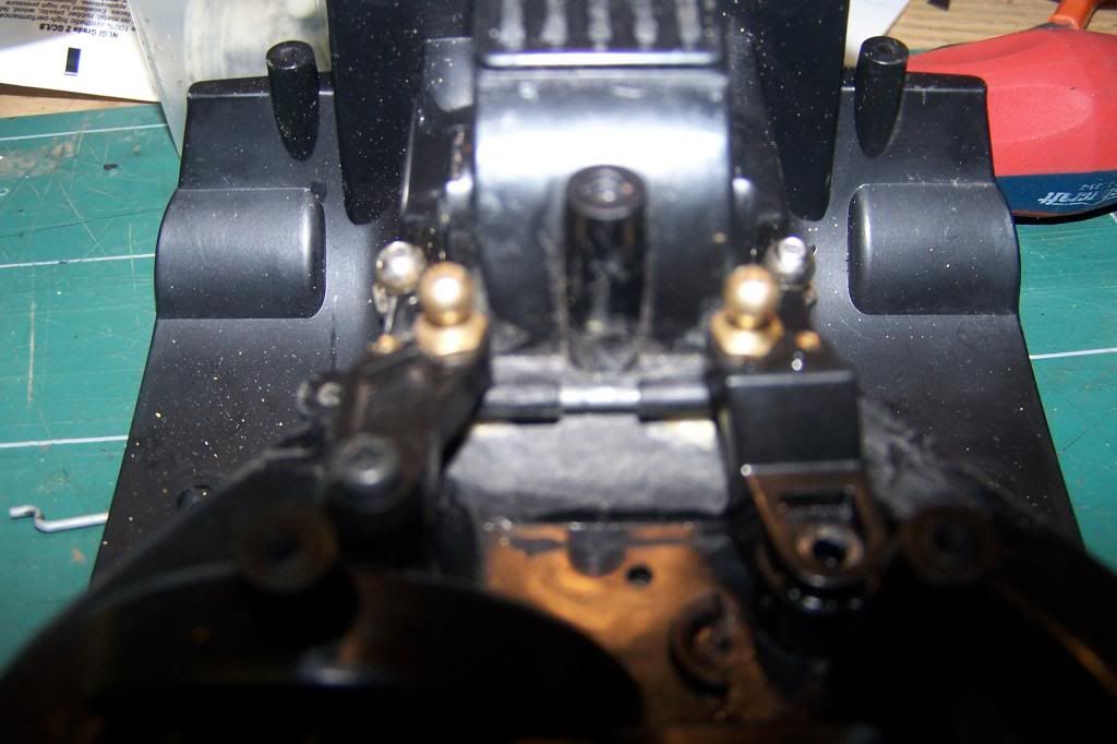

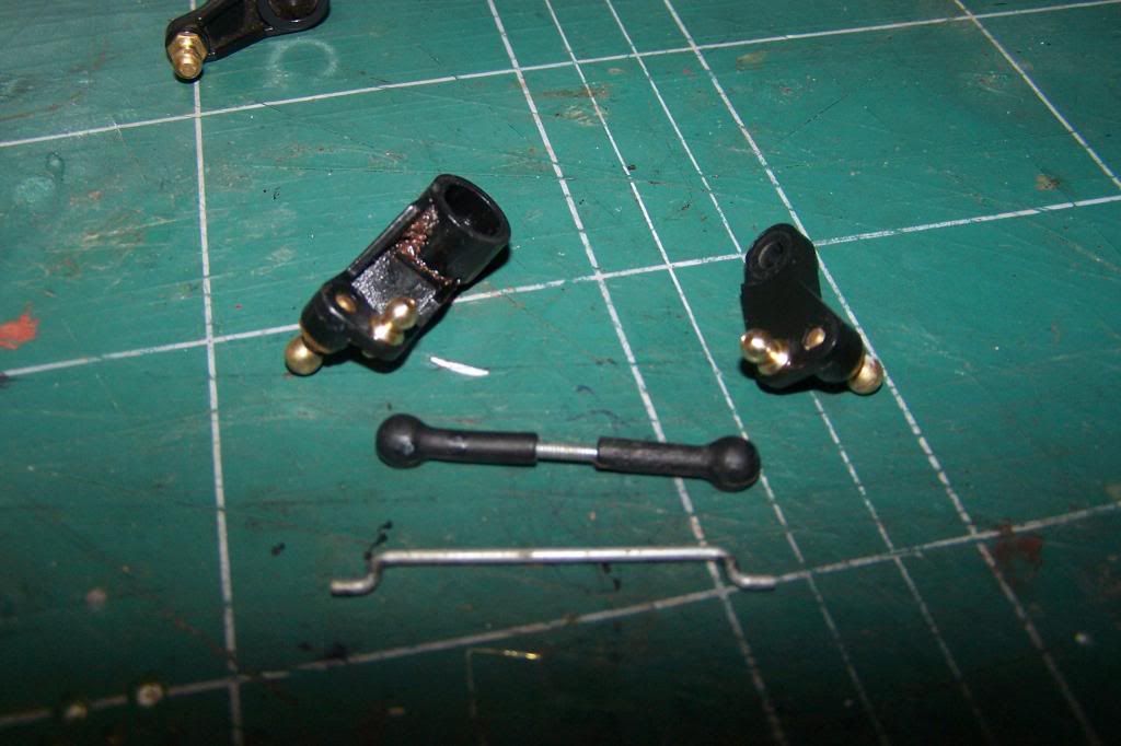

While I had my Pajero apart for a good cleaning and to upgrade the stock bushings to some cheap ebay bearings. I decided to try my hand at tightening up the steeing. Rather than buying a proper aftermarket kit I used what i had in the parts bin. I had seen pictures of someting similar in the past but can't remember where it was. Anyhow I had some spare losi parts from my micro crawler project. I simply replaced the z-bent wire link with ball ends. I did have to use the dremel to increase the clearance for the new ends and add some thin styrene to the inside of the gearbox, this has to be very thin gauge to allow clearance for the bevel gear. No cost and much tighter steering.
