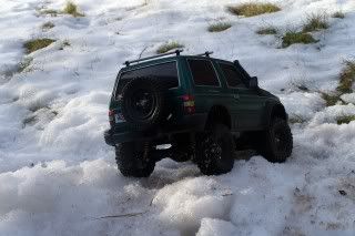

I have a 45T in mine and a set of losi 1.9 claws on the stock rims works great and still has a little wheel speed. Only locked in the rear.100_9369.jpg
