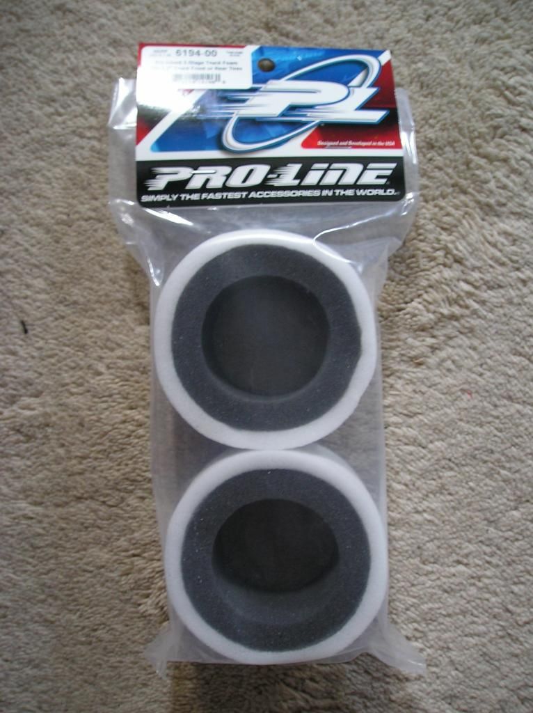

Any idea where I can buy those foam inserts for the tyres ? Cheers
just about any decent rc store should have the foams mate - give Modelsport or Fusion a look :D - if you need help just ask for Joanne
Any idea if these are suitable ? All I can find online. Cheers
http://www.modelspor...-products/37762
http://www.modelspor...-products/31994
The lunch box uses a odd 2.1 wheel and i dont know of a insert that is actually made to fit that size rim . i would think that 2.2 size is ' near enough' to make no differance . Either of those should be fine. All your aiming for is that the tire is less spongy so the suspension can actually work instead of most of the 'bounce' being taken by the tire leading to eventually the tire either coming off the rim or spliting its side wall . As said your run times will improve too as the tire will not be ' dragging' and stay far more round .
Thanks for the info on the foam inserts. Placed an order with Modelsport for them this morning.

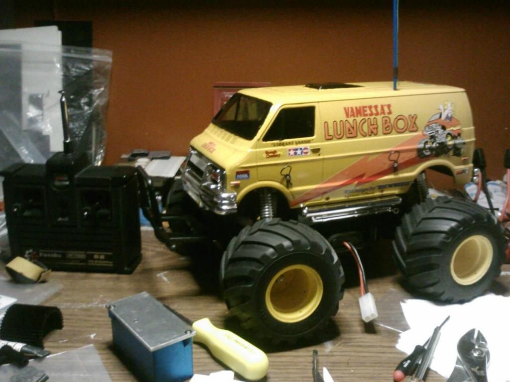

here is mine I just got running w/ a vintage Futaba radio - this thing is so fun haha - I plan to do the 5th shock for sure as well as the tire foams

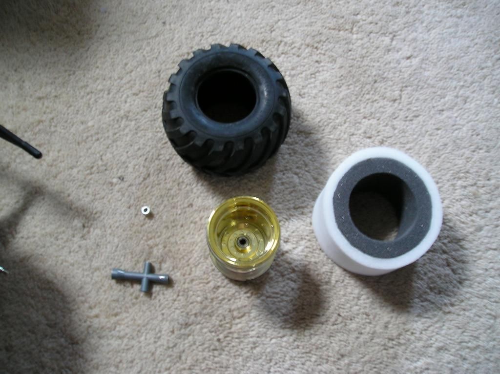

Got the wheels on earlier, tyres with foam inserts.
