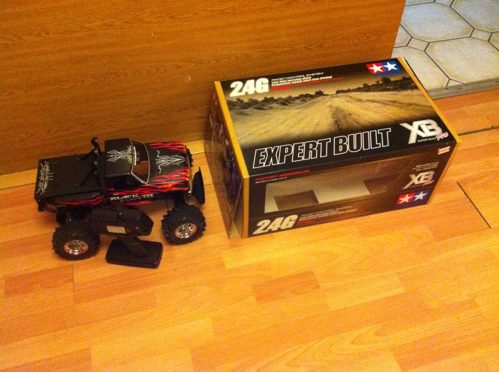

Well, just bought one of the MZ bargains, the BF3 XB Pro..
Its a great truck :) Love it!!
First on the to do list, bearings!
Should I keep the TEU105BK? If so whats a good motor to run with it? Don't want a stupid fast truck, just something fun!!
