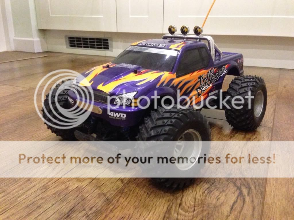

The esc modification is nice and easy and works well I did this to mine. Should be plenty fast I run mine on silver cans 20t pinions and 8.4v and its pretty fast so with rzs will go very well indeed plus they can be rebuilt.
Hi Steve
Nice truck, Saw it on ebay and it looked mint.

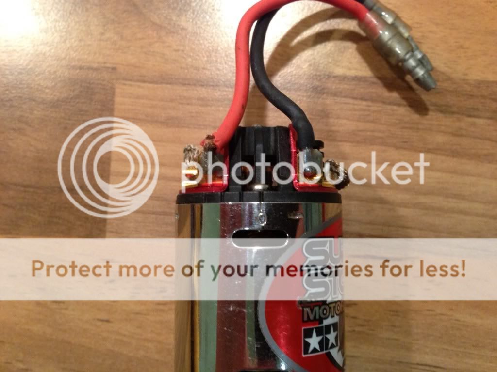

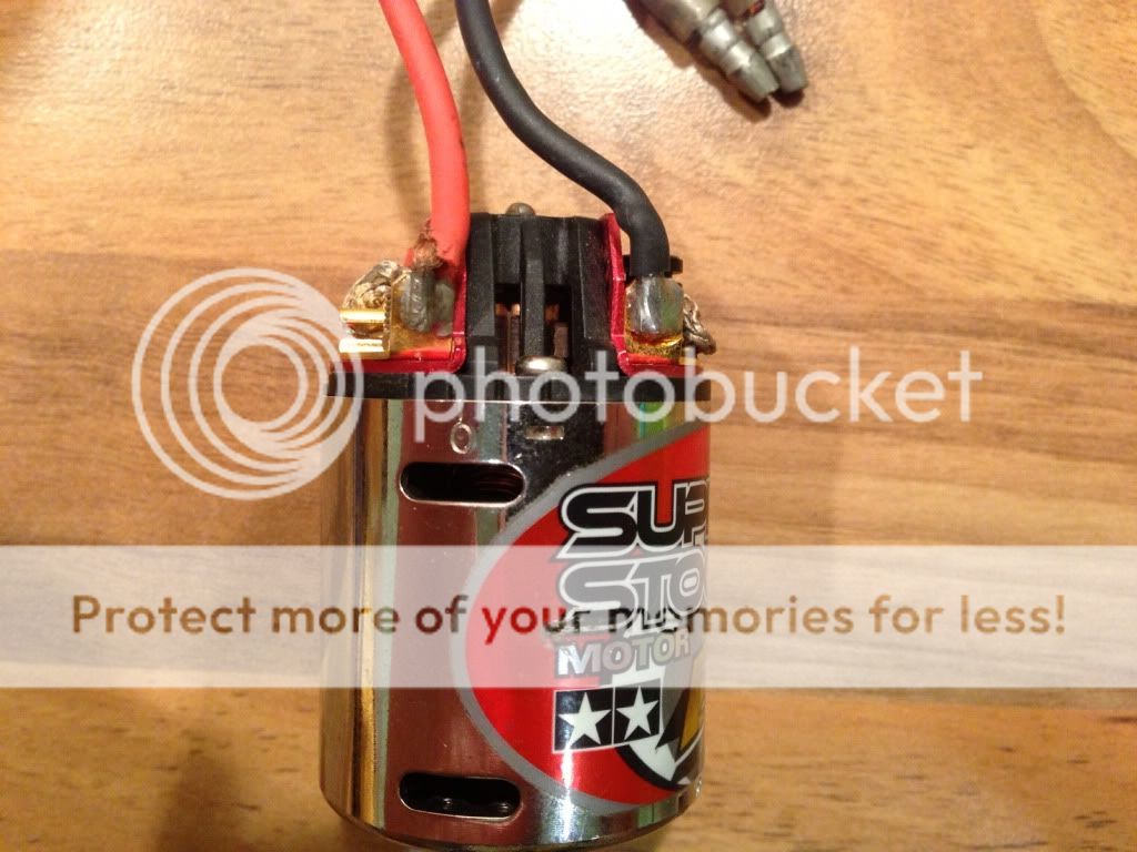

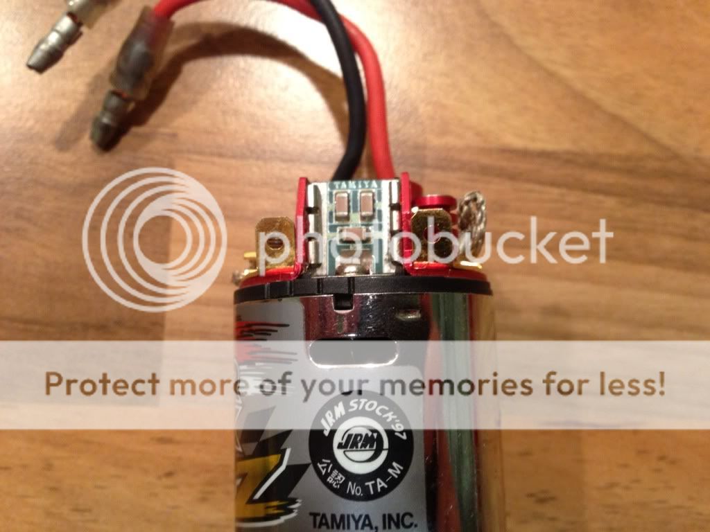

I also received the first of the two RZ motors today and I've already retimed it to 0 degrees forward rotation, which was surprisingly easy to do. The other one will be retimed to 0 degrees reverse rotation (by rotating the endbell 180 degrees) to keep the wiring polarity the same on both motors, if only for neatness.
Some pics:
Before:
After:

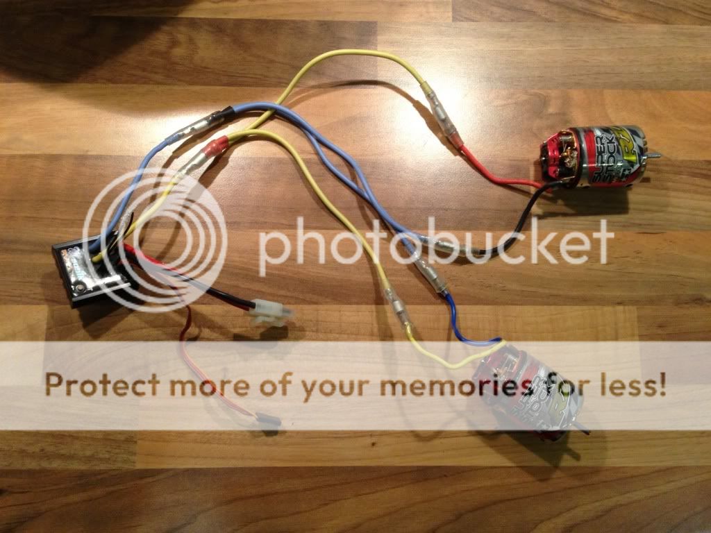

Got the other motor, ESC, wiring adapters and bullet connectors today so have managed to sort out 90% of the upgrade, both motors have now been retimed to 0 and the endbell spun 180 on one to reverse the rotation. Just need to wire in an on/off switch and mount the ESC fan when it arrives, oh and wait for the steel 18T pinions to come also. Then it'll be show time!

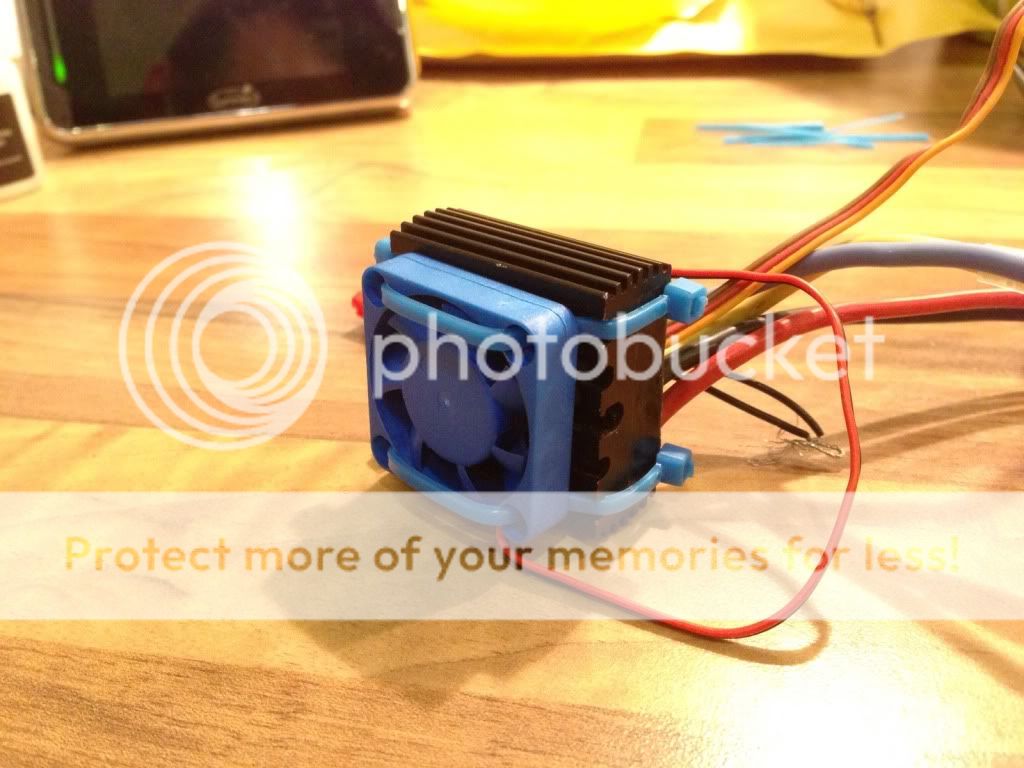

In the mean time the ESC fan arrived today so I've just mounted it to the back of the ESC which luckily already has cooling fins built in so that was one less thing to have to sort out. Pics:
