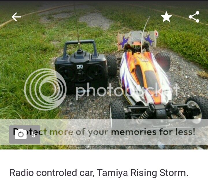

Sorry to dig up an old thread, but I'm having a bit of a dilemma.
I see I can get a TT02B MS for £118 delivered, which is tempting.
Equally tempting is a DF02 for sale locally for just £40, RTR.
Is the TT02B leaps and bounds ahead of the DF02? Or is it just a natural evolution of the same product?
I'm only going to be using it for light bashing, and the DF02 has got the stronger drivetrain (bevel gears) out of the box. The front suspension mount used to be the weak point on a DF02 - how is this addressed? Are there still aftermarket parts available?
It's hugely tempting to buy a fixer-upper and reap the reward from getting it into top shape by cleaning it and rebuilding it - but it's also alluring to build something new right from the box.
Can I get some opinions?
I know the MS has lots of hop ups as standard, but it doesn't have fancy aluminium shocks, just some nice additions. Is it worth 3x as much as a used DF02?!...
