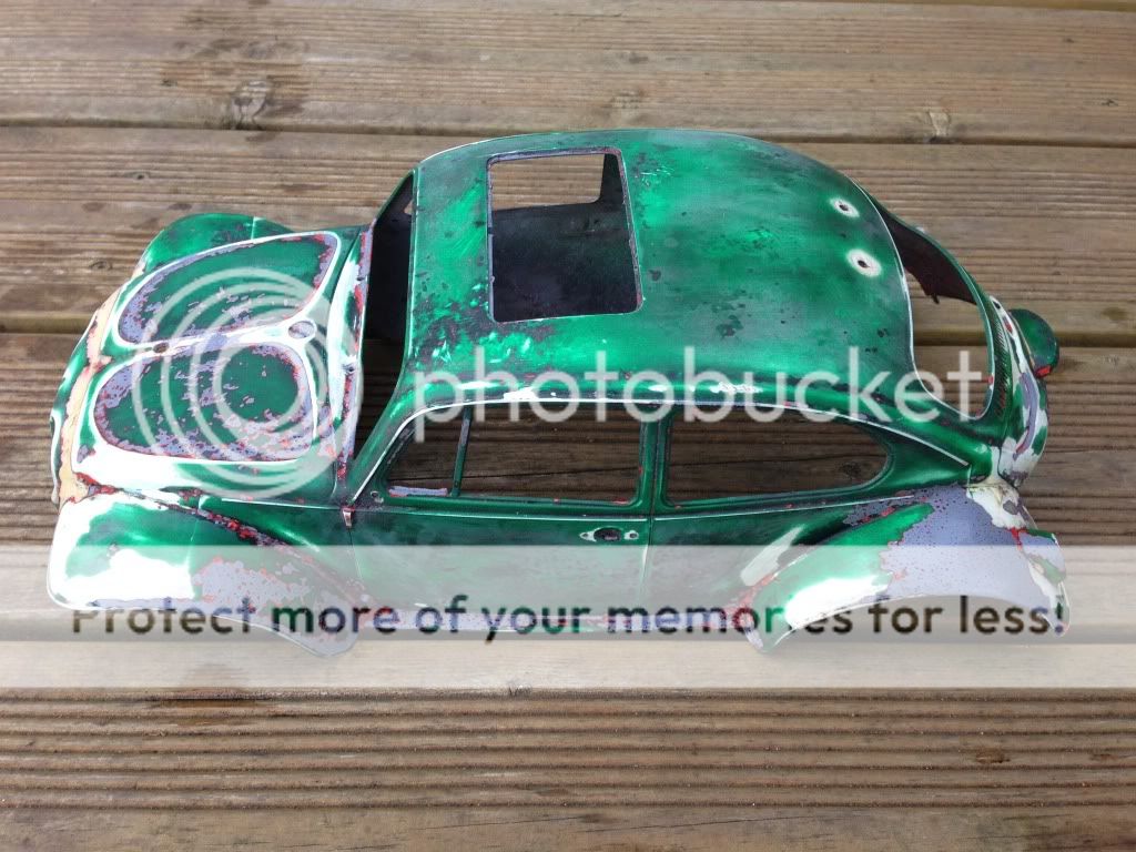

So I picked this up a couple of months ago and have just been looking at it while I plucked up the courage to make a start (it's my first ever vintage resto).
As far as I can see it has the usual Scorcher problems:
Missing sunroof
Missing wipers
Missing/broken lights
Missing mirrors
Missing licence plates
Missing exhaust
Missing driver
Missing door handles
Broken/repaired front fender
Broken rear cage
Worn front ball plates
Badly repaired front arm grub screw
Cracked front nose cone
All minor/trivial things really which are easily repaired/replaced. On a positive note the chassis itself is in great condition with nothing broken at all, plus it even has a complete radio box with all electrics inside and a full compliment of working cam locks! The gearbox turns smoothly and all of the wheels and tyres are in pretty good nick with just the lettering in need of painting.
Anyway, before I start with the resto progress here's how it looked before I started:

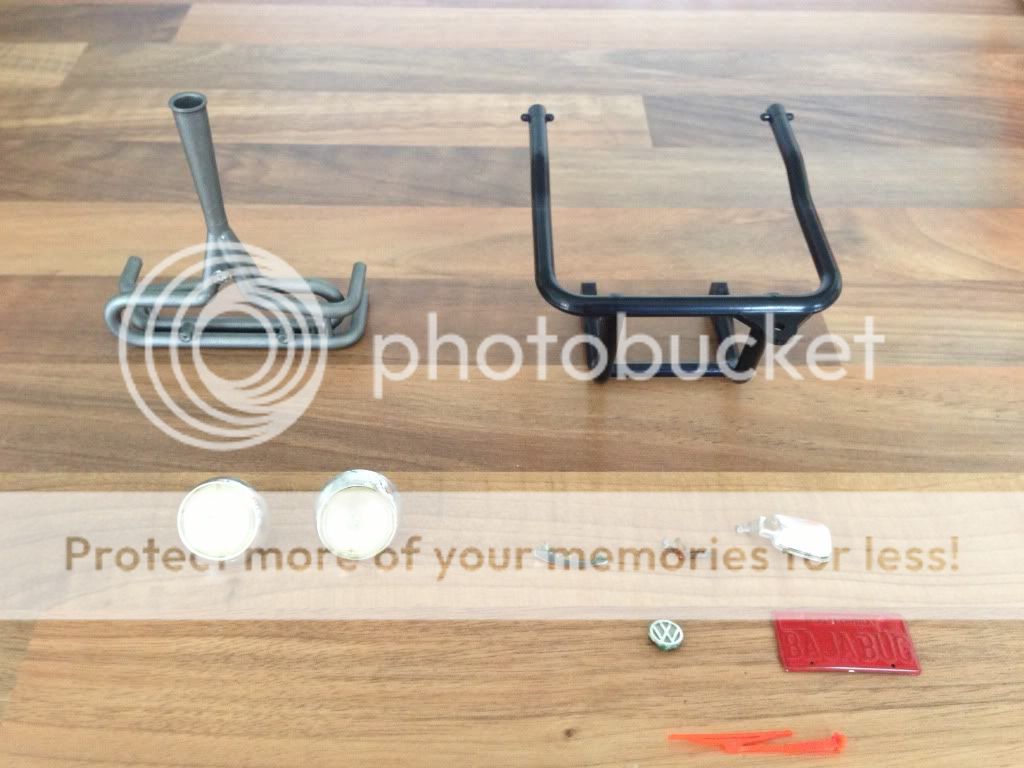

So I've acquired some bits already including a new rear cage, a pair of headlights and a ready painted stinger exhaust. The Scorcher also came with a small bag of goodies but frustratingly only 1 of each item so I'm going to have to keep my eyes peeled for these.

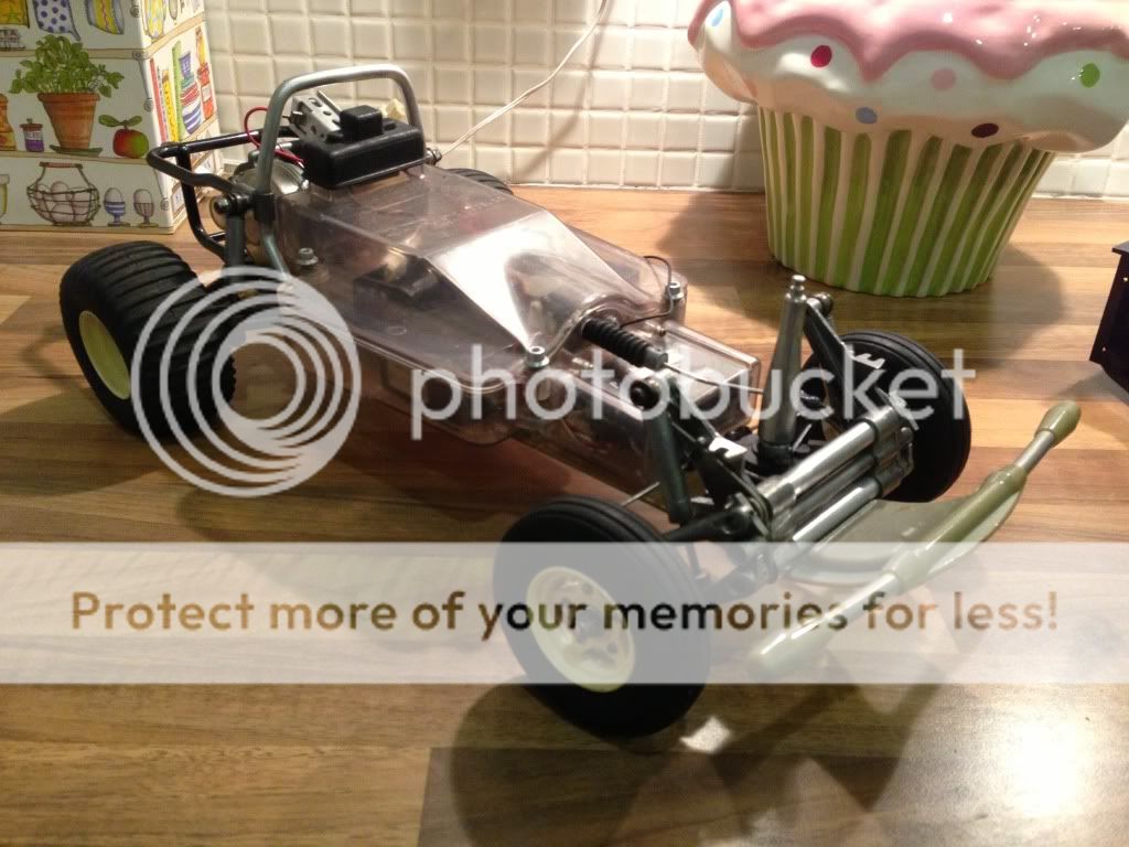

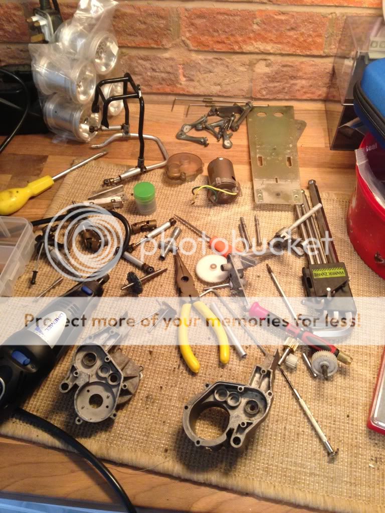

Chassis in bits:

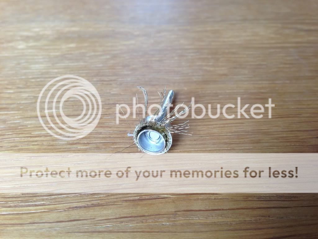

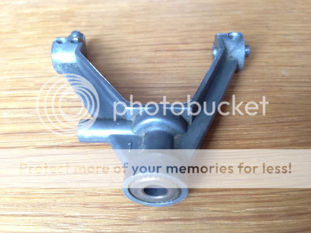

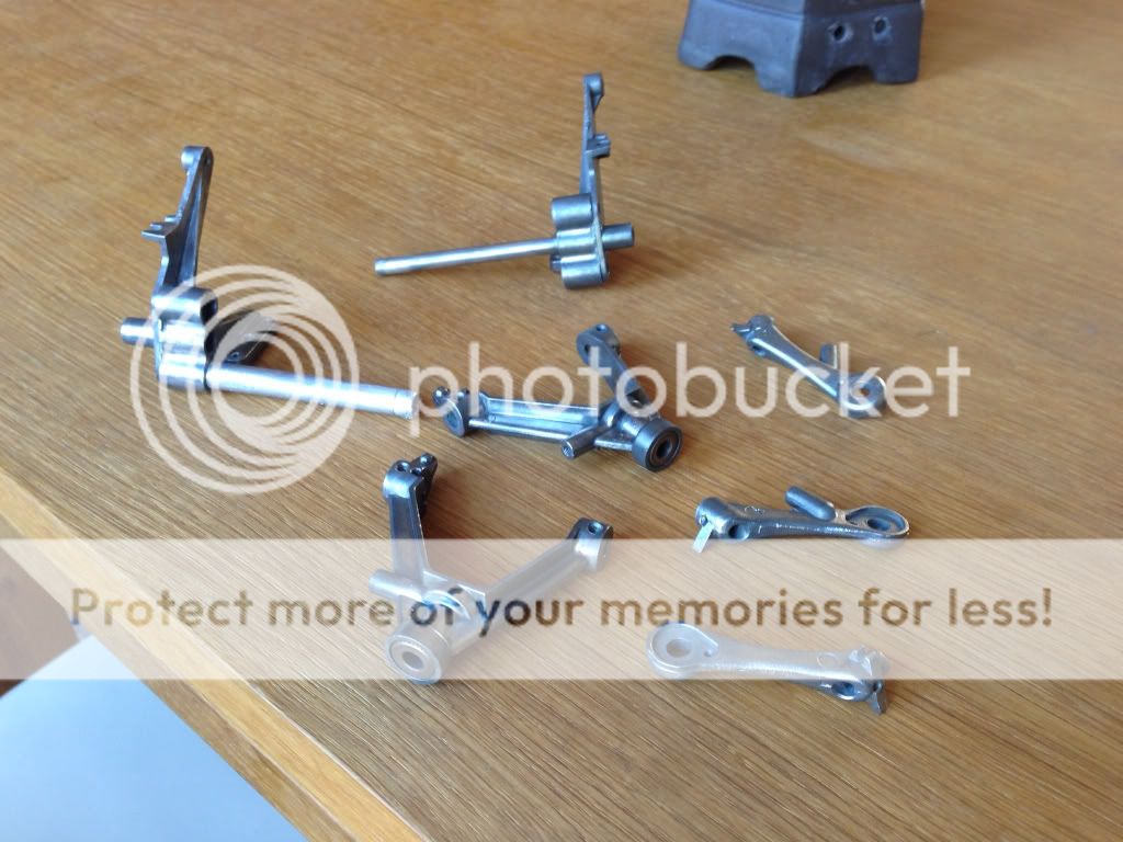

Started cleaning up the alloy pieces with a brass wire wheel in a Dremel but I've gone through 2 already and I'm not even halfway through the parts. Have ordered some steel wire wheels instead as these should last longer and probably do a better job.
Comparison of before and after:
Before:
After:
Brass ones don't last very long!:

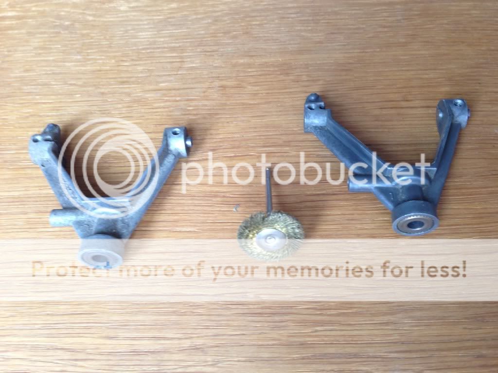

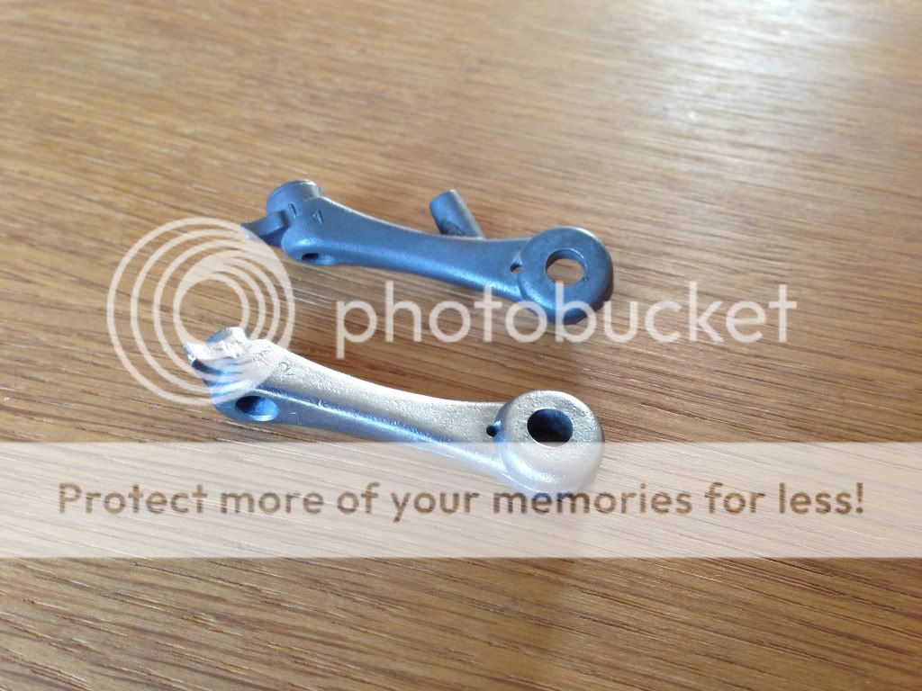

Got some steel wire wheels & brushes for my Dremel today and man what a difference to the brass wheels!
Top arm is with the brass, bottom arm is with steel:
Shiny bits:
It's a bit time consuming but it'll be worth it in the end I'm sure!
OK, so the chassis is back together now:

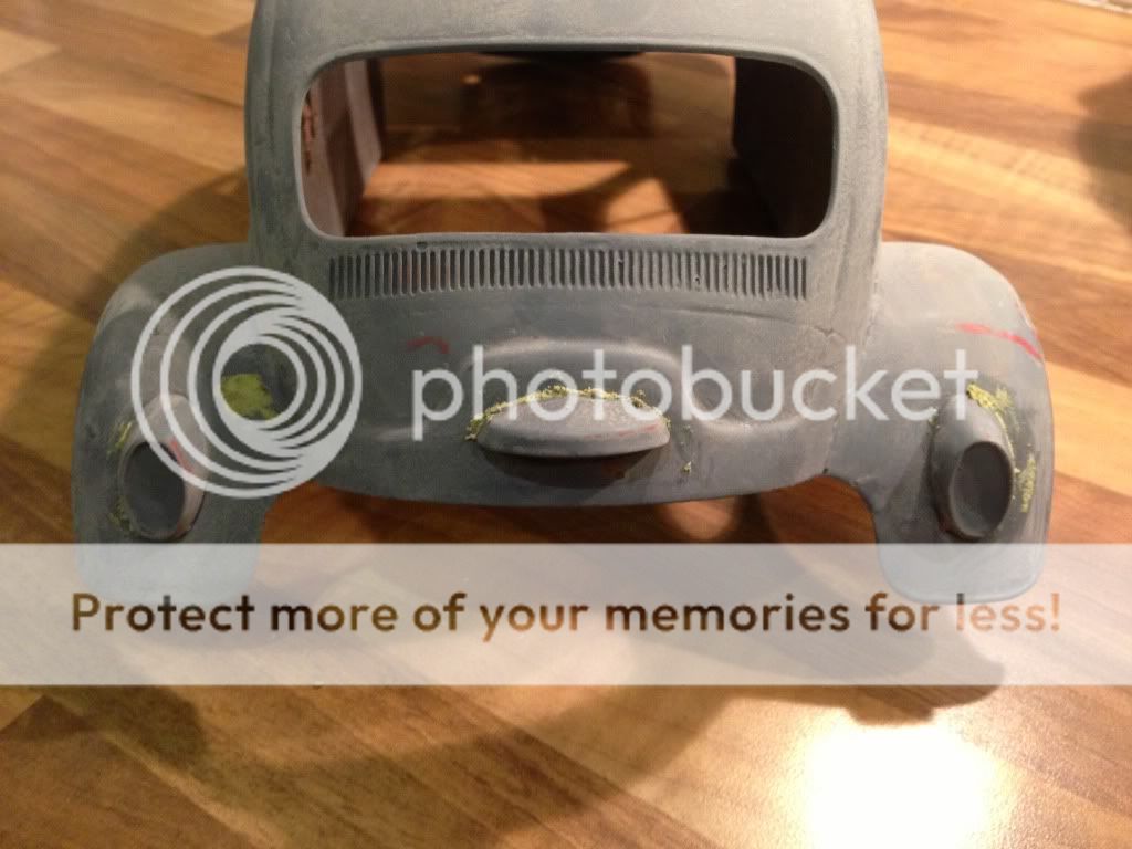

On to the original body. Started off by rubbing it all back to see if there were any hidden suprises. All looked OK apart from the odd imperfection so I then preceded to filling in the gaps with Milliput. Once this has set I'll sand it all back and see how it is:
Looking good. Are you not going to strip the shell back to plastic to bring all the details out? The grey primer looks very thick. Good advice on the Drexel wire wheels.
What type of milliput are you using? Standard yellow grey? As I have a few projects that need some work with putty.
I've rubbed the primer back a fair bit since the first pics but I didn't want to go too mad as there's a few splits in the body which the primer is helping to conceal. I am going to rub it back some more before paint to get some more detail exposed. Yes I'm using standard Milliput, never used it before so am learning as I go!

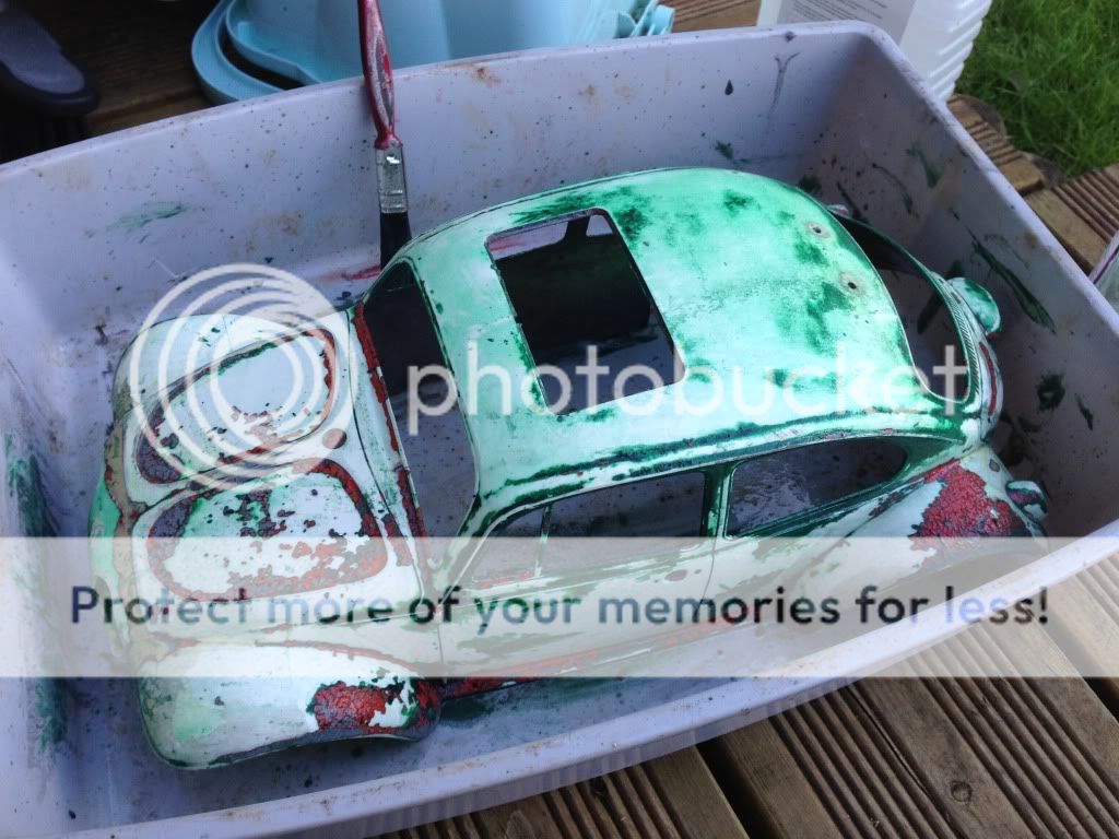

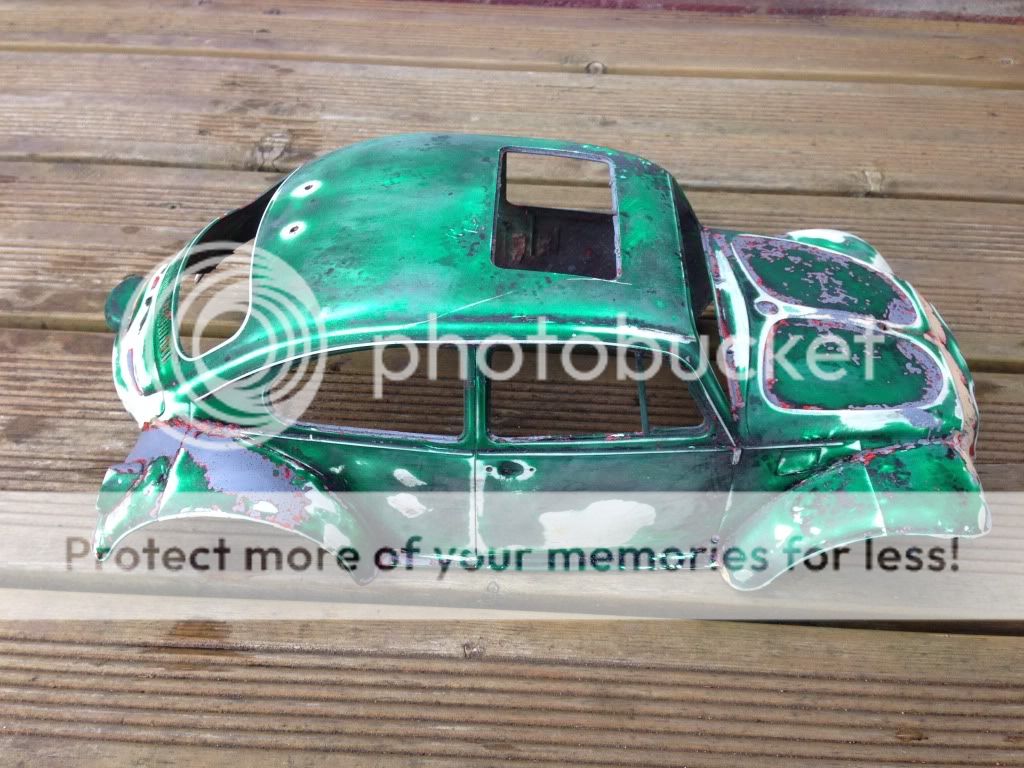

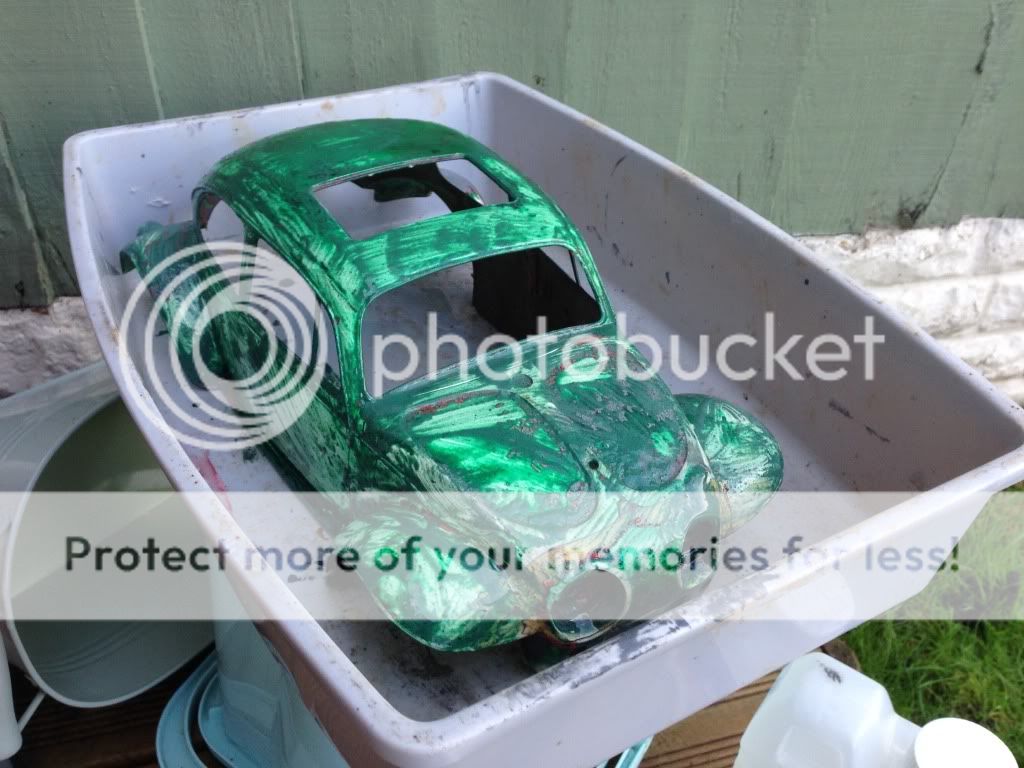

Haven't touched this is in a while due to being sidetracked with other projects. I'm kinda glad in a way though as now I've come back to it, I feel it would be wrong to not do it properly so I'm now in the process of stripping the paint back to bare plastic. I'm using brake fluid as it's kinder to the plastic but it ain't half taking a while. This is the progress after about 5 days of brushing with brake fluid and then gentle scrubbing each night:
So after weeks of brake fluid I seemed to have hit a brick wall as it just wasn't lifting any more paint and this is as far as I had got:

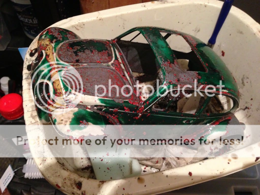

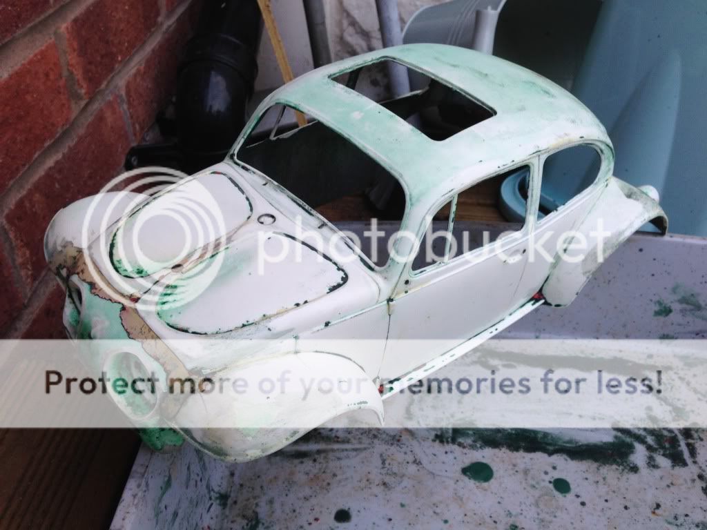

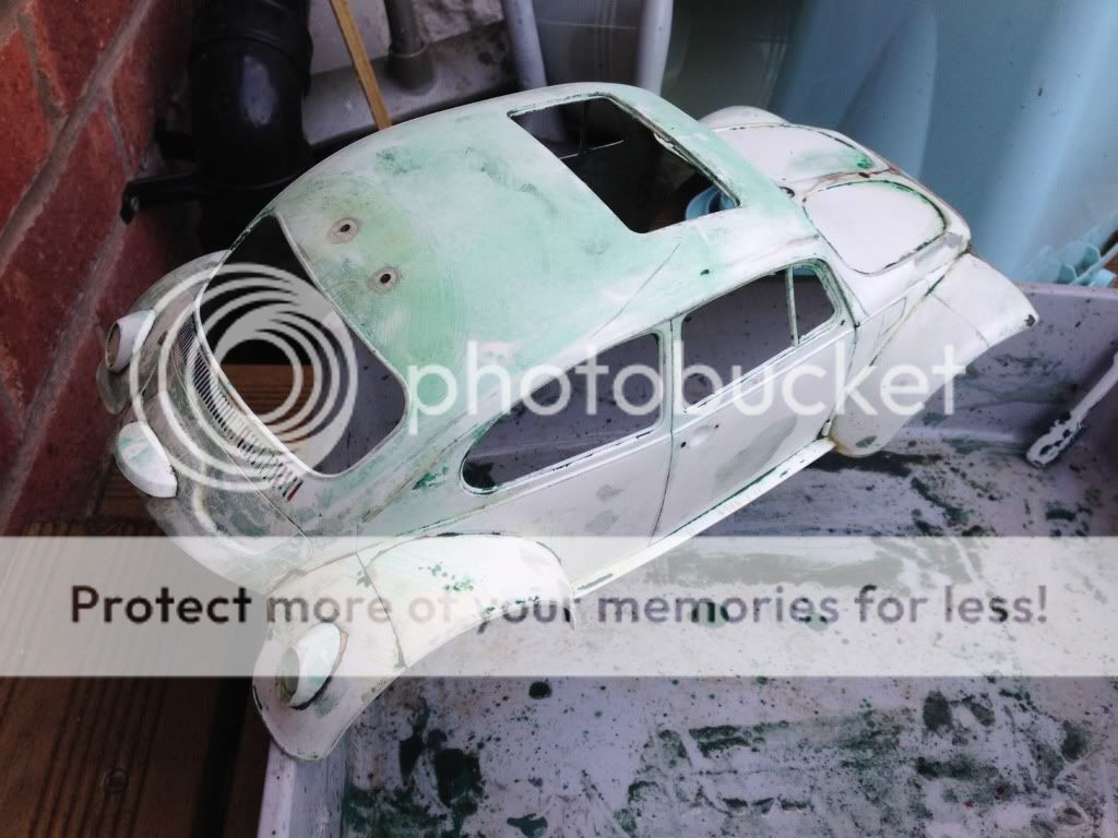

I then decided to break out the big guns and set about with Desolvit graffiti remover. Now at this point I was nervous as it's an old shell but I read and re-read Johnny Retro from Tamiyabase' excellent guide here: http://www.tamiyabase.com/index.php?option=com_content&view=article&id=145:paint-stripping&catid=54&Itemid=554 and applied the Desolvit:
Another application, a little bit of elbow grease with a toothbrush and a rinse with the garden hose yielded this:
A couple more goes and an hour later I ended up with this excellent result:
The last tiny bits of paint left in nooks and crannies I'll just scrape out with an exacto knife then on to sanding it nice and smooth. I'm glad I've gone to these lengths now as I know it'll be worth it in the end.

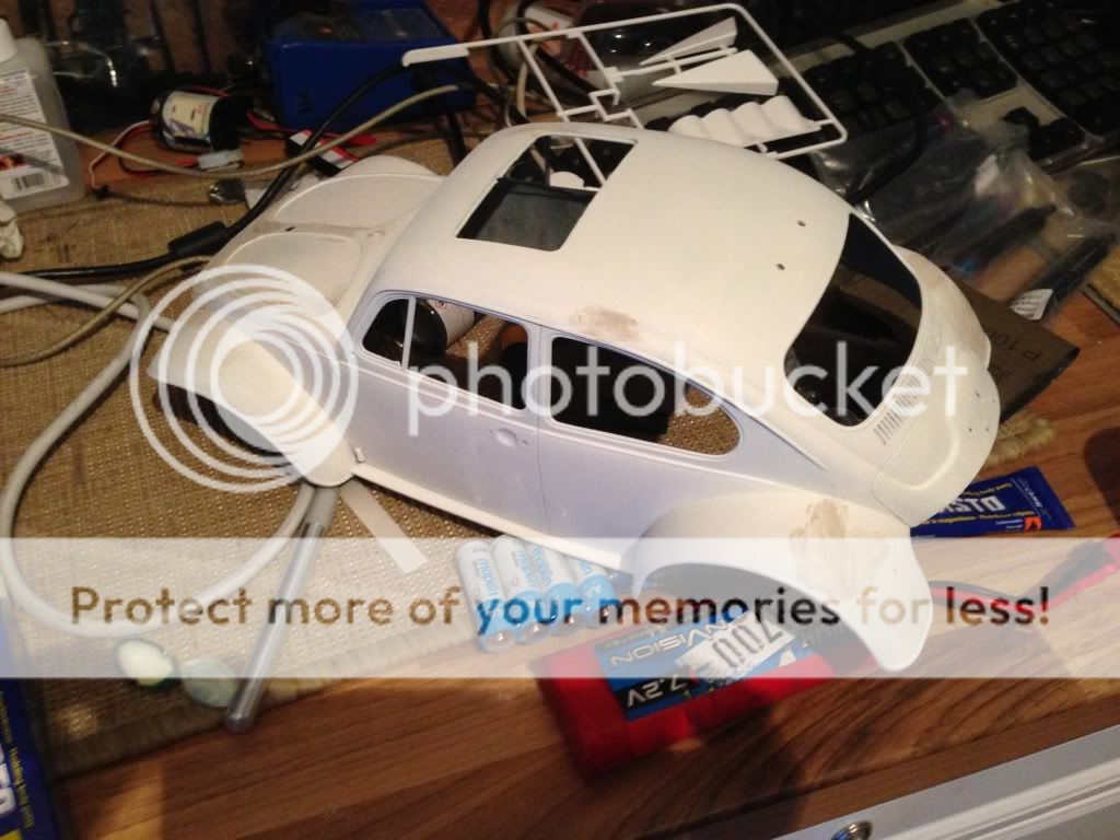

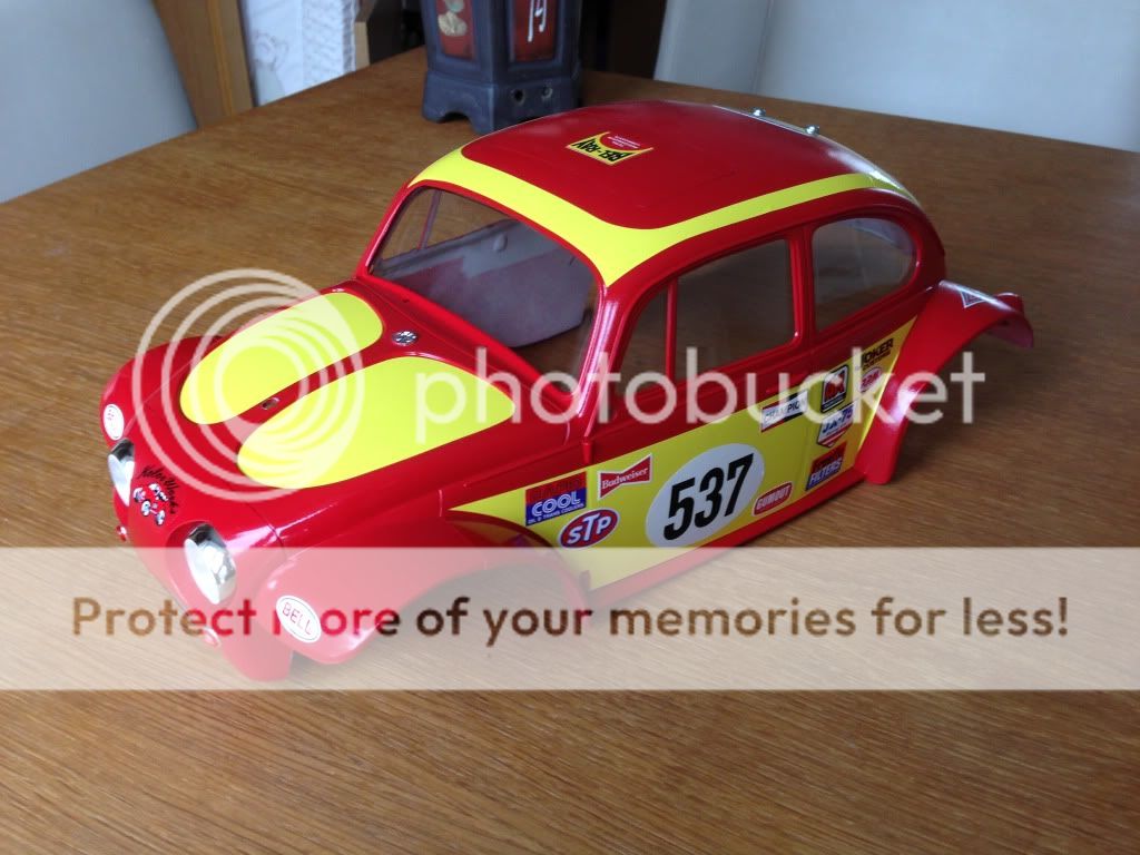

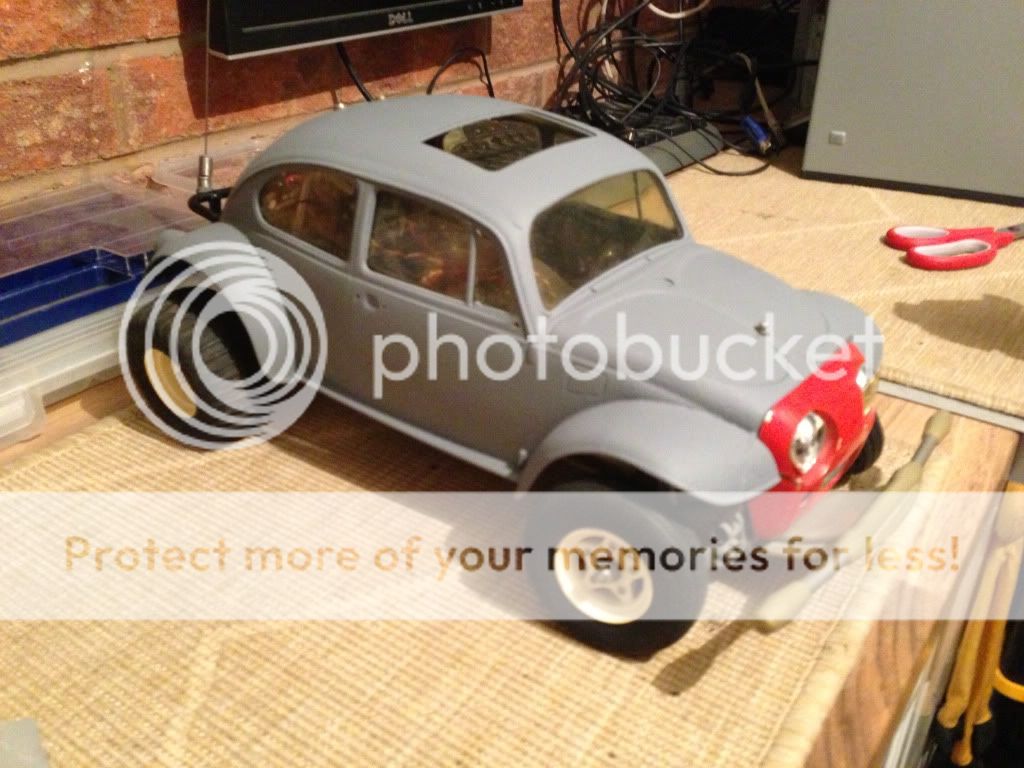

Thanks Chris, I did actually buy one of those when I started this project to use as a runner body and it's almost finished:

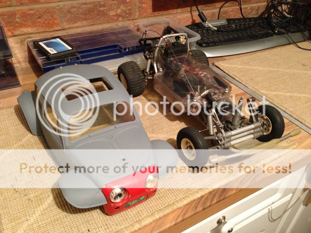

My plans have changed now though and the vintage scorcher is going to be a shelf queen as the shell and chassis are far too delicate. The re-re body is going to now be used on a runner chassis that I'll be building with RC Channel and Radshape goodies but I need to clear a few projects first lol.

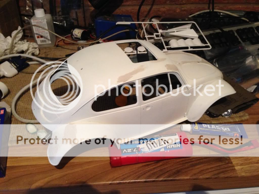

Shell sanded and keyed ready for primer:
First coat of primer applied to show up the imperfections:

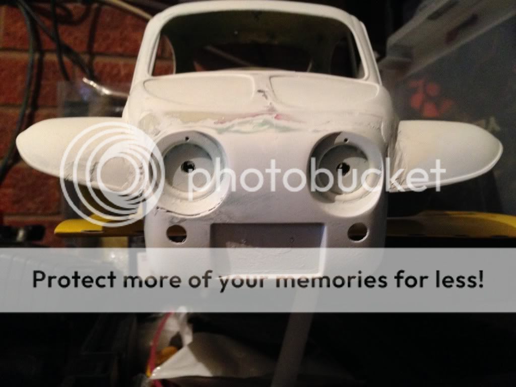

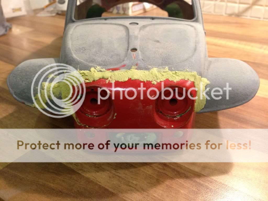

Front end needs a lot of sanding and work:
Sanded and more filler added:
