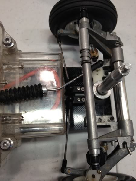

Anyway, here's the servo and rod position.
When I saw the odd steering linkage I figured that a high torque servo would be best; now that I see that the servo is attached with tape only, I'm second guessing my choice.

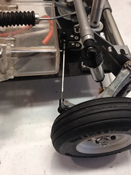

If you turn the steering rod 90 degrees so that the "elbow" bend is in the same plane as the chassis , ie horizontal rather than pointing up I think the problem will disappear.
I agree with Fishlord, the instructions aren't very clear and do make it look like you fit the steering rod like you have, but you don't.
However if you change the angle a little, as suggested above, you will find the rod passes straight through the middle of the hole and shouldn't foul at all.
Looking from the side the steering rod should be almost parrallel to the chassis (not going up as your is) and looking from above the angle should be quite a bit less than you have.
Do not be tempted to bend the rod at all, it will fit correctly if you get the angle right.

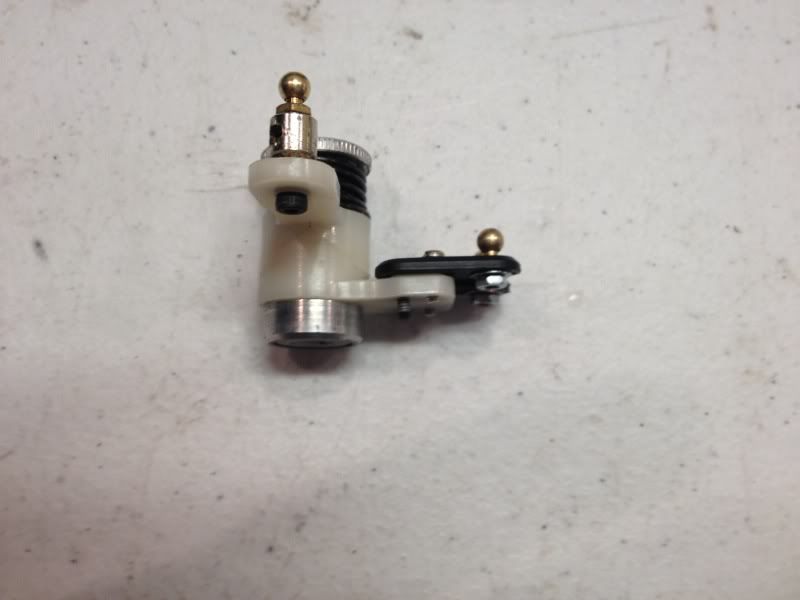

I've played around with the steering on my SRB a lot. First, tip, do not tighten the grub screw on the accordion rubber seal, it will limit the amount your servo can move the servo saver.
Next, this is a mod that I did on the hop up servo saver but can easily be done on stock one.. I'm reposting a post from elsewhere

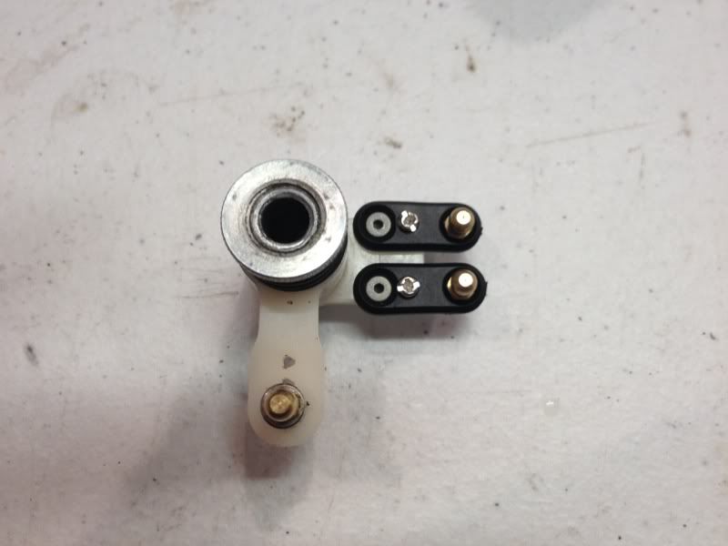

Today I decided to work on the Sand Scorcher's steering. As you all know the steering throw / angle is not very good, mostly because the steering servo sits inside the mechanism box. Ive seen a mod where bell crank is bypassed, but I wanted to preserve the original layout.
A while back I had my friend machine me a new body post so that I could use the Super Champ Hop Up servo saver. Unfortunately this hop up doesn't address / fix the steering angle.
I also noticed that the tie rod angle was too extreme. When the bell crank is turned, the tie rod doesn't effectively turn the wheel. So I decided to see what would happen if I made two little extensions to move the tie rods back. This is how I went about it:
The are plastic washer plates I had in my tool box, used to fix spoilers on lexan bodies.
The result... my SS can now make super tight turns! :D
Im going to have my friend machine me a single piece of aluminium to replace those plastic pieces.
